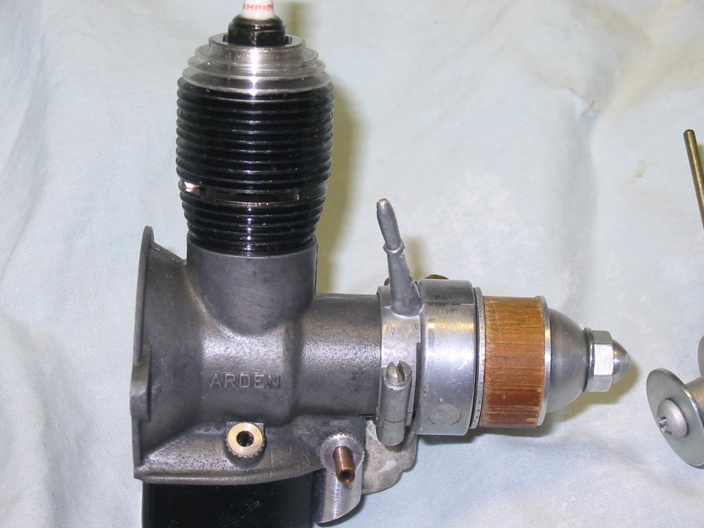

A friend (M. Myers) gave me two spark ignition engines.
He is converting to electric motors for flying and asked me "if" I wanted them?
I said sure. I never tried to run any spark engines but it always thought they were cool?
Well what he sent me was two modified engines that he got from W. Schmidt ( in Kanas).

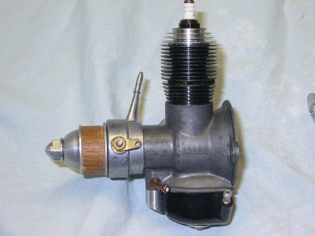

One is an Arden .099 and the other is a McCoy .098 -- modified for spark ignition.

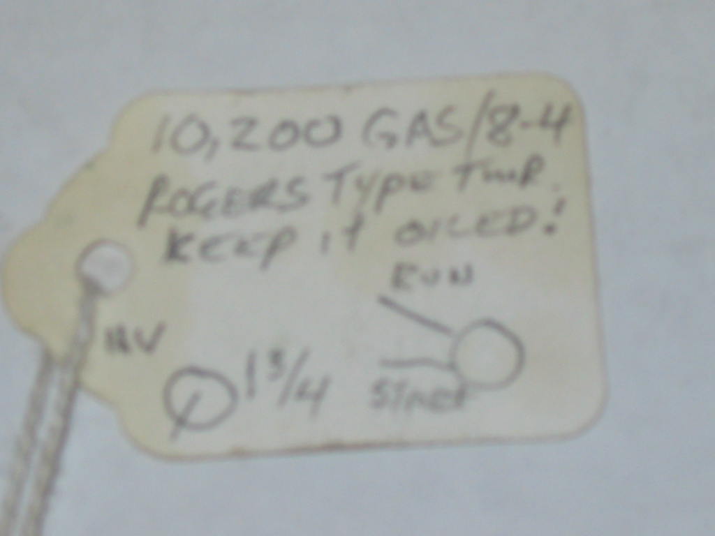

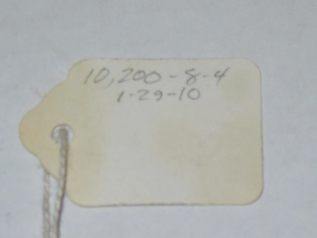

The McCoy has a tag on it that has some instructions.
One side give the max RPM at 10,200 on an 8x4 prop --- tested January-29-2010
On the other side of the tag it has RPM (fuel - Gas), Rogers type twr(tmr)?
Keep it oiled!
Needle valve at 1-3/4 out and start and run position of the contact on the engine.

Photos of just the McCoy .098 engine:
