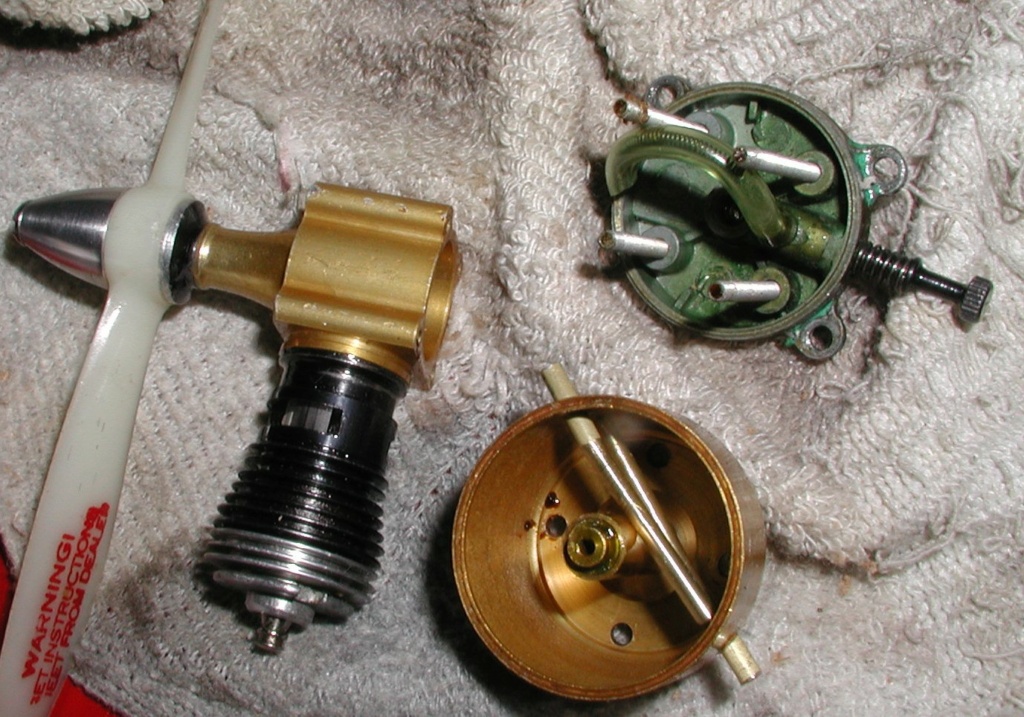

Ran three, 25% Cox fuel, rainy cloudy day.
First one, no problems, filled the tank, set the needle to about four turns and lit the fire. Ran the whole tank out. Nice even run. Forgot the Glo-Bee.
Second one, I noticed the note I had written on it's display stand that it had a "W" glow head. Filled the tank and initially got erratic readings on the tach. finally settled down to about 15K+. Removed the W head and replaced it with a standard head. Two for two.
Third one, filled the tank and would only run on the prime. Like over and over. Not fun. Removed the tank to check the reed and found the tank EMPTY. WHAT! It's happened before, one or both of the fill/vent tube blocked. Ran fine music wire down the vent nearest the reed and could see it come out the inside end. Tried the other one and nothing. Pulled it out and it was covered with fine black powdery material. Remoil, compressed air finally cleaned it out. Checked both tubes again before I put it back together.
I was using surgical tubing to fill the tank and it just slopped out without going into the tank and I didn't notice. Later, I added smaller diameter tubing.
Eventually they will go on big brother to Rene's pontoon plane. All getting yellow Cox safety tip props.

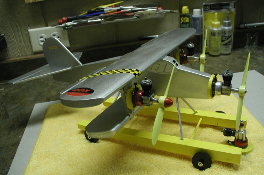

What's that lurking in the background of your last picture? Looks like my Big Brother plane. And your trapezoid, super interesting. Love the tail. Your design? We use the same clamps for the same things. Valuable for setting up the pontoons on those planes. Most difficult without those clamps. Three angles and you must get them right.

NEW222 wrote:I'm really liking the update. While I am personally a fan of the smaller .020 powered version, I cannot really blame you for not sending it around the circle as I would also probably be in the same predicament. However, I am still sitting patiently waiting for the bigger brother / Golden Bee powered version to take to the pavement, and hopefully a short hop in the air too!
Yeah, I would have to drill holes in the body for a tether and secure it on both sides with wheel collars. Wouldn't mind on big brother.
Ordered enough balsa from SIG this morning to do a flyable version.
1/8" X 36" BALSA SHEETS IN VARIOUS WIDTHS - 1/8" X 4" X 36" $4.66 USD 1 $4.66 USD - Fuselage sides
BALSA TAPERED TRAILING EDGE - 1/8" X 1/2" X 36" TRAILING EDGE $1.40 USD 1 $1.40 USD - Wing extensions
BALSA LEADING EDGE - 1/2" X 3/8" X 36 LEADING EDGE $2.83 USD 1 $2.83 USD - Fuselage side separators
BALSA AIRFOIL SHAPED SHEETS - 1/4" X 4' X 36" AIRFOIL $6.87 USD 1 $6.87 USD - Top wing
BALSA AIRFOIL SHAPED SHEETS - 1/4" X 3" X 36" AIRFOIL $5.59 - Bottom wing
Got enough balsa on hand to do the tail sections.

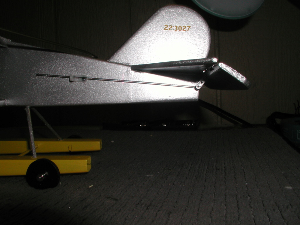

Might yet tether the 0.20, gas up the lead engine and see what it would do. I'm thinking that it won't even move. Big brother with just one GB turning....no problem.
CG on this non-flyer is about at the apogee. It would be located low under the elevator control and just behind the engine. Coat hanger perfect for this.

I am fairly confident that 2 golden bees can make a brick fly..I caution you to add a elevator control so as not to lift off and immediately inside loop into your beautiful asphalt

That thing will more than likely leave the ground. How much does it weigh?

Elevator control has three fixed positions, neutral, up, and down. Control rod (L shaped end) slips into three individual holes drilled into the fuselage. Tell-tail photo shows gel CA drip that I did not notice at the time. Sanded it down to unnoticed but photos pick up everything. Big Brother will have the same arraingment. Thinking full down first run to keep the nose down, neutral, then up.
Weight is a closely guarded secret. I have weighed it and have photos. I have been thinking ..................... contest. It's in my head but i will have to run it by Jacob first.
