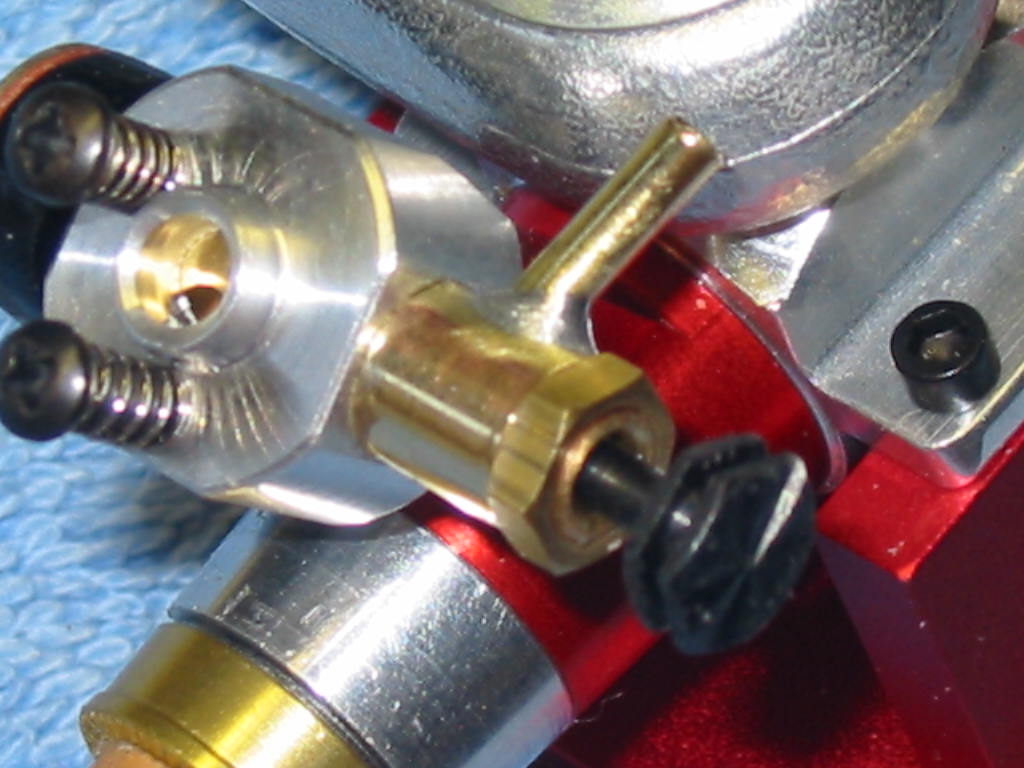

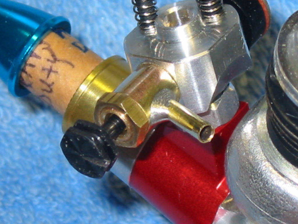

Now for the one problem with the carb that I have had and that is the fuel nipple.
Over time the nipple gets brittle and breaks off.
But I have heard that Burnie (Cox Int.) is coming out with a replacement fuel nipple?
See the photos of the problem and my fix for it.
