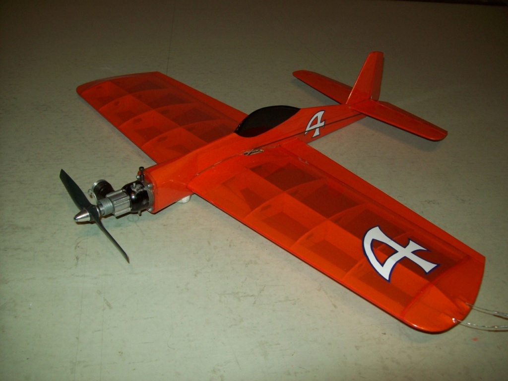

After building the Mustang, I felt like I needed to have all three from this series in the hangar. The Cosmic Wind & Hurricane were easier since I have original kits to copy parts from.
I built the Cosmic Wind first. I omitted the gear on this one also. The wing mounted gear is wrong for a Cosmic Wind anyway, the originals had fuse mounted gear. I had a roll of transparent orange Monokote on hand, and this seemed like a good place to use it.

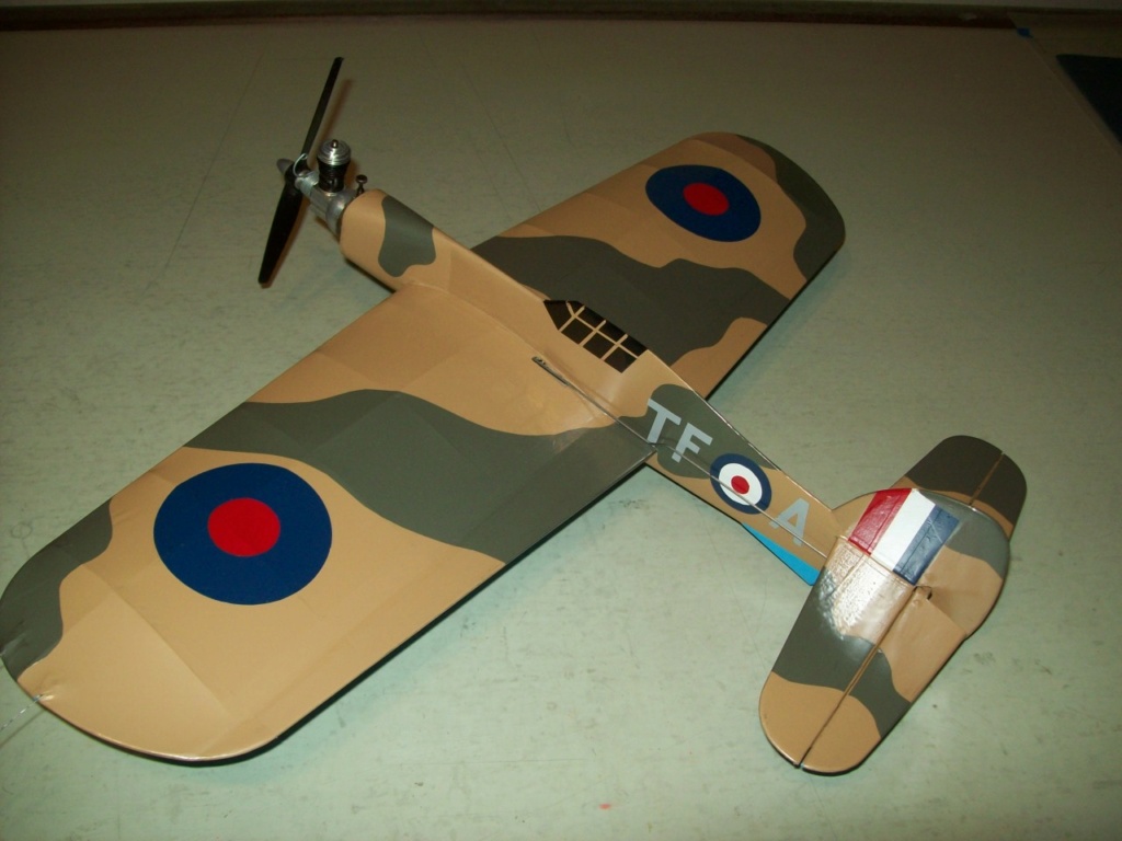

I decided to put the gear on the Hurricane, just to get the right "look". Covering & markings again are all Monokote. I think this one took longer to cover than to build. I was fresh out of stunt tanked Bees, so it got a standard Babe Bee.

Wow duaneh Two more Beautiful models , the Hurricane really catches my eye ! Nice job I know you want hear that covering looks Amazing ,Cause it does Happy New Year

Winners!!!!!
You caught that unusual turtle-deck slope on the Hurricane perfectly.
