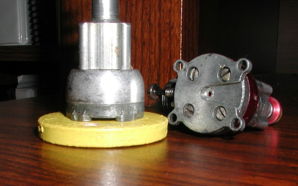

I thought of something. At the risk of sounding stupid...I was testing the engine on a bench mount I made. It was screwed firmly to 2x2 wood. I'm now thinking I need a hole through wood at center of mount for what I believe is the air intake on backplate? Could this have been my problem all along?

Should not be a problem. The Pee Wee's have a relief cast into the backplate that provides adequate airflow.
