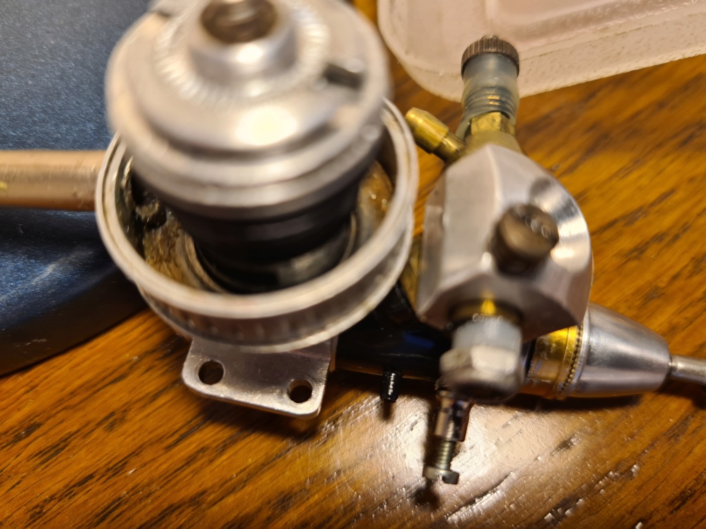

In general the stock exhaust throttles sold by Bernie and Matt for the stepped and thick wall cylinders are quite handy, but they will not fully stop the engine, just idle it to a few thousand rpm-s. This may allow a low speed landing with a large prop and midsized- not small - plane powered by a 049 COX engine.
The one on my photo was made by me for a thin wall old stock cylinder that has a flange at its bottom, not allowing the use of the standard exhaust throttle. I made that by winding a strip of repurposed beer can aluminum strip around the cylinder, slit it diagonally opposed where the exhaust openings are, and hold it tight with circlips, whose eye accommodates the pushrod end for RC control. It's efficiency depends on how accurately you wind the coil around the cylinder. Some I made are very good, others are less.
This one I made for a TeeDee051 seals and idles as well as the stock.
The one on my red postage stamp backplate reedie is a bit mediocre but still good.

I really like the design of that exhaust throttle you made Balogh
I think if I put in the time and effort I could make one fit and work fairly well inside of the standard cox round muffler. I need a muffler on my engines where I fly. I can get the throttle Bernie has for grey backplates for my surestart engines, but the exhaust throttle on a TD I would have to make work with the standard Muffler as the TD is much noisier that a Surestart to begin with. And the RC carbys for TDs are out of stock, and looking at them I dont think they would fit with a muffler anyway. So your beercan and circlip design.... might be the go for me to integrate into a muffler on a TD, as Im buying a cheap RC Tx and Rx to play with. My lad wants to have a go. Im going to make some hacky flat platforms with wheels and using the engine and a prop and the rx etc mounted on it with servos and stuff to get used to the Tx/Rx, electronics, how it works and stuff, as that is much easier than wrecking planes in the process. :-)

Thanks, Yabby.
The muffler and RC carb can fit when mounted on a TeeDee together. This is a Tarnot Carb but its dimensions are the same as the COX RC carb.
If you want to combine my makeshift exhaust throttle with the muffler, take note of the narrow clearance between the cylinder neck and muffler.
I am looking forward to seeing your solution!

Thanks, Yabby..this is a very old 051 with thin wall cylinder - hence the DIY throttle ring on it.
