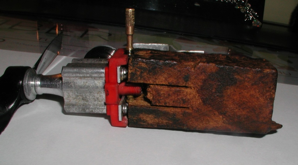

Of the four, the postage stamp is the most interesting, not just for the engine but for the two mounts. The guy was a better metal worker than he was a carpenter. The aluminum mount is perfectly cut and the holes for the machine screws are perfectly aligned. To house a fuel tank I would think? The wood, not so. Looks like something that I would do, measured with a stick and cut with an axe.
Might have been mounted in a vice and ran by the looks of the indentations on the wood. I was going to toss the wood, but thought, why not! Went out to the garage scavenged the two sheet metal screws and put it back together as found. Well almost.

Yes, aluminum oxide. Looks real nice in person. Packerized like. I polished the drive washers, compliments the fuel tanks which were rough to begin with.
Still wondering about the shape of that aluminum, must have been for some sort of a fuel tank?

It looks like the right size for a rectangular Perfect 1/3 oz. fuel tank.
Smart placement for the tank?

I might have one of those tanks sosam. Might be located a little high.

With the tank being high it will be hard to start, but after it is running it's like having a pressurized tank forcing the fuel without using a hopper tank.
Just make sure you have a big enough loop in the fuel line to hang below the engines needle valve.
