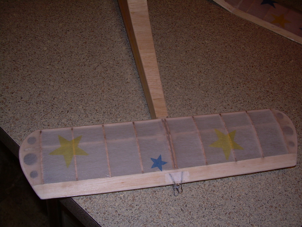

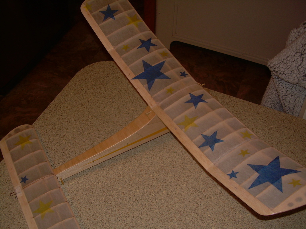

The Polyspan is taking multiple coats of dope. I have about 6 coats on the wing now which are nitrate. I will switch to butyrate on the next couple. Once again, the cold means I need to really thin it and I keep running outside when I can. Quick slap on some dope and place it in my detached garage to gas off a bit. I then rescue the pieces from the cold and back into the house. In all this craziness, I had some Jap tissue which I started to cut some stars from. I really don't know what I was thinking as this is time consuming in itself. Dope the stars on and keep building coats. The fuse is done in Sig Lite Coat and it currently has 4 coats on it and it needs a additional over the yellow stripe I painted on.
Debating on some stars on the fuse.
Stab is in need of some blue stars. Rudder is in the process of being doped. The rudder is a part of the dethermalizer as it glues in between the two center ribs and the rubber band passes through a hole in the front of the rudder
I've enjoyed building this and this plane is extremely light in fact too light in my honest opinion. I even opted for heavier sheeting throughout as this came with 1/32" and I switched to 1/16" I even beefed up the front with 1/4" ply F-1 vs the 1/16" ply that came with it not too mention other selected pieces to beef up the landing gear area

Wow the covering you been struggling with Looks darn good to me shows the plane off , what's the W/S on that baby ? firstwordisee Your plane has famed out Nicely ! Looking forward to the covering .
