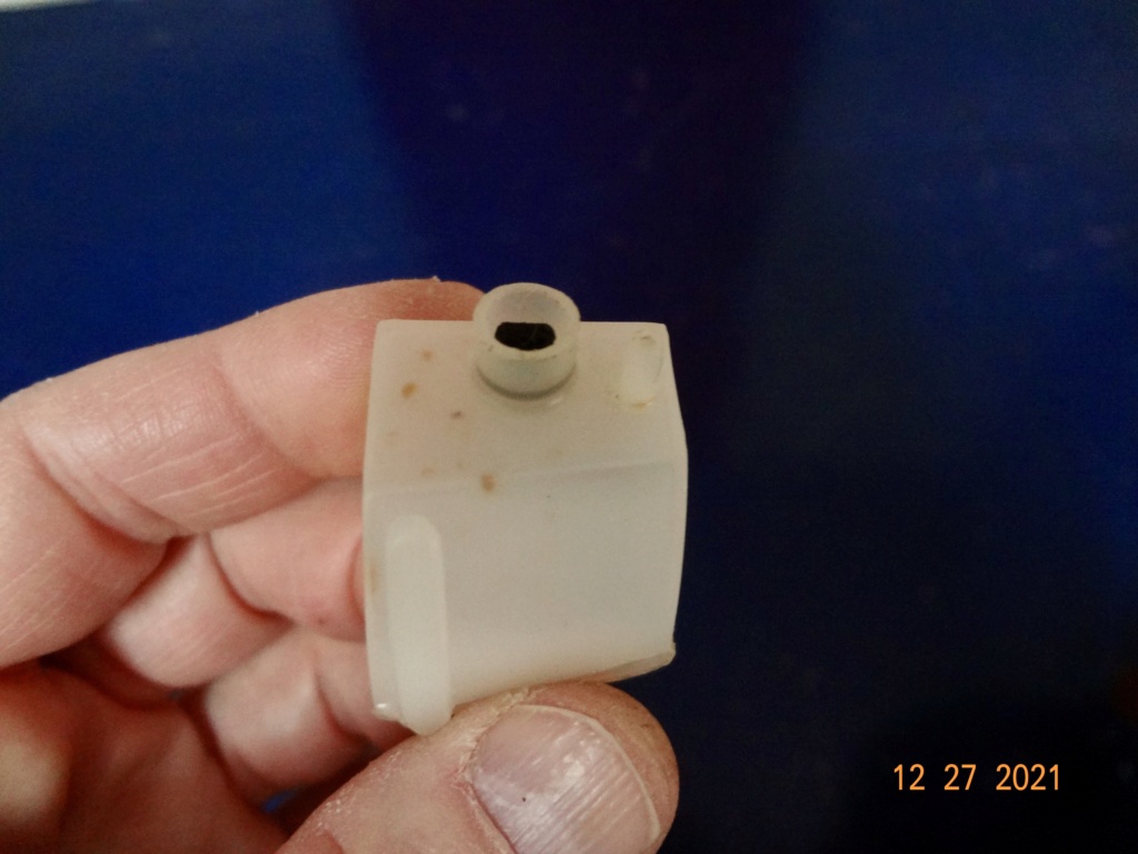

You are right, the green one is a P-40. My fuel tank look very close to this P-40 fuel tank  with what it look a fuel level window
My fuel tank
Wrong Stuka fuel tank ?  Dsc09424
Wrong Stuka fuel tank ?  Captur40
