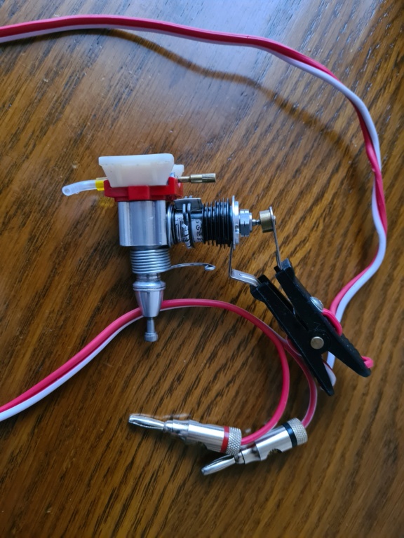

Outside.. ground-fork part on top of the head-body.. and smaller "hot" fork/clip to the center electrode. I've most-times used the Cox clip. I've rewired a few that needed it; generally with heavier AWG. The stock wire isn't heavier than 22 AWG.. and may even be 24 AWG.
Re-wiring that clip with 2C 18 AWG (lampwire) delivers more amperes.. especially if your attempting to start your engine in a cold climate.

Ken Cook gifted me a "Kwik-Klip" years ago.
I had some nice high-flex/high-grade 4C 18AWG that I stripped some red and black to wire it with..
Solder all connections for the least resistance.
Just need to be aware of where the lower clip makes contact on the cylinder-barrel. Stay clear of exhaust ports where the clip could accidentally enter the port which would cause engine damage.

Well, I am a Cox clip kinda guy. I am because that is all I have. I used to slide the lower contact between the fins until I believe I had either read or seen here that it also fits better resting on top of the fins. I have one or two spares here, and I have rewired one with thicker gauge speaker wire and also inserted a thin plywood shim between the two contacts so they do not short out.
