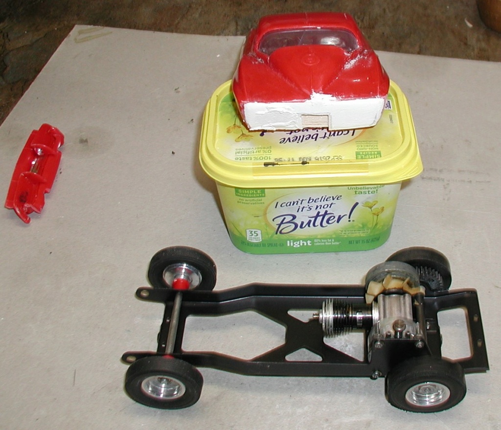

I think Mark found this for me at a flea market.  Ignored for years I finally got sick of looking at it.  Missing the rear valance altogether, front valance broken off, one chassis retaining clip broken, rear windshield cracked, rear fenders distorted due to engine heat, engine seized and missing the three self tapping screws replaced by 2/56's, no tether and missing one hub cap.
Cleaned the engine and sandblasted and painted the chassis matte black and reassembled using the 2/56's. Couldn't locate the very short original self tapping screws.
The not so Cox Corvette P1012411
The not so Cox Corvette P1012412
Thought I could reduce the plastics blistering by installing the engine backwards discovering later that it interfered with the cockpits interior.  Duh!
Built a rear valance backstop out of balsa and glued it in using canopy glue (wonderful stuff) and layered on some splackling compound, sanded and hardened with coats of sanding sealer.

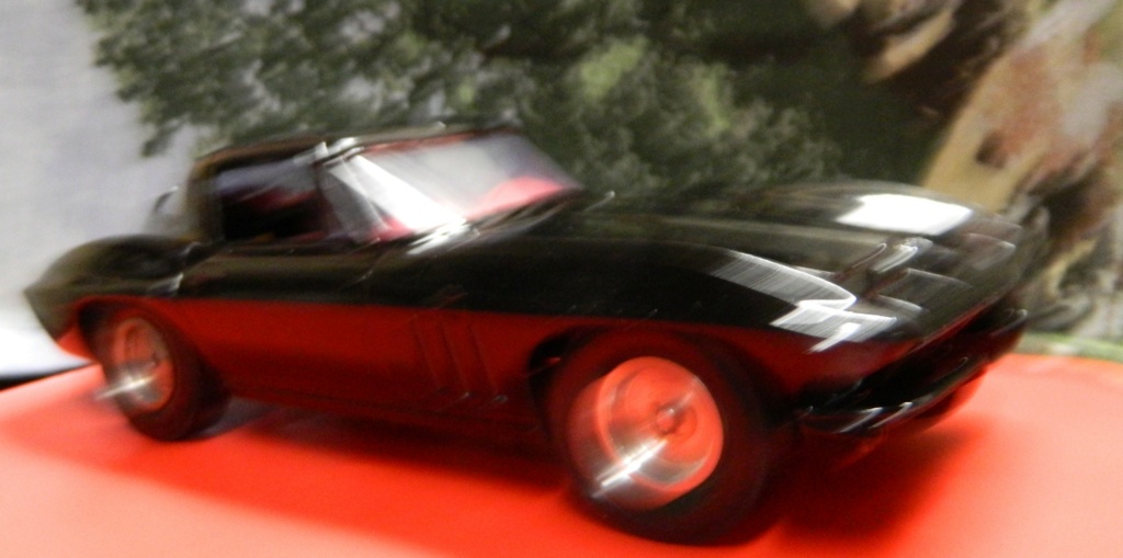

Nice picture Rene.
The not so Cox Corvette Bad_bo10

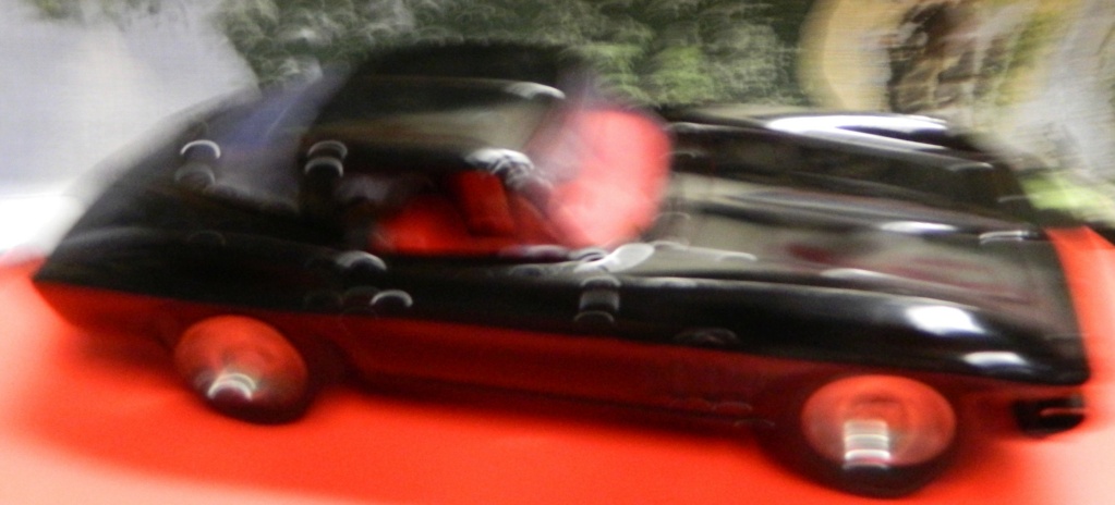

Finished it (for now) this morning.  Can side pipes be far behind.
My card reader for my Olympus gave up so I have to use my Nikon cool-pix which does half the job.  A combination of that and shakey hands.  New card reader coming along with better pictures.
Interesting effect though and covers all the flaws. Smile
The not so Cox Corvette Dscn1415
The not so Cox Corvette Dscn1416
The not so Cox Corvette Dscn1414
