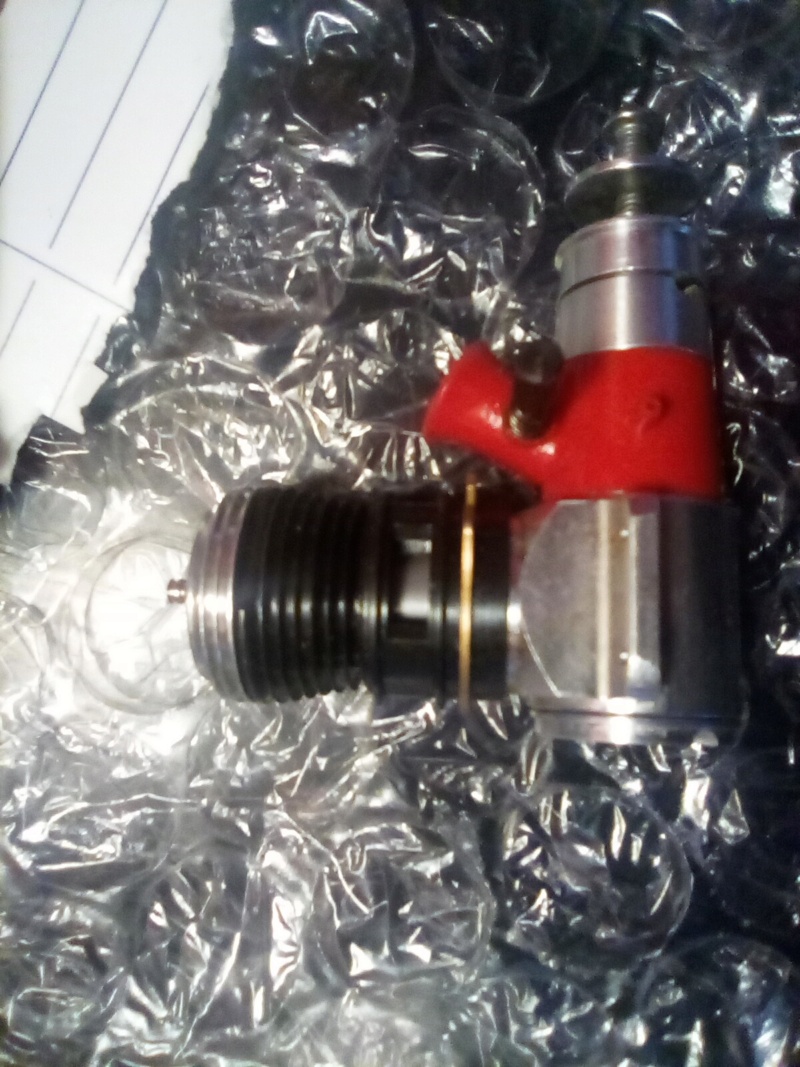

Today I received the Fatal Flaw engine from fredvon4  cheers  Re: the Fatal Flaw engine 16413110
I received at the same time a part to modify the engine a precision throttle control for it i was tinking To fit à medalion cylinder To it... And  Mom told son it's a gift for daddy My little boy was, I think, more excited than me, his eyes were on the engine that I had just unloaded from the box, and his eyes were   on the parts I had left the new package on the table Strange the package looks like a hottwheel package for him So he rushes to take the package run in the living room and then the inevitable happened boom explosions of little parts Shocked Doh! affraid  Re: the Fatal Flaw engine Img_2261
Let's say he likes to destroy the hotwheel package m'y o m'y No!  m'y boy Neutral I was able to save everything, I have all the pieces, I put the pieces back togetherRe: the Fatal Flaw engine 16413111

Unfortunately Sportman's new cylinder and piston does not fit the médalion engine crankcase  the sportman piston fit the engine but Not its cylinder it has no compression in the médalion cylinder as the piston is mutch smaler and taper but I have a piston that perfectly  fit the médalion cylinder wit super Good compression I only need one connecting rod a piston pin and a litle retainer clip Re: the Fatal Flaw engine 16413210Re: the Fatal Flaw engine 16413211
