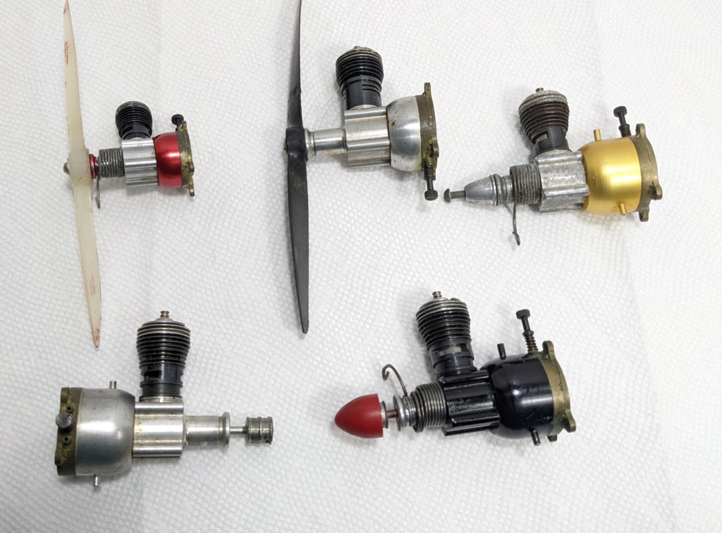

With the forum's assistance, I have taken a stab at the engine IDs. Appreciate your grading on how I have done here!
My guesses are, top row left to right:
Pee Wee .020
Babe Bee .049
Golden Bee .049
Black Widow .049 but in silver?
Black Widow .049

Pretty well spot on. Well done. The only variation is the "Silver" black widow. While it's true that there where some all silver Black Widows sold, there was also the "Silver Bee" which was used in the Spitfire. Then again, that may have only had the larger tank fitted rather than a vented stunt tank. Someone else is sure to know.

I believe that is what was called the Cox Silver stunt https://www.worthpoint.com/worthopedia/cox-silver-stunt-049-model-airplane-1796043838

About your engines, the silver one could be a Black Widow that has missed anodizing. Check if the cylinder has #1 stamped on it. If it has, it’s a Black Widow, as the #1 indicates a high performance cylinder. It’s not a Spitfire engine, because as Rod suspected, the Spitfire one has a long, but unvented fuel tank. It could be a QRC, missing a muffler, as the version installed to different Ready-to-Fly airplanes went unanodized. The separately sold QRC engines had a red fuel tank. Or maybe it’s a Golden Bee without anodizing
So it could ”bee” just about anything, or maybe someone just swapped the tank for a longer one. A fuel tank kit like that was available for people who wanted to fit a bigger tank on a Babe Bee.

When I was looking it seemed like the silver one could be a babe with a bigger tank, or a silver widow, and it also fits the stunt as noted earlier. I will just take it as a Silver Cox
