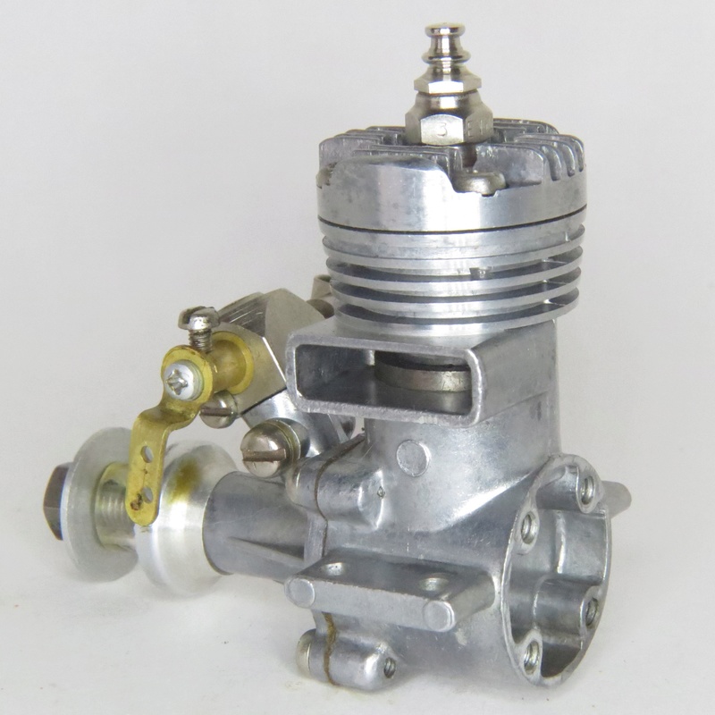

Those Enya .09 engines are nice to have.
I have one of the 1st Enya .09 model #3001
To the Enya .09-II version --- very rare throttle control version
And the Enya .09-III
To the Enya .09-III Ball Bearing version (this set is when the .09-III Ball Bearing version first came out while the Enya .09-III was still being produced)
Photo of instruction sheet with the Enya .09-III and Enya .09-III Ball Bearing when the Ball Bearing version 1st came out.
I also have the Enya .09-IV / Enya .09-V / Quicky versions --- total of 51-- Enya .09 engines variations.

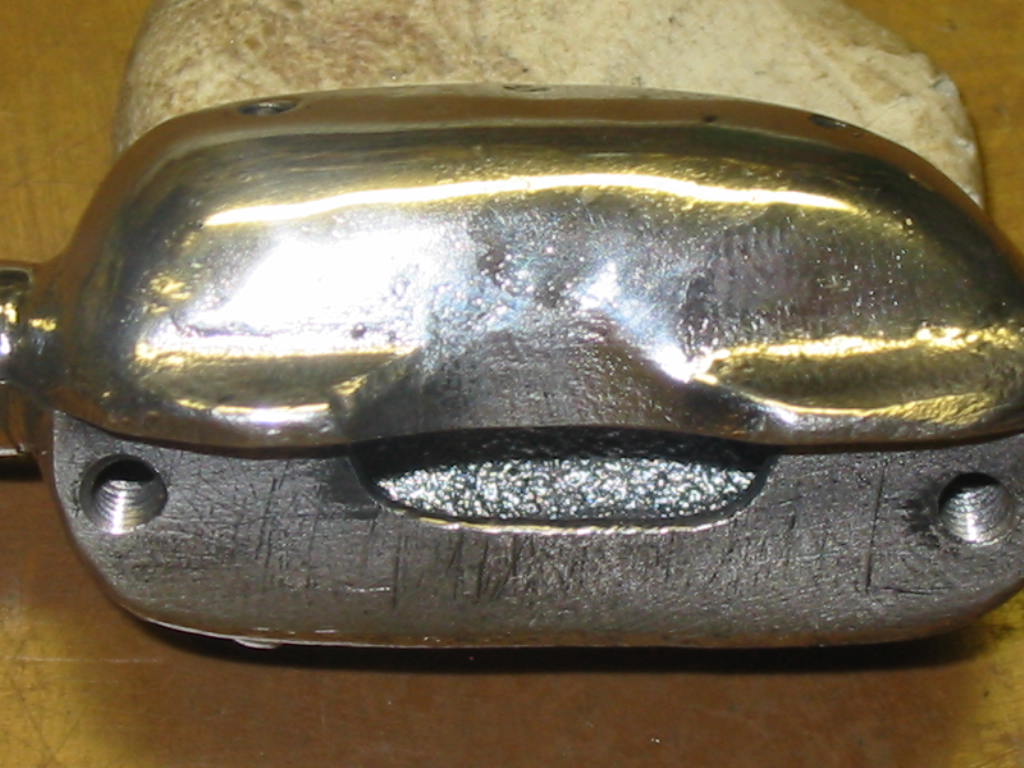

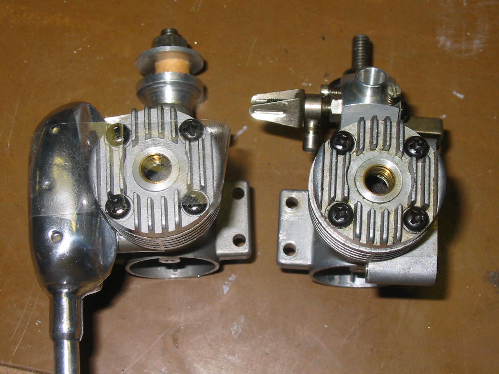

The tough part is getting the muffler for the earlier versions like the .09-II and .09-III.
They have the muffler on the left side of the engine and not on the right side, so finding the old muffler that fit that side is a little harder to find.
The later versions Enya .09-IV and on have them on the right side and the bolt location for the muffler casted into the crankcase.
Where the older ones used a clamp around the cylinder head.
Below are photos of a Tatone muffler that fits to an Enya .09-IV as it comes in the package from MECOA.
The Enya .09-IV is the engine on the right side of the photo.
Next photos are the same muffler but have been modified to fit to an Enya .09-III.
The muffler is inverted (flipped) then what was the bottom of the muffler was ground out to clear the cylinder head.
The Enya .09-III is the engine on the left side of the photo.

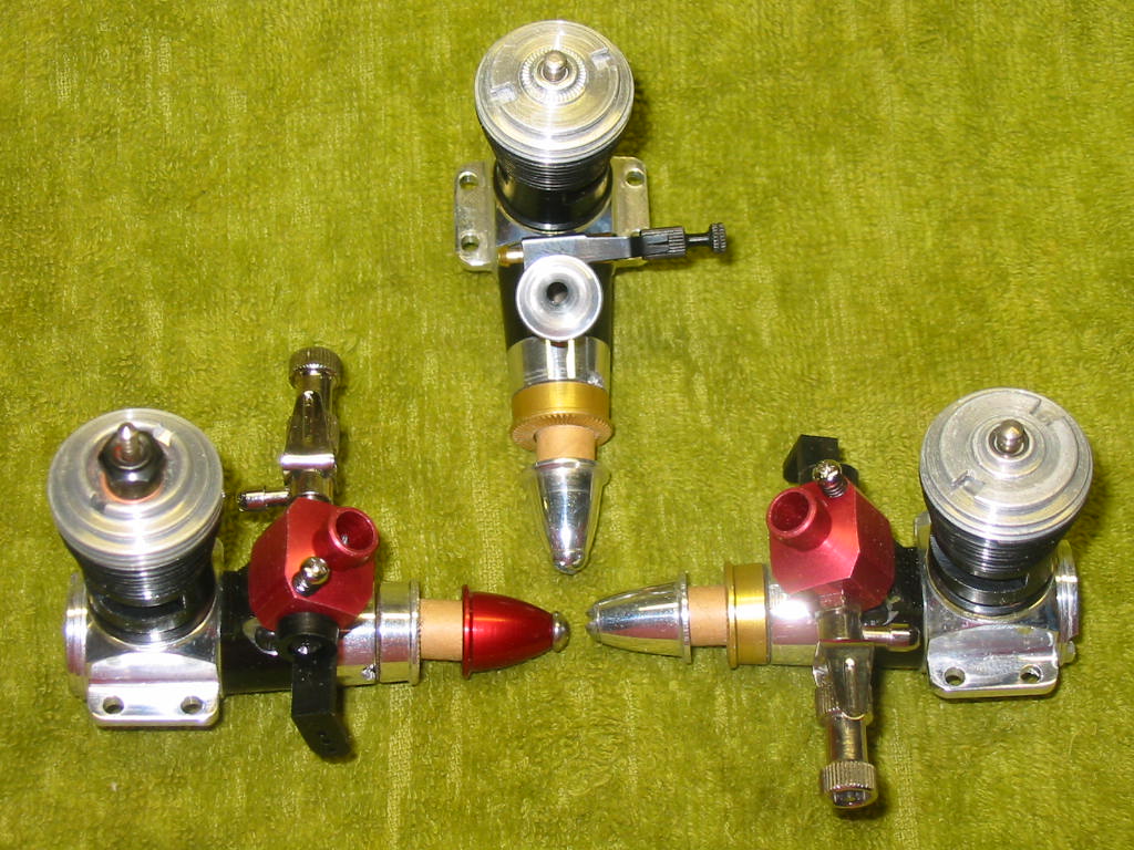

Yes, an Enya .09 carburetor will work on a Cox .09.
I retrofitted an Enya .09 Quicky carb onto two Cox Tee Dee .09 engines.
I used the Enya Quicky carb (for R/C cars -- part number 09430C) because it does not have an air blead hole on the front of the carburetor.
And it's "RED" to make it pretty looking (different).
The other thing I did was to use the newer "aluminum" (dural) venturi body on the Cox .09.
Reason is that the diameter of the Enya .09 carburetor is 7.0mm (.275") and the threaded hole for Cox carburetor
is the same size.
So, the Enya .09 carb. slips into the Cox threaded venturi body, which the threaded hole measures 7.08mm.
If you look at the photos of the Cox engines with the Enya .09 Quicky carb. I used the Enya carb screws
to hold the Enya carb to the aluminum venturi body where I milled flat areas for the screws.
All of the Enya .09 and .11 carburetors sizes that go into the crankcase measure about 7.0mm
When you move up to the .15 and .19 carbs is when the size of the throat changes that slip into the crankcase
and that is about 8.75mm, and those carbs don't work well on the Cox .09 because the intake is too big.
But I was able to thread the bottom of the Enya .15 carb to fit into the Cox engine.
I even made sleeves to slip into the throat to reduce the I.d. size of the .15 carburetor down to the .09 size.
Wide open it did o.k. but at idle it would die.
Probably a problem with the air flow with those three brass tubing restrictors to reduce it down to the .09 size?
I'll take more detailed photos of the engines when I get some time.
The cheaper .09 carb to get is Part #09330 --- it comes with the "plastic" throttle arm.
Order the metal throttle arm part #09330C to replace the plastic throttle arm.
The 09330 carb has a bleed screw in the front. Just screw the screw all the way in to close it off.
Or remove the screw and epoxy over the hole to plug it off?
The Cox engine doesn't really need it.
