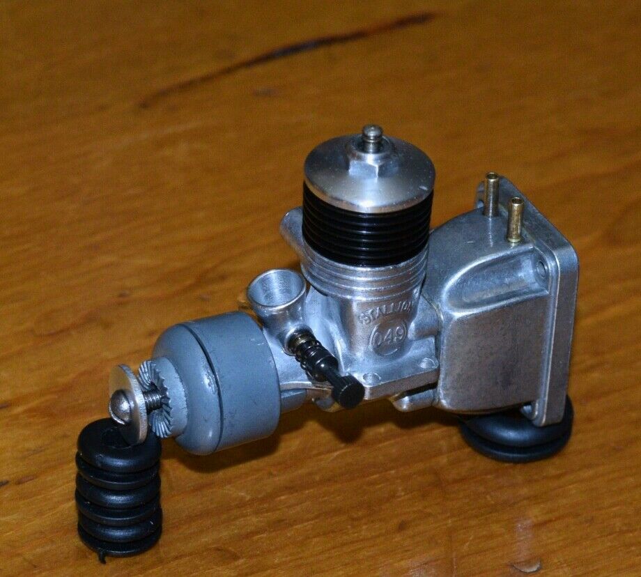

I was just following one on ebay. Nice looking engine that I don't have. I didn't bid, but wish I had. Went for a reasonable $34.
https://www.ebay.com/itm/334299321528?nma=true&si=zs429nBoVNmw%252FH%252Bfu%252B33jj3Kecc%253D&orig_cvip=true&nordt=true&rt=nc&_trksid=p2047675.l2557
K&B Stallion .049 Stalli10
