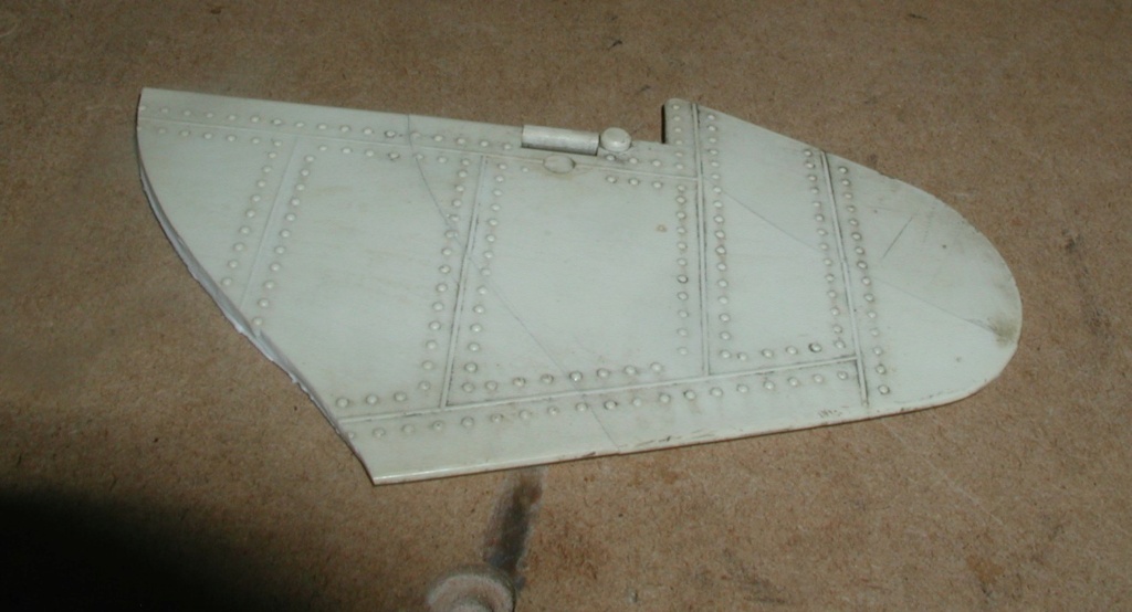

Good evening all,
Looking for information on anyone who is restoring broken or warped Cox, Wen Mac models. Considering setting up part of my shop for just this purpose. Looking for info on needed equipment and knowledge that might streamline this process.

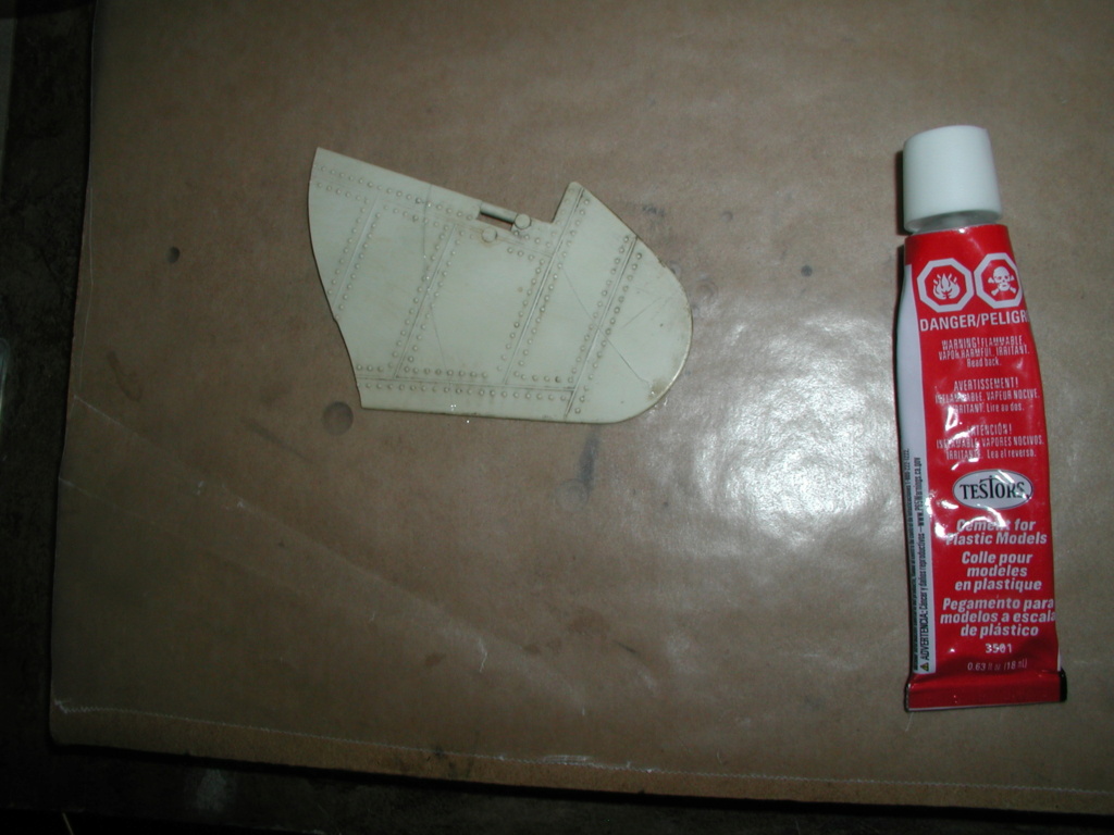

My go-to's for plastic and other repairs. But I always find myself going back to common every-day Testors red tube cement. Most effective that I can find for repairing the types of plastic used in model airplanes.
But these get the most use.
Instructions say to "Apply sparingly to one surface, join and let cure for two hours." I do but ensure that all the surface is covered before joining and I don't move it for at least twelve hours or over-night. To join flat surfaces, I use waxed paper laying the recipient piece flat, then coat the mating surface and join angling down to avoid smearing.
No plastic repair is going to be perfect; you just try to make the best of a bad situation.
