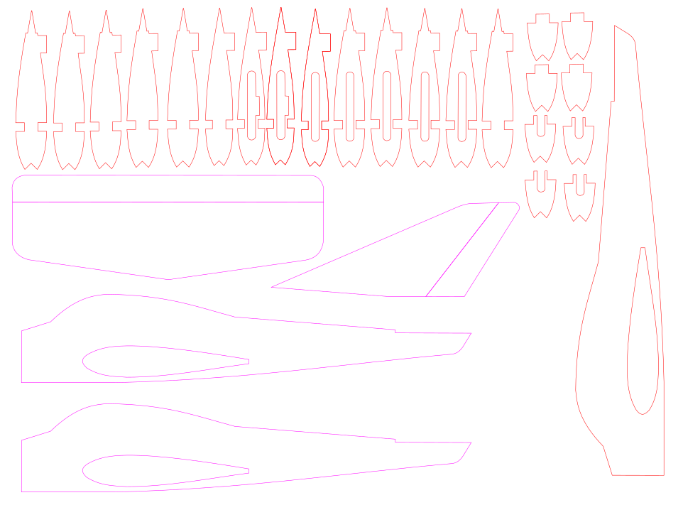

Today it was my Skyray 110 (here). It just kept weighing on me, and I eventually had to do something about it. There were a couple of things on the first one that I wasn't satisfied with, so I'd toyed with doing another one, but didn't really feel like taking the time to cut a kit out, with all the other things I'm wanting to do. With the Maker, no reason not to do it. My first Skyray 110 was a beam mount, so I went ahead and designed it for a radial mount as the SIG Skyray has. A Black Widow will be more suited to 110 sq.in. wing than a TD .049 engine. The fuselage is 1/4", but the Cricut Maker won't cut thicker than 3/32". So I'll cut two 3/32" fuselage blanks, and one 1/16" blank and laminate them together to make a nice, stiff 1/4" fuse.
Behold, the Skyray 110 MKII:
The red parts will be cut from 1/16" sheet, and the purple from 3/32" sheet.

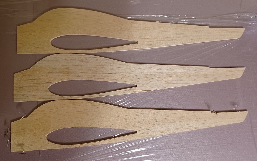

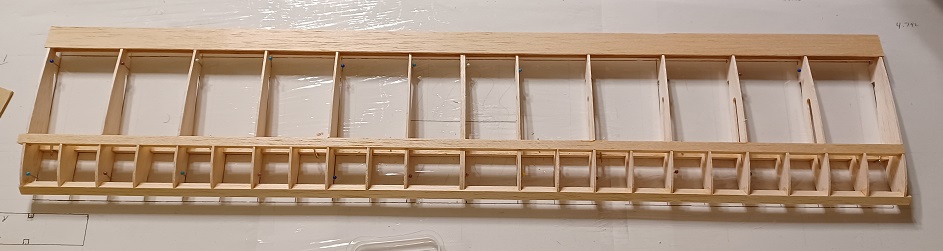

Okay, got time to start gluing today. I won’t do a lot of pictures, since it’s almost the same as my previous Skyray 110. I’ll just do pics of things that are different from the first build.
The wing goes together too easily. Everything fits just right the first time, in no time.
As I said earlier, the fuse is ¼”, but the Maker will cut 3/32” max thickness. So I’m laminating two 3/32” and one 1/16” fuse blanks, sandwiching the 1/16” between the two 3/32” blanks. The laminated fuse is solid. Doesn't bend at all, which is an advantage over my first 110. That one twisted with prop torque. This one won't twist at all.
