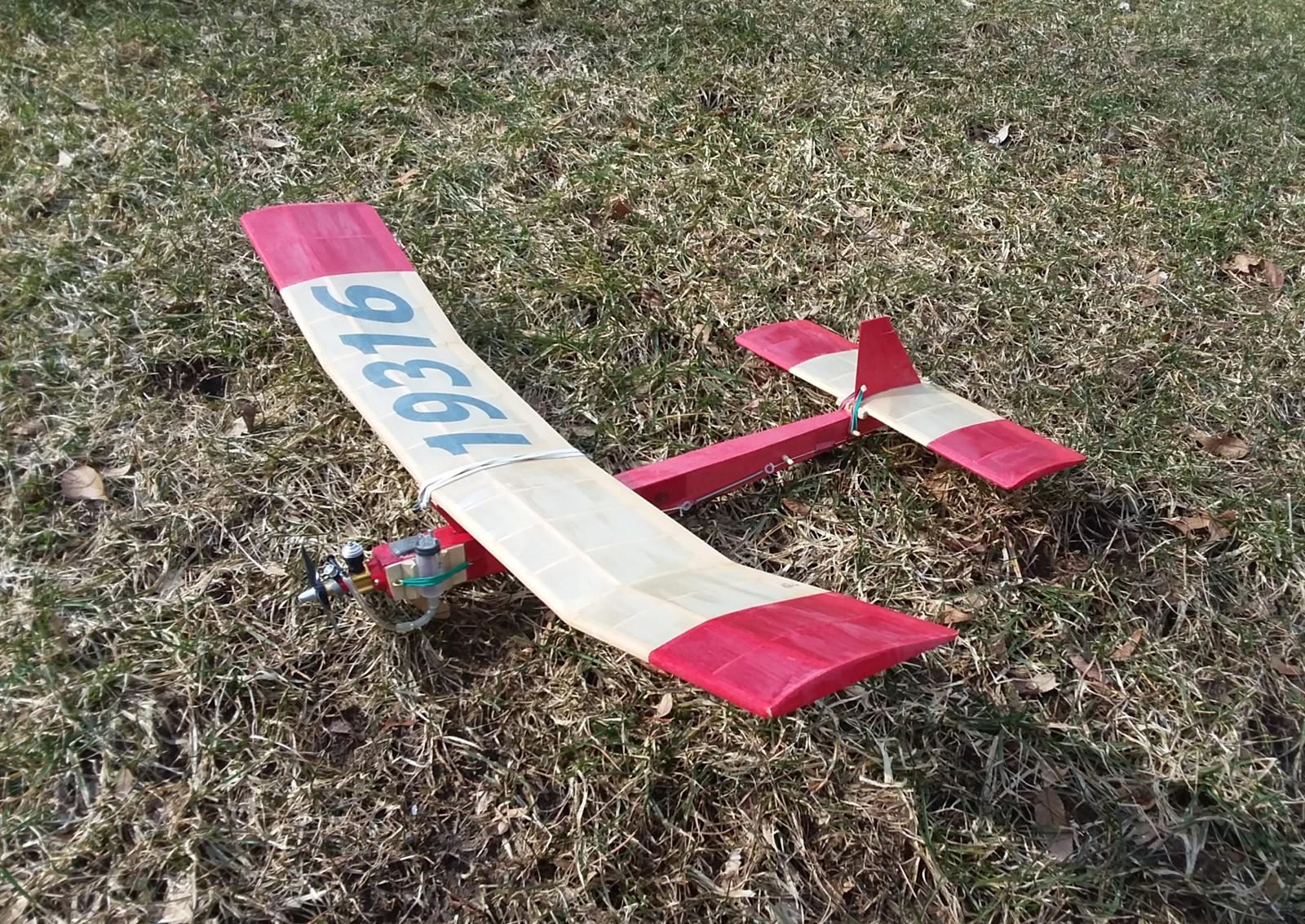

Hello- just following up on the eyedropper topic that I brought up.  I ended up using a modified 5ml syringe as the basis for the 010 fuel tank instead of an eyedropper.  The good news is that it works very well.  Thanks to all of the input and information that I gathered from this and other sites I was able to come up with a compact, lightweight design.  I am using it on an 010 version of a 1962 free flight design called "Fluff".  Not sure how to add photos to this topic.

Nice to see it completed, looks functional.

Looks Good , was this a kit ? Like the way you got the syringe wedged between balsa? Is that fuel proofed too Looks bare. Huh...

Sorry for the delayed response. The 010 "fluff" was not a kit. I had the plans. 1/2A/A full size Fluff design was published in Model airplane news back in 1962. It was also scaled for 020 and 010. I know because my father, Tony Faranda, was the designer.
Yes I did fuel proof the balsa syringe tank holder area. But I left it bare wood rather than covering it with tissue.
