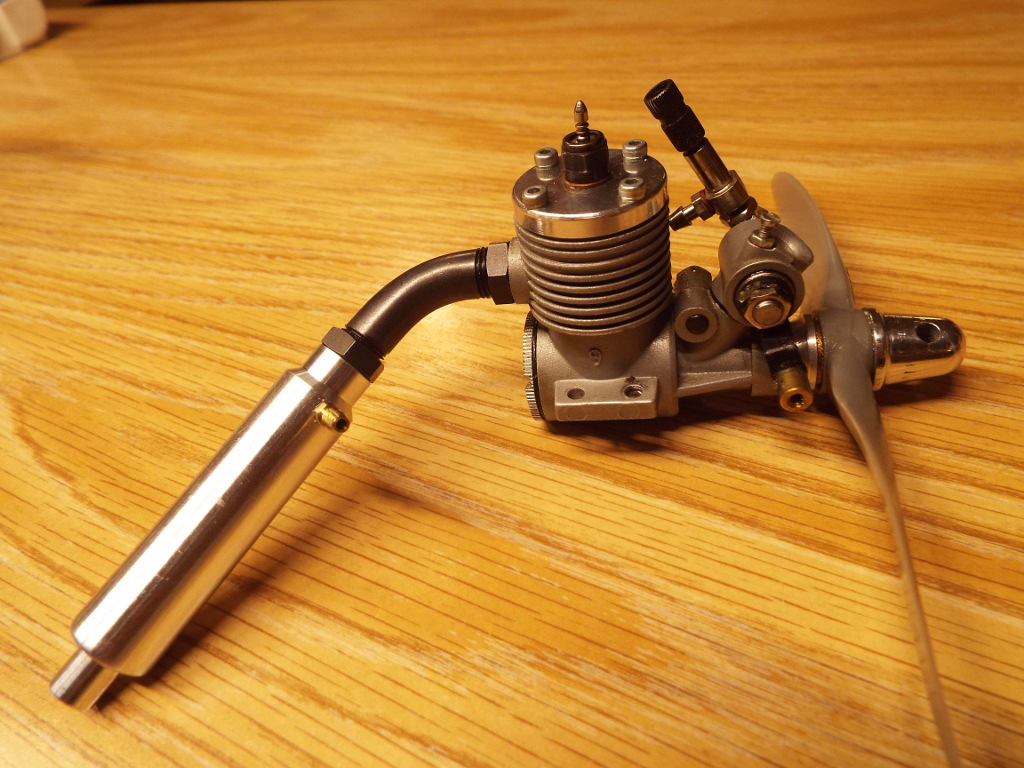

Why the finless head? The Sanye AP .09 R/C is finless, yet runs fine.
For the HB .15 - something 7/8" ish?   2018-131
AP .09 R/C with Saito muffler and pipe.
Per Chinn, engine is not to be loaded up with larger props, similar to most Schneurles, but run toward its peak efficiency and bhp. (It's bhp and torque curve is different than say, Enya.) Perhaps it idled too cool with the proper prop?
