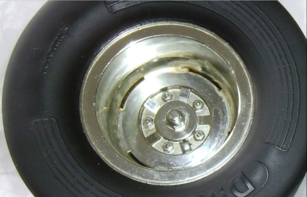

Hi, newbie here, just bought a trike like a I had as a kid and was wondering if anyone knows how to remove the rear wheels so I can take it apart and clean it and see if i can get it running. It looks like they may just pull off but there is a small nut on the plastic rim and it appears to be plastic so not sure if I have to take them off. Any help would be greatly appreciated, thanks!

Thanks guys, the picture helps but still a little baffled on how these come off as it doesn’t look like it is actually threaded. It does look like some sort of clip but in looking at the actually trike I do not see where they would be…. Huh... Huh... Huh...

Well got my curiosity going so looked on eBay. The nut is fake. Left wheel slips on the grove in axle.

This wat i was saying push and it clip in place no colet no nut

once the wheel of the drive schaft bushing must be split so that u pul open a bit then it slip on the drive schaft
