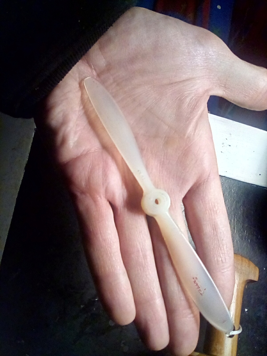

The TF props give that vintage look to display engines and models that I like.
The not so pristine TF props that I would like to run are boiled for a few minutes in water that I have added a small amount of red Ritz dye.
The dye gives the props a ruby red color and it also serves to keep me from forgetting which are rehydrated and ready to go.

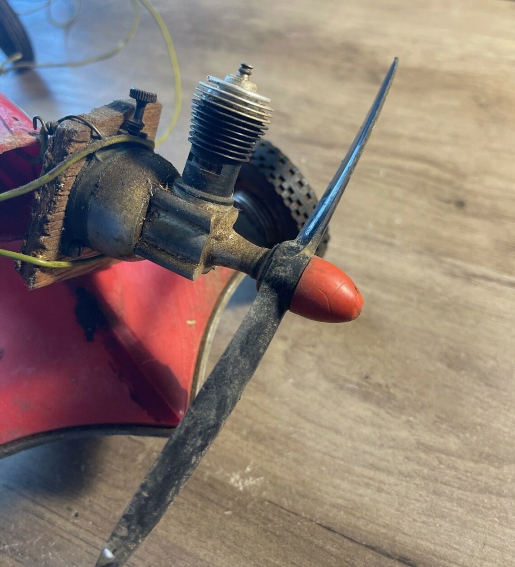

Beautiful job BG, and CB I have always admired your Prop Rod and couldn't imagine why I didn't have one.  I have been reading this thread with envy, so I went looking.
Every Prop Rod that I have ever looked at on ebay was way too nice, until this morning I stumbled on this one:
Prop Rod engine screws and restoration  - Page 2 Prop_r10
Prop Rod engine screws and restoration  - Page 2 Prop_r11
Prop Rod engine screws and restoration  - Page 2 Prop_r12
Not so nice but just my speed.  $80 BIN.  Here next week.  Early model, metal pan, thin wall, large head needle, tapered case BB.
