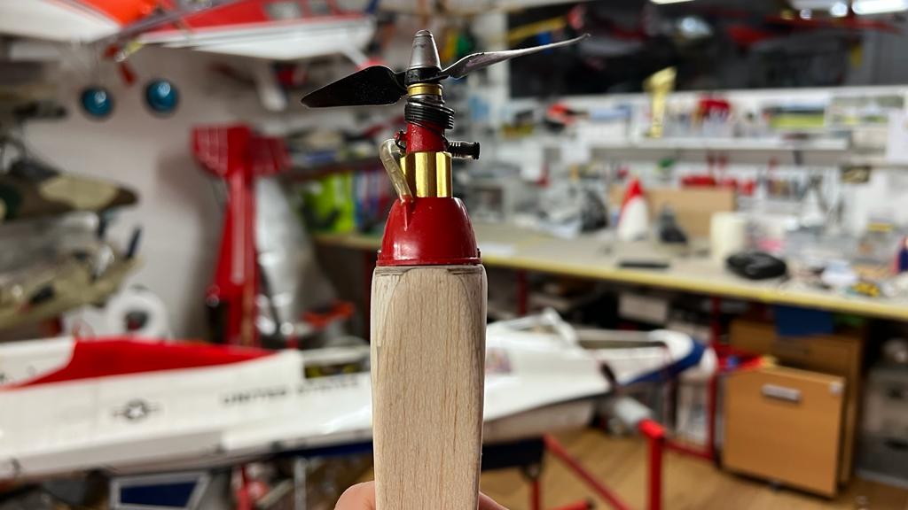

Cox PeeWee Micro Speeder - Page 4 9b5ea810

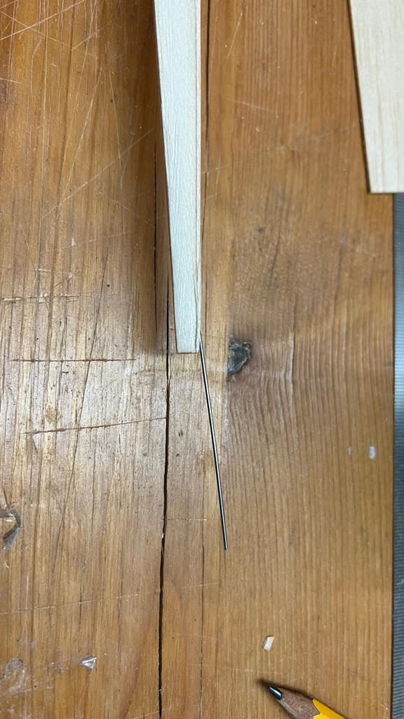

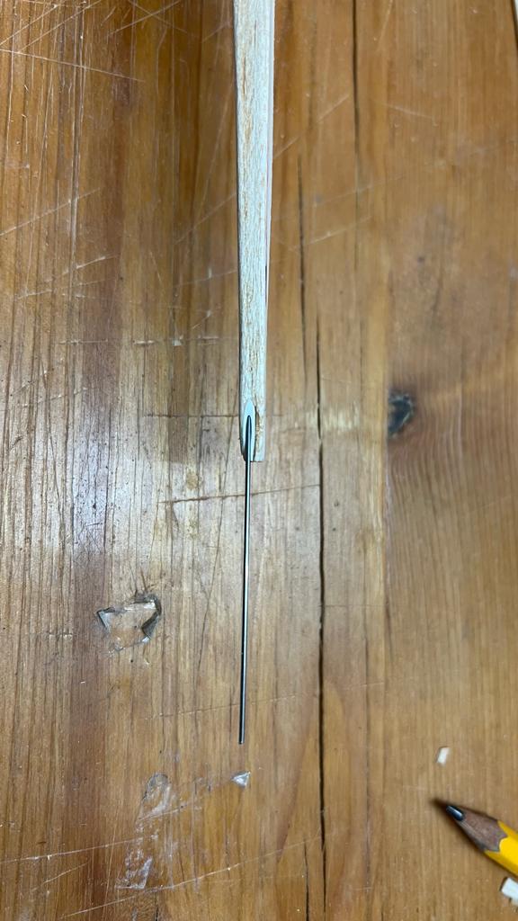

First I sketched the parts, everything is a little smaller. The wing moves slightly forward to improve the center of gravity, while the tail is slightly longer to further increase stability. The fuselage is narrower again, I hope I can pack everything I need in it Laughing Cox PeeWee Micro Speeder - Page 4 Whatsa10
Cox PeeWee Micro Speeder - Page 4 210
After that I pretty much did everything as usual.
Cox PeeWee Micro Speeder - Page 4 310
Cox PeeWee Micro Speeder - Page 4 410
Cox PeeWee Micro Speeder - Page 4 610
Cox PeeWee Micro Speeder - Page 4 710
Cox PeeWee Micro Speeder - Page 4 810
Cox PeeWee Micro Speeder - Page 4 910
Before I can install anything in the fuselage, I need to make the wing to see where I have room to install the servo Huh...

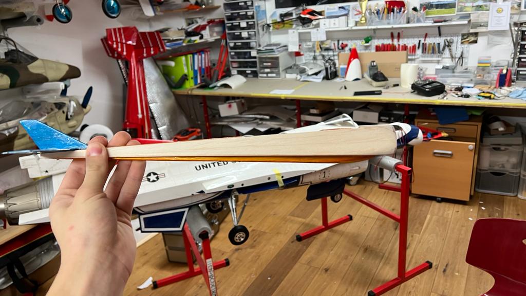

I've made some progress.
The wing is now only made of 3mm balsa, but is still very stable.
Cox PeeWee Micro Speeder - Page 4 Image024
Cox PeeWee Micro Speeder - Page 4 Image022
Cox PeeWee Micro Speeder - Page 4 Image023
Cox PeeWee Micro Speeder - Page 4 Image027
Cox PeeWee Micro Speeder - Page 4 Image025
Cox PeeWee Micro Speeder - Page 4 Image026
Cox PeeWee Micro Speeder - Page 4 Image028
Cox PeeWee Micro Speeder - Page 4 Image029
Cox PeeWee Micro Speeder - Page 4 Image030
Now only the linkages are missing. I hope the receiver and the battery will have enough space Laughing

Post  balogh Sat Dec 17, 2022 10:56 am
Do you sand an airfoil into the 3mm thick wing, or just leave it as a flat board and set the aspect ratio to a few degrees??
Posts : 4609
Cox PeeWee Micro Speeder - Page 4 Empty Re: Cox PeeWee Micro Speeder
Post  Tobaiies Sat Dec 17, 2022 11:01 am
balogh wrote:Do you sand an airfoil into the 3mm thick wing, or just leave it as a flat board and set the aspect ratio to a few degrees??
Yes, I sanded a profile
You just have to make sure that it's sanded evenly everywhere.

Post  1/2A Nut Sat Dec 17, 2022 2:49 pm
RC Plane
Looks great Tobaiies, should provide improved performance!
Fast work getting this one built up quickly for all to see and enjoy.
Taking the overview photo can resize / shape the project and reveal a faster plane. Flying

Post  Tobaiies Sat Dec 17, 2022 3:47 pm
thank you! I'm done, The RTF weight is 83 grams. Saved about 10% to the previous version.
I'm curious how the flight characteristics will change.
Fortunately, the space is not a problem, even better than before, the center of gravity is also easily adjustable.Cox PeeWee Micro Speeder - Page 4 3072e910Cox PeeWee Micro Speeder - Page 4 75647710
