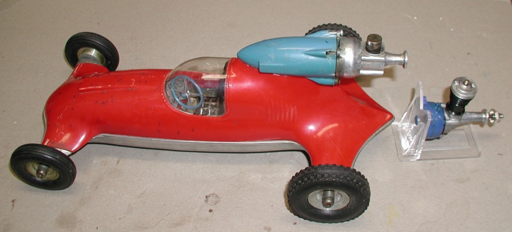

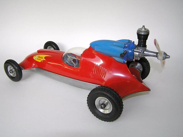

As I mentioned, I know nothing about these. So I nosed around the internet and came up with this picture.
And thought, I have one of those. Actually a couple in blue. Could it be that the Prop Rod was designed at the time the Space Bug Jr. was present. It has vents in the front of the pod that would feed the SB Jr's intake.

The Space Bug and Jr. were from about the early to mid 50s? The Prop Rod started about mid 50s? I had one about 1960 and it was the next gen with Babe Bee. I can't remember if the cylinder was up or down. Down would tear up needle and up would tear up cylinder.

Your guesses would be better than mine CB, but I do know I bought 2 Space Bug Jr's in 1952/53. After that it was all first gen Babe Bees.

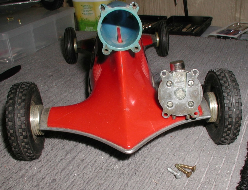

Here's another one on this blue/red Prop Rod. Ya have to look close and hope that it's not raining when you run it. PO had it installed this way.

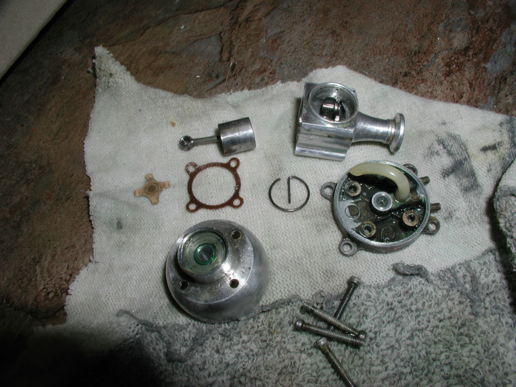

Digging into this one today. Engine missing the cylinder, glow head, and needle. No problem, I'll hit up Bernie or Matt (again.) What! Neither has cylinders??????? Had to go to ebay and found five used. $16.00 for the lot and happy to get them. Maybe be worn out or twisted. Play you cards and take your chances. One is trash anyway.
Cleaned up what I had and used one of Fred's matched set cylinders temporarily. I did not have to use my last treasured NIP Cox needle that I have had since I don't know when. Matt (my last order went to Bernie) had them, plus a bunch of other stuff that I needed.
I'm not opposed to saving a gasket when the ears are intact.

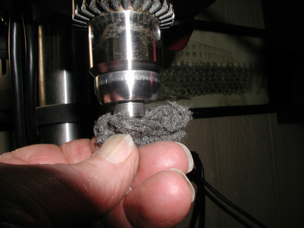

Best way to clean reed cradle.

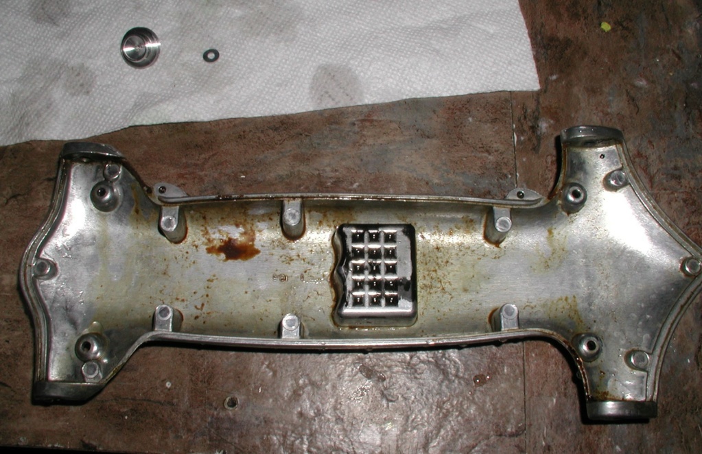

Pan's interior would not clean up with a Simple Green soak so I media blasted it.
Wear/use indicator. Red/Blue shows little use. Rear tires still have the middle rib.

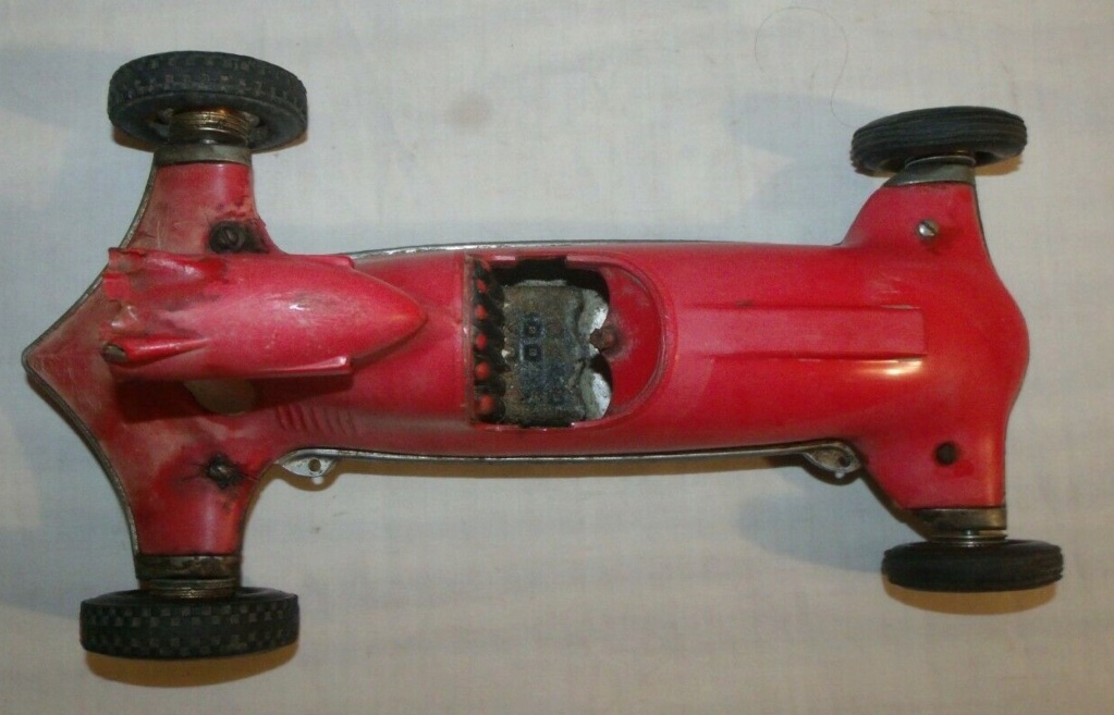

CB I ordered that canopy from the Classic Tin Toy Company, going to need it for this little jewel won on ebay a few moments ago.
$20 and I was the only bidder. No surprise on that.
Probably all the interior posts are broken and PO just drilled four holes in the body and bolted it on the pan. After they are filled it will need a paint job. Pod is a mess, more mounting mods as I did on the other one. Actually the new canopy will go on the better one. This one gets the castoff.
