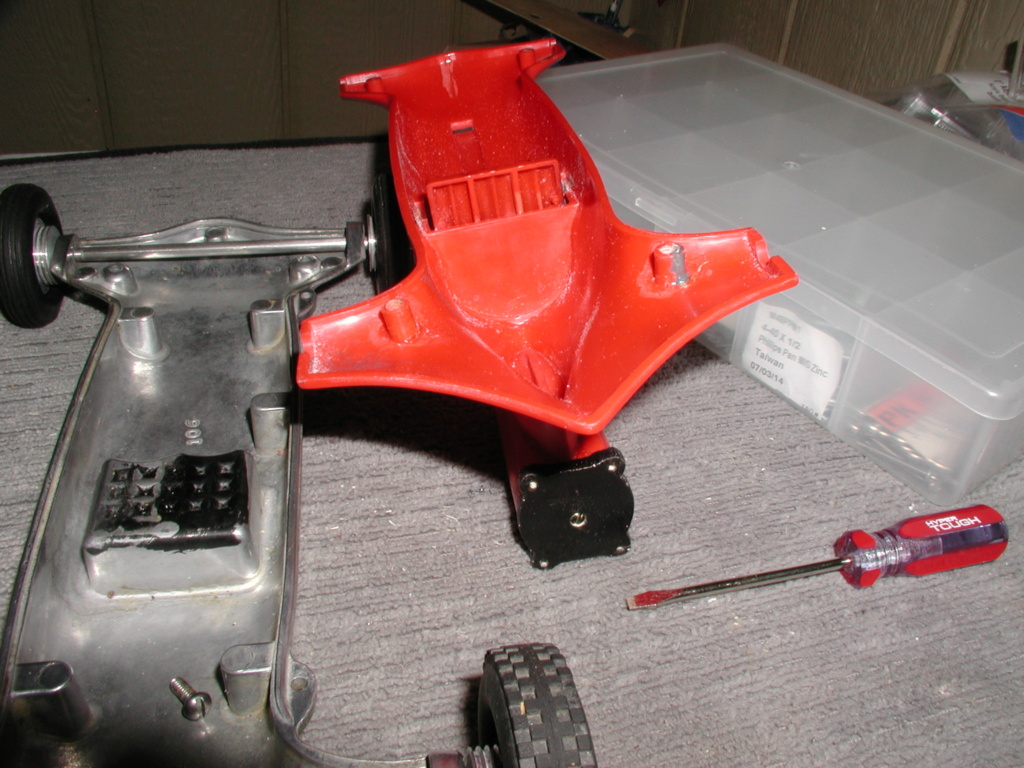

Not exactly to factory.
As received:
Restored Prop Rod  Prop_r20
Restored Prop Rod  Prop_r21
Worst damage was internal, both rear pan mounting posts were broken. JB Weld fixed one, but it took one of Jason's replacements to fix the other. Cut it to fit and tapped it 6X32 before cementing it to the body using the machine screw through the pan as a guide then applied cement to the body and dropped the pan with the post on and hoped. Got lucky.
