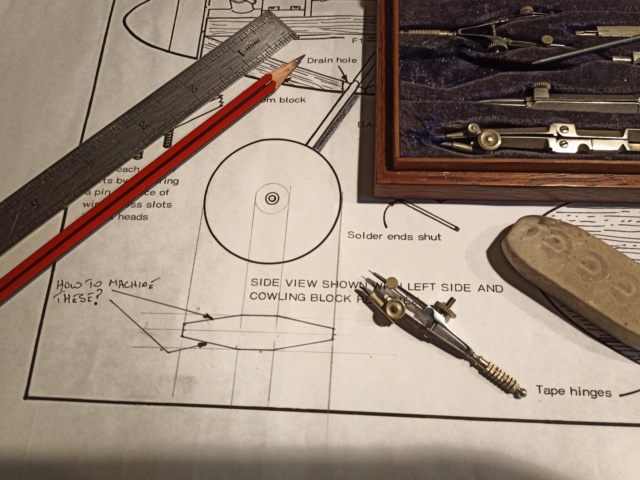

Machining help please?
Seems like I have to make the wheels as there aren't any available.
Its a lathe job so I have ordered in a metre of 50mm round bar black Delrin.'
I have thought for days about the process but getting nowhere.
Need a bit of help please?
I have extended the drawing to include a plan view of what I am after.
Can any machinists out there please advise?
If I can make a tool to cut both chamfers in one hit that will be great.
So if any one else wants wheels I can easily make them a set.
The diameter is set but I can alter the thickness of the wheels ad lib.
If I remember...they were quite thin and the old ones made of rubber with a brass axle boss.
Woody
Woody

- Posts : 1540
Location : Turkey
Re: Keil Kraft Phantom Scratch build from start to flying.
Wow! Nice woodwork! No wonder why you call yourself Woody!
Woody,
The man that built my Keil Kraft Radian made super skinny wheels by creating disks from CDRom plastic, andaminating the plastic with wood in either side. Then he chucked each lamination in a hand drill and sanded his wheel shape down to the profile you show on your plans. A few swipes of black dope competed the wheels. They turned out super light.
Thanks all for your suggestions.

Hi woody, sorry for delay...
The kk radian and demon have the same "flying saucer" plastic wheel marked Kiel Kraft.
The rubber/alloy wheels are marked Kiel Kraft 1 1/2 inch.
Plastic are 1/4 inch wide
Rubber/alloy are 0.36 inch wide.
Profile is similar//same as on your plan picture.
Hope this helpss. Any other info needrf just ask.

Thank you for this.
I will bear the measurements in mind.
Keep hold of them as strangely enough they fetch high prices already.
