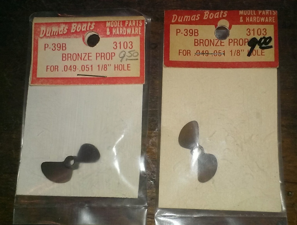

Per pg. 1, will need 24mm /  can mod the 27mm - area and blade thickness is not ideal.
Would require the Norvel .074 to run the 27mm prop near stock.
De-tongue sharpen and balance. Need to see the back of the mono to help further.
The white nylon 1/2A dumas prop is 1"x 1" can be ran in stock form insure you don't loose it.
I use a nylon locking nut. It is not drive dog friendly. Rather a simple pin.
I have a few metal 1/2A props; JG props and Dumas 1" also the white Dumas plastic ones.
The Oct 0930 can be cut down 0925 and shaped for surface running does well.
Engine unloads fast, pushes the boat on top quick and scats out of town in a hurry but total
top end speed will be less than possible via other props with more pitch.
