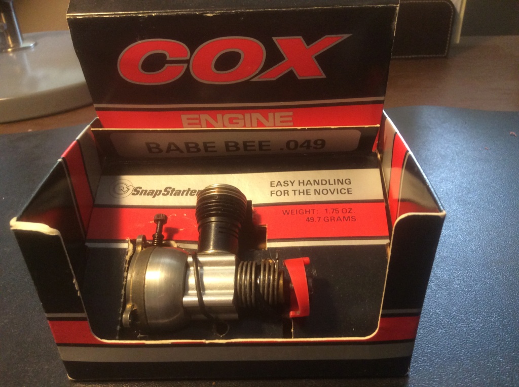

All of my engines that came with the red starter cam, were equipped with the small brass drive plate, my very first Babe Bee is one of them. Bought new in 1982 or 1983.
(Disclaimer: All these engines were originally bought new in Finland. There is a story going on that an importer bought a huge lot of Cox engines, parts and models at one time and sold them off over the next 5-10 years, so the red cam + small brass driveplate may be a short-lived or otherwise an interim design, but very common around here)

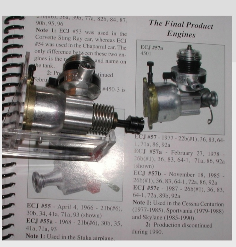

I have one that is like those that were asked about….
I got it from the Bay….I believe it is a QRC product engine that was once in a rtf …. It has no SPI…..Doesn’t have the hi compression head, But that could have been changed by previous owners….. It’s a good running engine……. Screenshot I saved …., I think photo credit is due to rsv1cox….
Advertisement for their QRC that was sold as engine only… Had the anodized parts to jazz it up….
My best guess anyway…

I think you are closer to the truth, Robert. Like in all things, there are probably deviations caused by in-stream changes with parts during production, substitutions, etc. as long as the outcome was the same.
I remember on my U.S. Gov fleet vehicle auction purchase of a low mileage 1990 Dodge D-150 pickup truck 25 years ago. It had the front radiator grill of the 1989 model, front brakes were from the 1989, but its VIN and label plate said it was a 1990 model. To keep production costs down on a government contract, I guess that Chrysler used up left over parts from the prior year model.
Fox Engine manufacturing was from what I am told by others, was always making changes in-stream.
I guess it is as the Spaniards say, "no importa." (Doesn't matter.)

George, as far as I know, the engines were imported to Finland already assembled. The shipment supposedly contained mostly engines and other ”products”, but not a lot of spare parts like screws, glowheads and such. I remember my local hobby shop having a few different engines, but spare glowheads had to be ordered... Internet has made things easier since
It looks like the ”product variant” of the QRC is indeed aluminium colour instead the more colourful separately sold versions.
BTW, here’s a picture of my first engine
The box is not original, but it came in a similar box. The glowhead has also been replaced.
