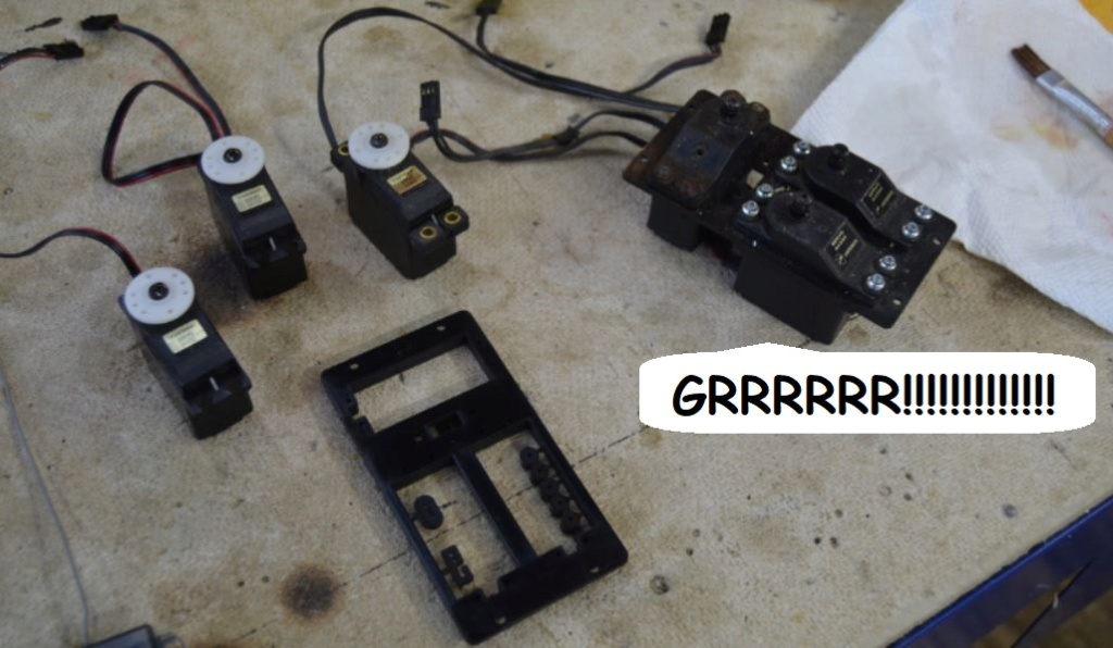

Also, it'll be getting it's commands from my new DX-10 transmitter and a new Spektrum receiver...though it won't look quite right without it's antenna dangling in the breeze. I may have to make up a fake one for nostalgic effect.
Now begins the somewhat tedious job of matching up the polarities of all these dissimilar gadgets, and hopefully not having an Electron War toast anything, new or old...

And, as much as I'd like to to take the old Kadet Mk1 to the party as-is, I've decided to replace the ancient "coffee-grinder servos" (trust me...if you heard them operate, you'd know) with almost equally ancient, but New-Old-Stock servos from my radio graveyard.

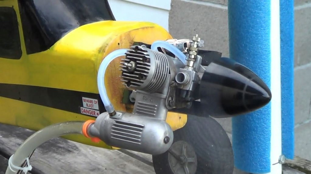

Yep...it's packing its fair share of old castor. I was able to replace its nose (the third time) by running some hard balsa sheet back to some relatively clean balsa back to the fuse's front bulkhead. Everything seems pretty tight...thanks to C.A.!
The old dog has seen some rough times down through the decades!

Mud Dabber's O.S. is a .35. I'd been calling it an "FP", all these years, but apparently, it's an older "S" model.

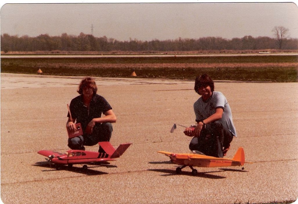

I was introduced to the O.S. brand in the mid-1970's by control line flying bud Kevin. He was the first of our bunch to fly proportional R/C, and taught me to fly with his Kadet Mk1. At the time, none of us had much experince with throttled engines...mostly throttle-band .049's and a couple McCoys.
Originally, he had a Fox .25 or some such on his plane, but could not get a dependable idle from it. The engine was new out of the box, we had new fuel, and a good tank installation, did a long long break-in, everything by-the-book, but the Fox would just not run at lower rpm's. He still flew it quite a bit, using the throttle to shut it down for dead stick landings.
He got the O.S. .35 bolted to his Kadet, and we both just stared at it on its first run. The thing idled like an electric motor, right out of the box. This literally opened up a new world for us, with super slow, main gear only touch & goes, and "propeller hanging" slow flight around the field.
We were somewhat the odd balls of the time, as everyone around us seemed obsessed with pushing Mach 2 behind some super tuned pipe monster, and here we were, "The Driving Miss Daisy" version of R/C.

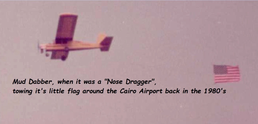

This flying is what brought me to build Mud Dabber a few years later with, of course, the venerable O.S. hauling the model into the air.

After a marathon run of fiddling around with stuff in the shop, my ancient Sig Mk1 Kadet, Mud Dabber, was suddenly ready to fly.
The winds had dropped quite a bit by late afternoon, though still giving Mud Dabber a slight quartering tailwind out of the yard...but I was feeling the MoJo, so we went for it. Both takeoffs were a bit wobbly, but the old plane managed to stay out of the cedar tree and wires lining its departure, giving me a chance to trim it at a safe altitude.
Note to Self: NEVER brag about an engine's "great performance" (in this case, Idle Performance) BEFORE some considerable test running.
It could be the tube I stuck on its muffler, the Fox Glow Plug in its head, or perhaps the idle air bleed adjustment, but whatever the cause, my "super dependable" O.S. croaked on both approaches up the chute.
One attempt was high enough to chance (successfully) continuing to a dead stick landing in the yard, while the other was an unceremonious emergency flop into the tall grass of the north pasture. Thankfully, my landlords' bull showed no interest in me OR my misplaced toy.
On the GOOD side, the washout I had twisted (once again) into its wing was an obvious improvement, with wonderful, straight-ahead stall recoveries. My good-natured ole bud was for sure back with me.
So now, a bit of running/adjusting on the stand, and we're off again for more adventures.

First engine cutout, I thought fuel starvation at top of loop, maybe a pickup problem, but the second?

Our radios were both EK Logitrol "Champion" 5-channel radios, and never let us down. I got mine from Tower Hobbies in 1976, while Kevin got his used from a guy in Cape. I have to smile (or maybe cringe) at the memory of plugging in the "wall tick" chargers the night before, and just "estimating" their remaining charge as we flew through the day.
Our local General Store actually stocked the Everyready brand of "telephone batteries", and it was only when these went unavailable that I finally went to a power panel. After wasting money on a couple hobby batteries, I totally quite using them. Don't know if it was just my examples or not, but they seemed to go dead in a very short time, where my beloved old telephone batteries could be faded and leaking chemicals, and STILL start a plane.

I'm a bit suspicious of the airbleed being clogged with goop, so may look there first. "Back in the day" the airbleed adjustment was somewhat of a VooDoo item, and I avoided messing with it for fear of causing problems. Well, "problem" is my middle name now, so it'll get messed with today!
AND...maybe the old O.S. might like a 9x6 in place of the 10x6 it's currently swinging. Also got some O.S. glow plugs, so there's that.
