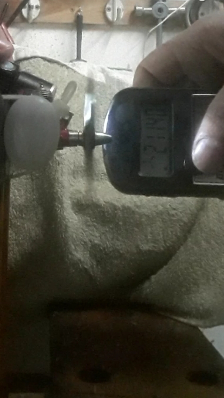

My friend András, here is my experience with Cox .020 and three-blade cos propeller for .020
Ambient temperature: 14 degrees Celsius
Humidity: 31%
Propeller: https://coxengines.ca/propellers/cox--020-propeller-3-125-x-2-5-3-blade.html
Fuel tank: 12ccm
Nitre: 30%
Max RPM: 21140
Time: 05:47.97 minutes
Another Cox .010 converted to R/C & P-51 Mustang. (Flight page 5) - Page 4 Img-2191
Another Cox .010 converted to R/C & P-51 Mustang. (Flight page 5) - Page 4 Screen27
Another Cox .010 converted to R/C & P-51 Mustang. (Flight page 5) - Page 4 Screen28
