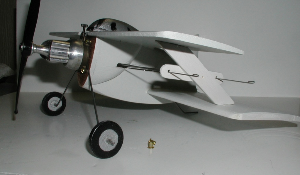

Post  rsv1cox Fri Aug 12, 2022 6:09 pm
Done except for laying a bead of epoxy around the strut bases and lead-out guide. Forgot to add the grommets before bending the lead out music wires. Tough stuff, they don't bend easily. I will have to solder the ends closed as I could not loop the pre-assembly. When finished I will locate the CG and weigh. Kind of eager to find out what it will be.
Made the wheels out of luan, fuel tubing substitutes for collars. I decided to leave the bell crank assembly open rather than fill it in. There is no picture of the original builders installation, so he may have left it open also. If you squint really hard you could imagine a jackscrew assembly (I used a 3/48 machine screw) like they use on airliners to operate the elevator and flaps and slats. Smile

Pictures of the original suggest a beige color, could the lighting or camera? I chose light gray, it's the Silver Lining not the beige lining.

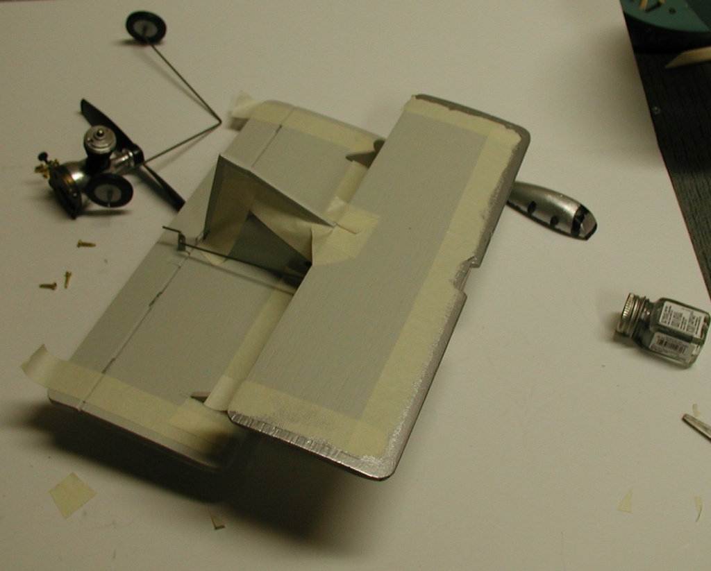

A little sloppy but mostly done except for the Silver Lining stencil. Got to think long and hard before I do that one. May wait for my son. I'm thinking nuts, but I have an alternative standing by.

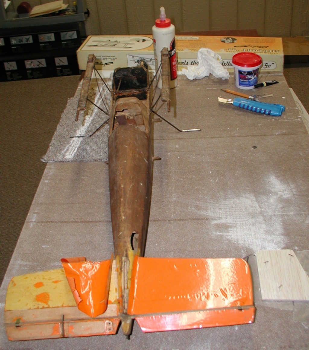

It reminds me a bit of my Strutz Aircrate that I rebuilt from a consignment shop purchase. I had the plan blown up to scale at Staples.
https://outerzone.co.uk/plan_details.asp?ID=2415
The "Silver Lining" a start - Page 4 Strutz11
It had an Escapement system installed but no transmitter. I converted it to control line. Never flown but capable. Has an Enya .09.

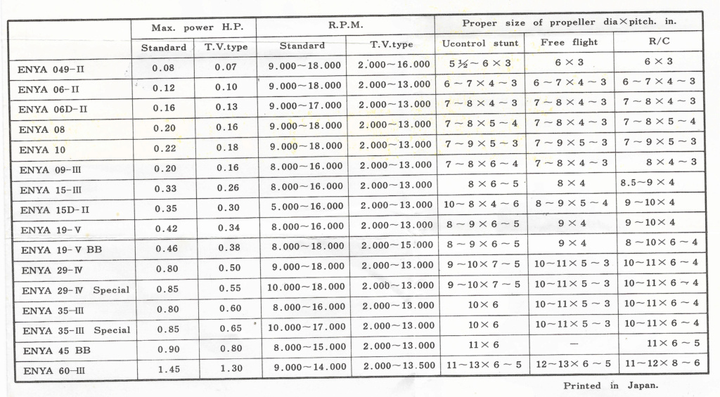

If I had thought Robert, I would have sent along the instructions.  Copies of pertinant parts here: Click to get a better picture.

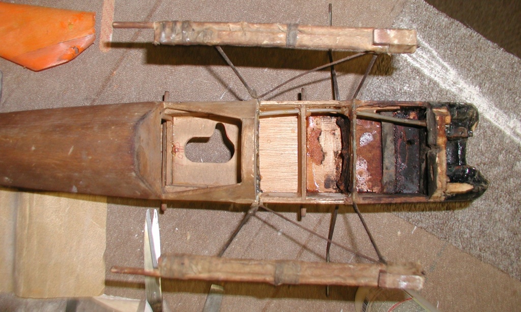

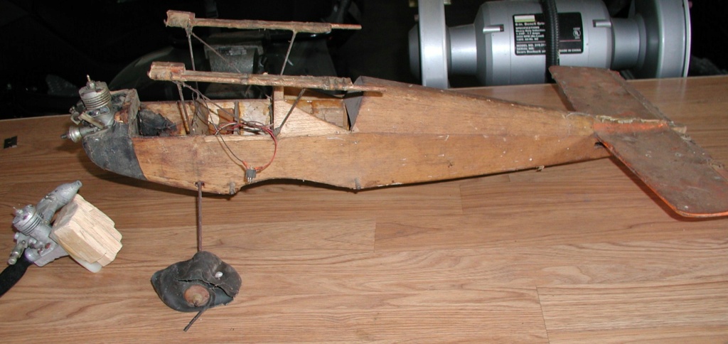

Somewhere I have a picture of the engine when it was in the airplane, an Enya .09.  You would not believe it.  I have never seen an Enya engine that beat before.  Got to find that picture!
Found it and several more:  Over seven years ago, perhaps the most fun that I have had rebuilding a model airplane.
