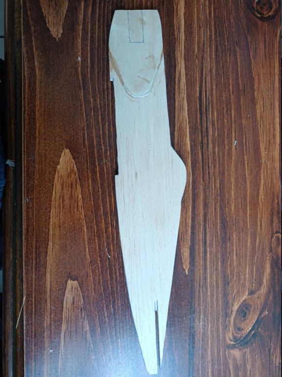

One of the airplanes of all time that I have liked the most is without a doubt the F4U-4 Corsair, in fact, I have an E-flite Corsair with an electric radio control engine and another with a nitro engine with an O.S. .55 and a good friend of mine, Rafael Castillo Martinez has a Top Flite giant Corsair with a 60cc OS gas engine, but I hadn't flown a line controlled Corsair.
Like many of the old-school model airplane fans, I started out flying line-controlled airplanes, which is why I still like to fly this type of model airplane.
So, without further ado, download from Outerzone the plan to build a Corsair profiled for a Cox Tee Dee .049 engine (the plan is for a Cox Pee Wee .020 engine so I took some liberties to modify it a bit ), here is a brief review in photographs:F4U-4 Corsair control line 2_temp10

Actually, I just printed the plan and built it as is; the city of San Luis Potosí is at a height of 1864 meters above sea level, so I doubt that with a Cox Pee Wee .020 engine it would even fly at that height, all I did was modify the nose of the plane to adapt it to the Cox Tee Dee .049 engine and I put two reinforcements in the union of the dihedral/anhedral of the wings instead of one, the thickness of the wood was passed to the following measurement:
Fuselage: from 3/16” to ¼”
Wing: from 1/8” to 3/16”
Stabilizer/elevator and rudder: from 1/16” to 1/8”
Greetings and thank you very much for your interest.
