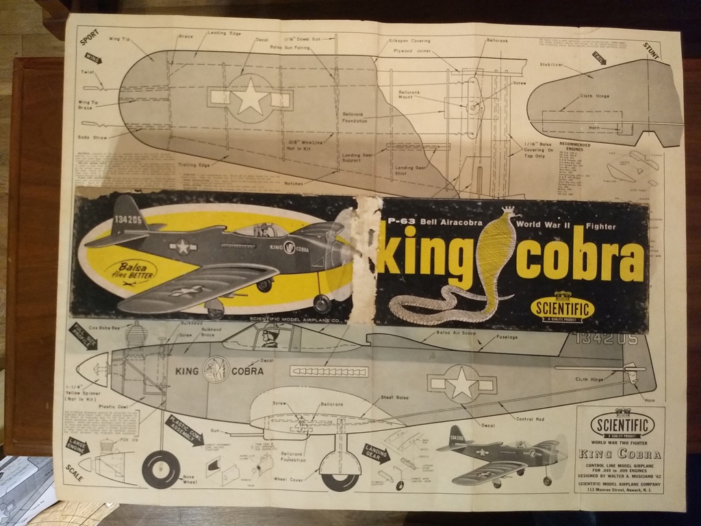

I didn't think I'd post this acquisition yet, but enough interest was generated as I stepped all over Bob's junkbox post...so here we go!
This kit popped up on eBay several weeks ago. I shot a quick email to Dave Cowell of DPCModels to see if he wanted it in his offerings, and he replied faster than I typed the email.
So I waited and watched the auction until the appointed ending time and sniped it for not enough to worry about how to share the goodies. The auction showed a box with a bit of tape damage, complete plastics, some woods but no wing, and the plan sheet.
First order of business was to inventory what I got. Then the plan sheet went to work with me one morning so I could scan it on our large format scanner. The smaller parts were then laid-out on 1/4" quadrille paper and scanned at home. With a 100% full-size reprint of the plan sheet and the quadrille/small parts validated by overlaying originals on copies, the digital parts were sent to Dave.

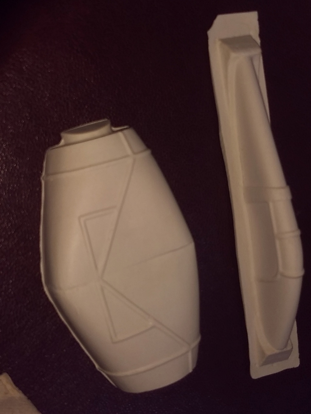

Then the summer ran away with other things. However, this weekend I just found enough time to begin casting bucks from the terribly dry, cracking plastics. Exhaust pipes took two tries. The canopy popped out easily. The money-piece was a very delicate operation, with the follow-on pictures showing how I had to buttress the tired plastic into a mold strong enough to handle. Fortunately it took only one try with the canopy and cowl. I'll weigh the parts over the next few days. The bucks will be sent once they stop losing water-weight as measured on my digital scale. More to follow shortly.

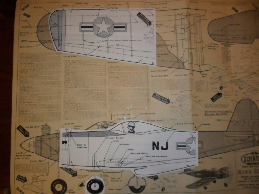

So here are the similarities between the King Cobra and the Super Mustang. The Super Mustang was printed in fresh, new paper, and then placed over the sepia-toned (well, old) plan sheet.
Wings are the same except for two things. The tips are different, and there are two ribs in each P-63 wing that have notches cut for the wing-mounted landing gear. Side views of both planes show the same root rib shape. The overhead views show same length ribs, leading edge, trailing edge. Recreating the missing wing parts will require no more effort than tracing the Super Mustang wings, and then engineering the landing gear mounts and notches. No big deal there.

I did the posts too quickly, and for that I apologize. What you are looking at in white are the plaster bucks going to Dave Cowell. The exhaust plastics and engine cowl didn't fair very well making the bucks. I actually had to repair the engine cowl before the pour. The kit canopy is clear, and still quite useable as is...again, you see bucks above.

Jim, those Scientific plans and your overlays are terrific. They really illustrate the similarities between the two. I'm nutz over Scientific plans saving most of my old builds. I wish that I had saved them all.
Posts : 8990

Plaster bucks went to Dave Cowell, DCP Models/AeroWerkes last weekend. Hopefully we have a new kit coming to market soon!
I asked to have one of the first, if not the prototype kit. This should turn out very well.
