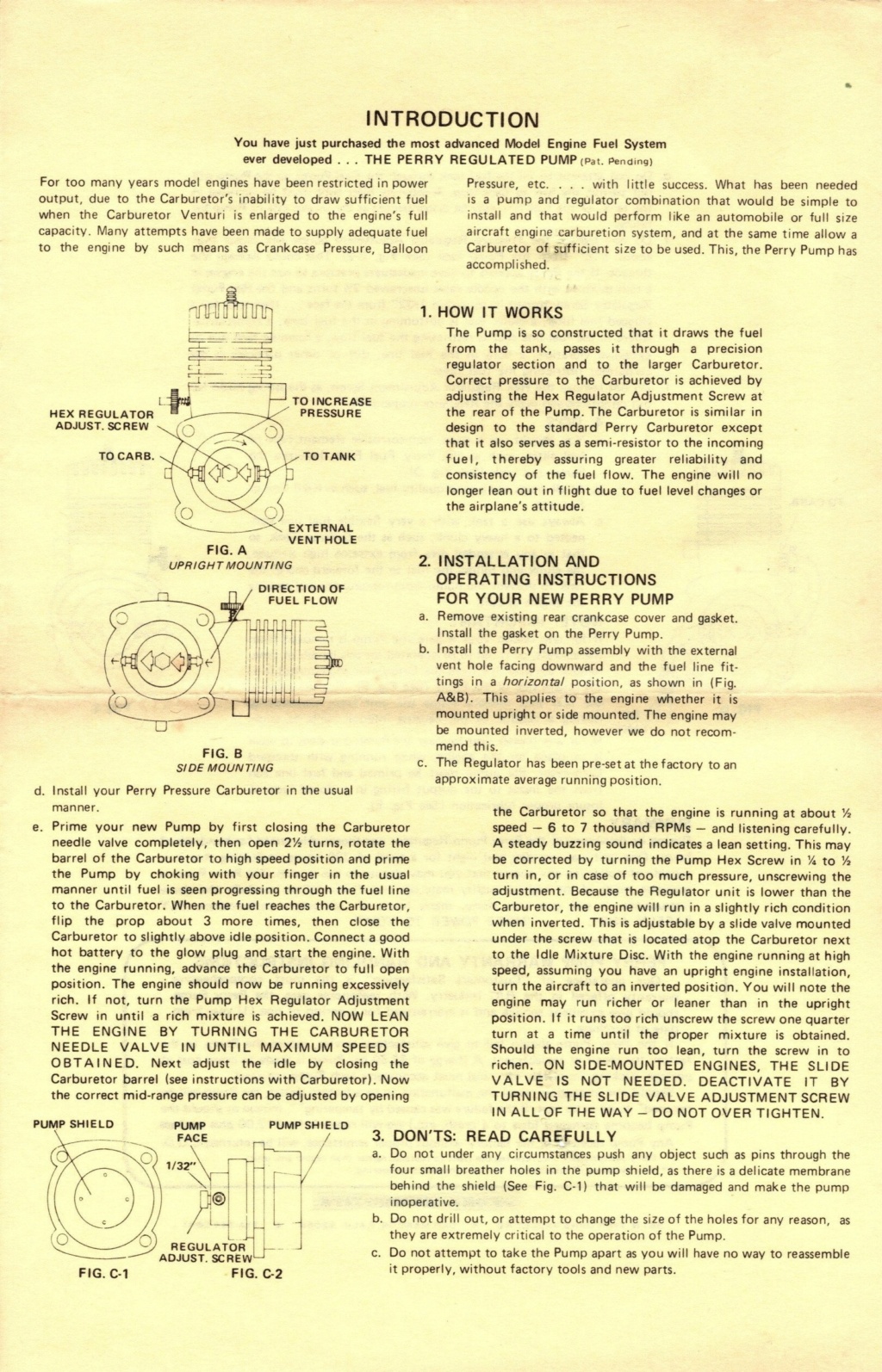

Yesterday I received more Enya operating instructions for the Enya 60XF-III and 60XF-4 (with Perry Pump) from Ken Enya.
What don't I understand is that the Perry Pump engine can run on gas? As Ken had that (gas) in the subject title of his email?
I am guessing that it could run on "white" gas and caster/synthetic oil?
Anyone has an answer?
So, below are the instructions I received from Ken Enya.

Perry Pump instructions:
