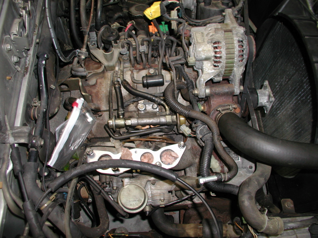

I'm going to call this Mazda Calculus because I'm "filling the hole". Smile

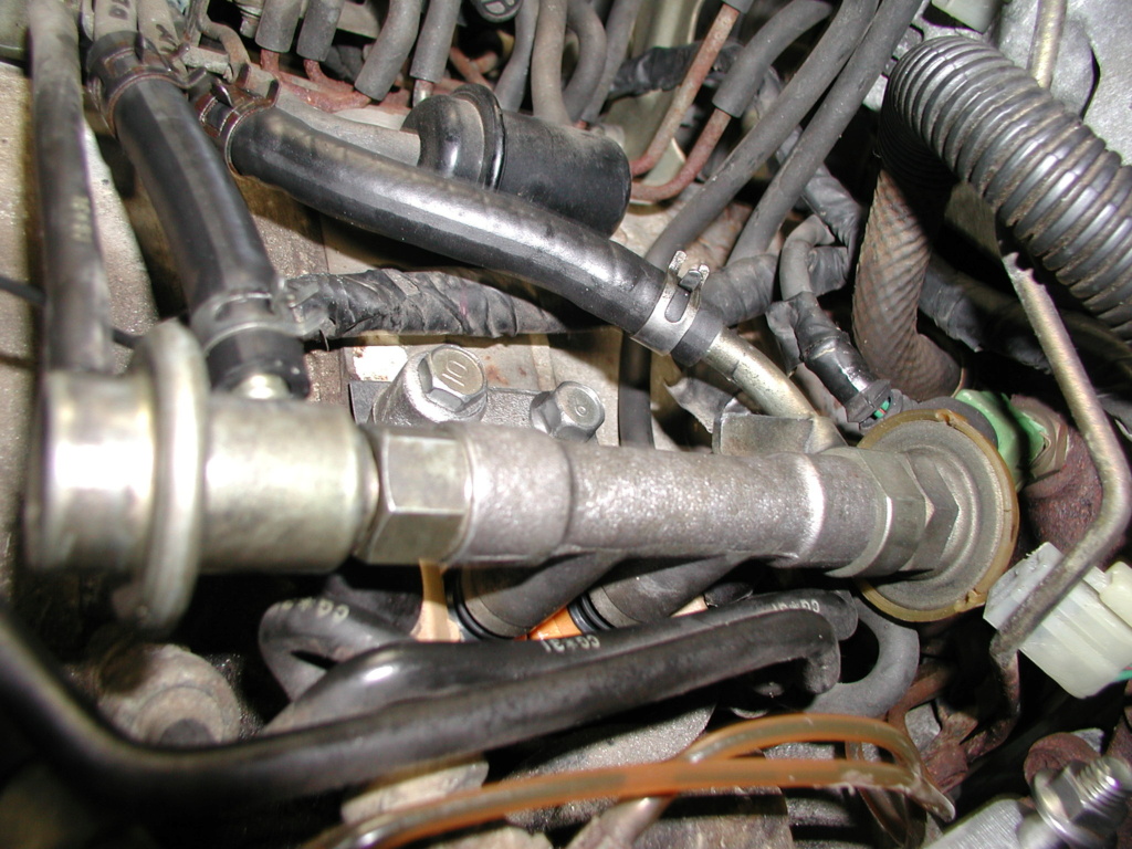

Dropped this intake manifold-throttle body-dynamic chamber assembly down onto the engines cavitity yesterday. Hitched up about a dozen tubes and connections but yet to torque everything down. Happens this morning when I attach the air filter assembly. Then it's ready to start..........60/40 chance I figure.
My Mazda RX-7GSL-SE build log with the occasional balsa inclusion - Page 7 P1015130
My Mazda RX-7GSL-SE build log with the occasional balsa inclusion - Page 7 P1015131
My Mazda RX-7GSL-SE build log with the occasional balsa inclusion - Page 7 P1015132

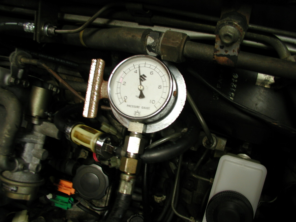

Fuel rail make it happener...........( Motor Trend channel - Roadworty Rescues)

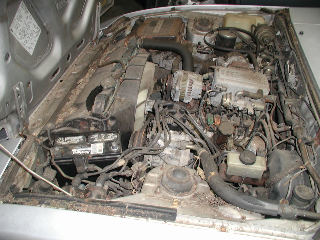

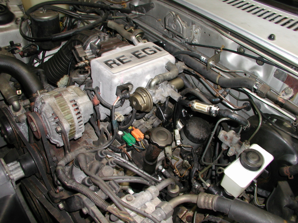

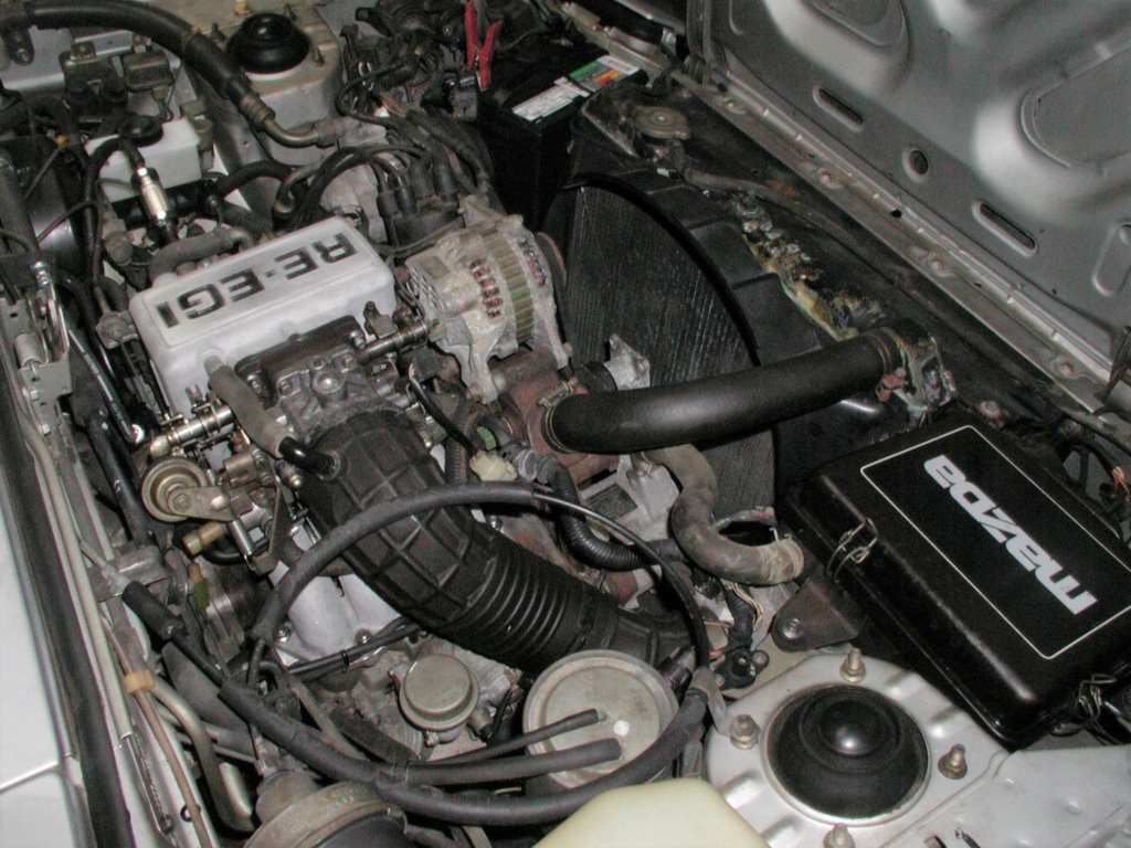

Filled the last hole. The engine compartment is back to as received minus all the gook, leaves and mice nests.
My Mazda RX-7GSL-SE build log with the occasional balsa inclusion - Page 7 P1015140
My Mazda RX-7GSL-SE build log with the occasional balsa inclusion - Page 7 P1015142
My Mazda RX-7GSL-SE build log with the occasional balsa inclusion - Page 7 P1015141
But oh, oh....spare parts. Go somewhere on the throttle assembly. Rusty and hanging free, I will have to check my old pictures to see where they go.

Post  pman1111 Fri Mar 31, 2023 7:01 pm
My Mazda RX-7GSL-SE build log with the occasional balsa inclusion - Page 7 P1015143
[/quote]
The two bolts with the flange on them go to a "wire" style hose clamps the Japanese auto makers are fond of using, did you replace some hose clamps?

Post  rsv1cox Sat Apr 01, 2023 7:06 am
Good catch.
Yes, I went to my pictures yesterday and found where they all went. The funny bolts do go to the wired clamps that were on the lines to the water choke. I had traditional spares and replaced them. The clip went to a relay cable that is part of the emissions control, and the insulated cable clip goes on an intake manifold bolt.

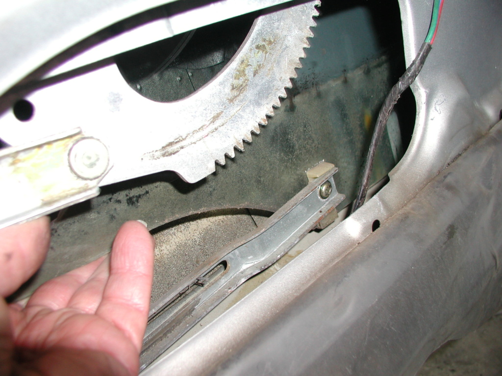

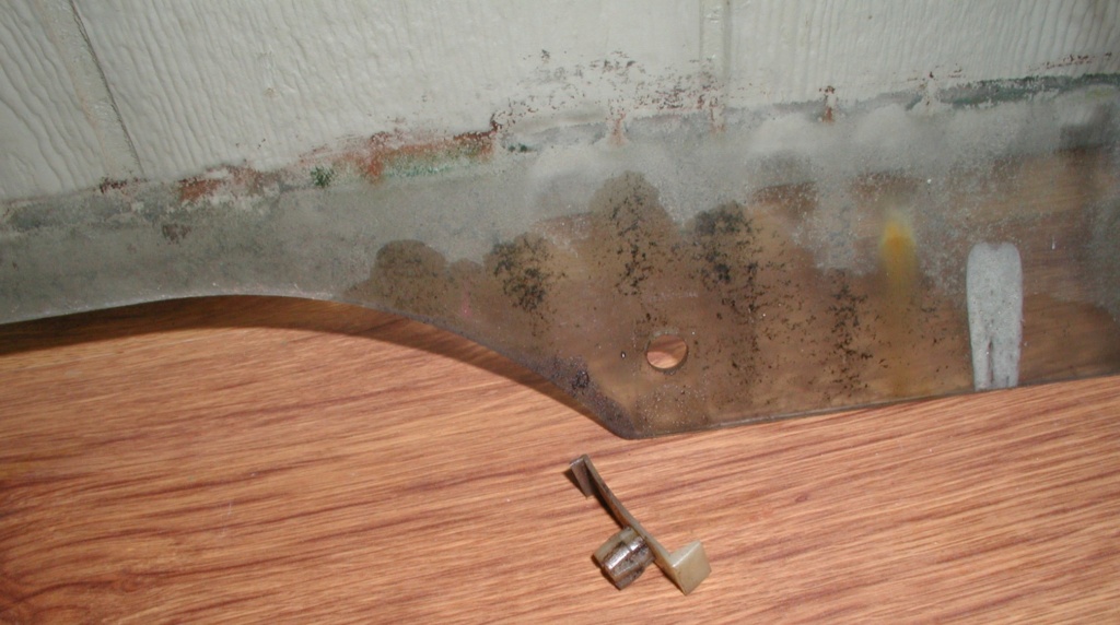

Disassembly continues with some signs of hope.
Pucker time removing the window glass.  One little slip.  Nylon clips had to be removed before the glass could the lifted out of the door and I had no idea how to do it.  I thought they were U clips but no, just expansions through the glass.  A box cutter blade removed them
My Mazda RX-7GSL-SE build log with the occasional balsa inclusion - Page 7 P1015164
My Mazda RX-7GSL-SE build log with the occasional balsa inclusion - Page 7 P1015163
My Mazda RX-7GSL-SE build log with the occasional balsa inclusion - Page 7 P1015167
Top of door weatherstrip was dried and cracked, pried it out.  I have new replacements.
My Mazda RX-7GSL-SE build log with the occasional balsa inclusion - Page 7 P1015165
My Mazda RX-7GSL-SE build log with the occasional balsa inclusion - Page 7 P1015166
My Mazda RX-7GSL-SE build log with the occasional balsa inclusion - Page 7 P1015168
Glimmers of hope, starting some put back togethers......... Drivers side door trim was bent like a pretzel and tossed in the rear hatch.  Heat flattened but did not remove the curve so I built a jig.

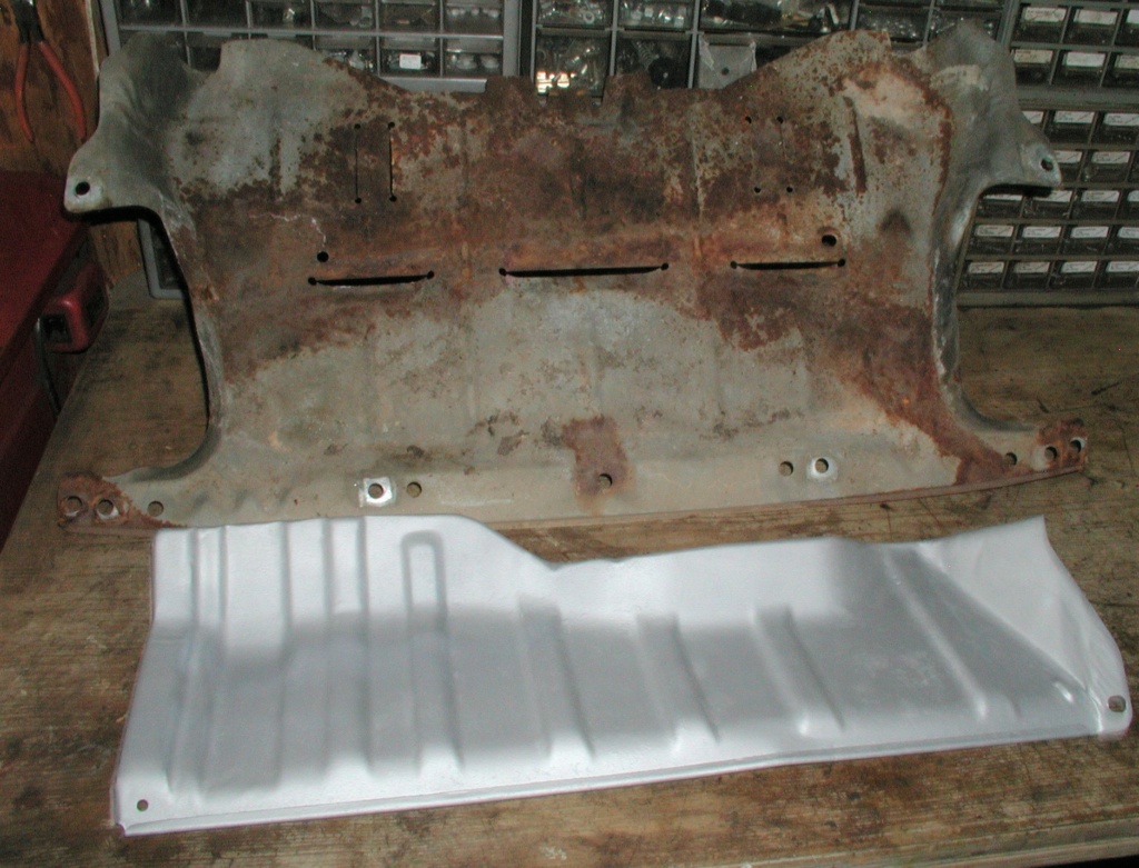

Under body shields. Wire brush, wire wheel, sandpaper, sandblasting.

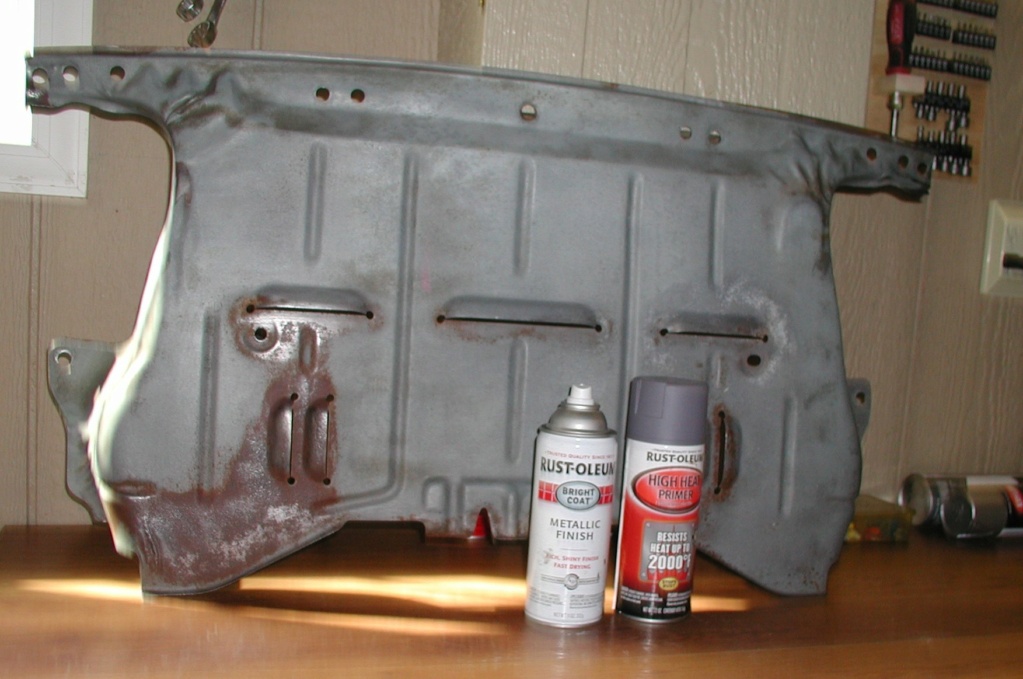

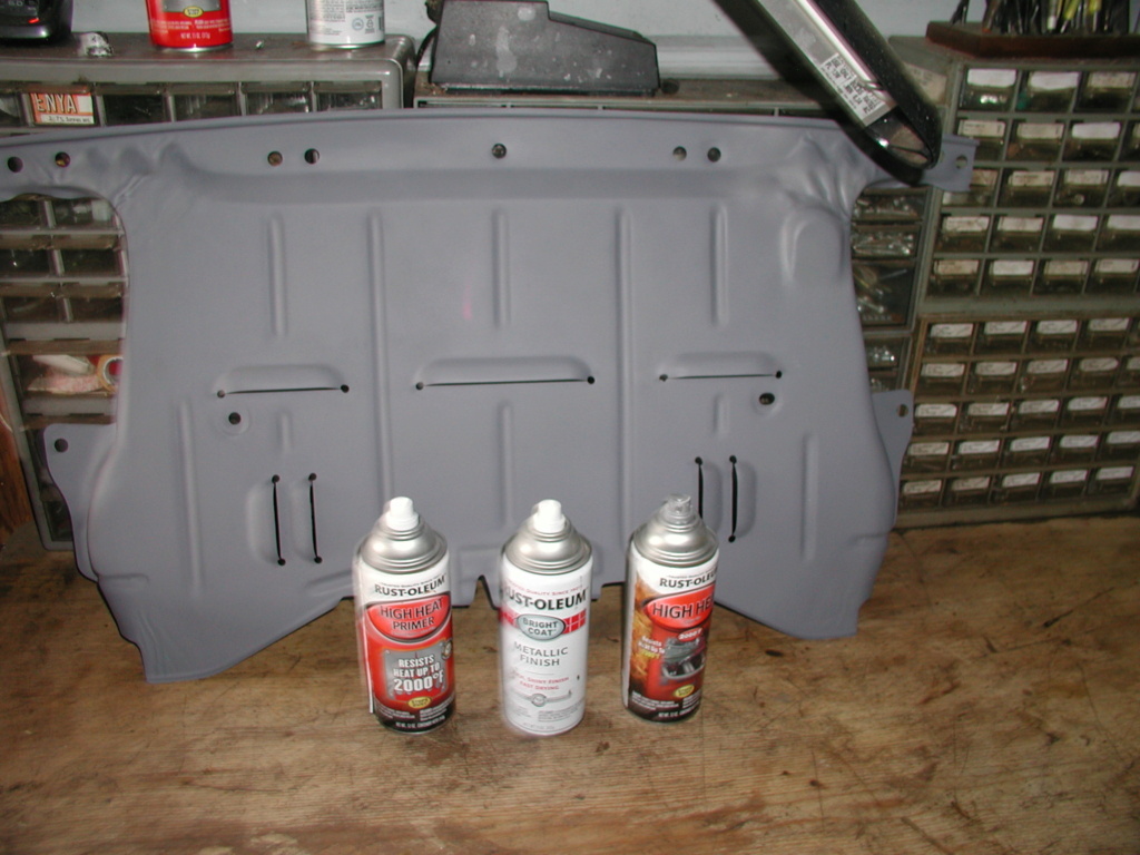

Thanks Jim,  They are pressed mild steel panels natural and unpainted but perhaps treated in some way..  I'm using up all my old half empty spray cans knowing that I'm not restoring an old Packard or Mercedes.  More like painting a moustache on the Mona Lisa. Were it a better example I would spend more time, effort and money on it.
Spent most of the morning cleaning up the guard under the engine.  Usually these are oil soaked and not rusty.  Mazda did too good a job sealing the engine and this one was quite rusty.  Gave up on sandblasting and used Comet, dish soap, wire brush, and a rust remover (like a steel wool pad on steroids) to get much of it.  Hoping that Rust-oleum will do the rest.
One more shield to go, a long one that protects the catalitic converter and the exhaust pipes.  Yes, a long time before they are put back on.
Misty humid day today.  Have to wait before I paint it.

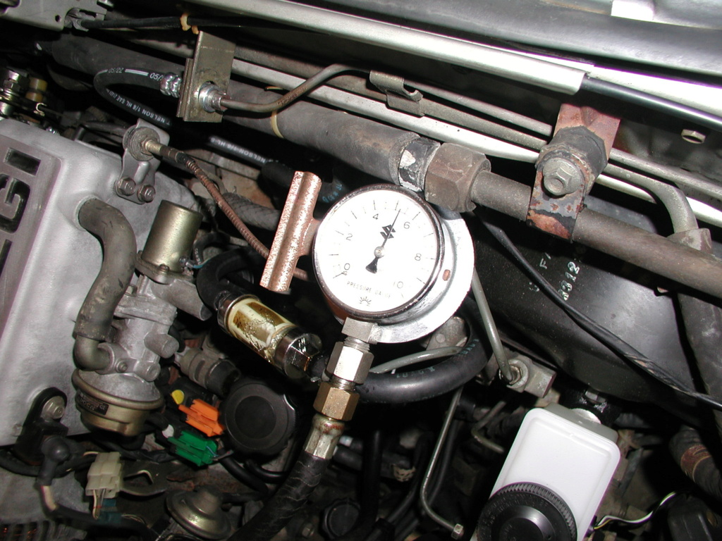

Post  rsv1cox Fri Apr 07, 2023 6:40 am
"That's pretty wild the way the fuel cycles through the system until needed."
Amazed me too Eric.  I'm not familiar with these new-fangled fuel injection systems.  Smile
That fuel rail is about 1/2" in diameter and fuel rushess through it like Man-O-War at the Kentucky Derby.  Thinking about it, I'm not sure that's a great idea but fuel rails are common in fuel injection systems.
Sun came out yesterday PM so I painted the other splash pan.  Two down one to go.
My Mazda RX-7GSL-SE build log with the occasional balsa inclusion - Page 7 P1015179
My Mazda RX-7GSL-SE build log with the occasional balsa inclusion - Page 7 P1015178

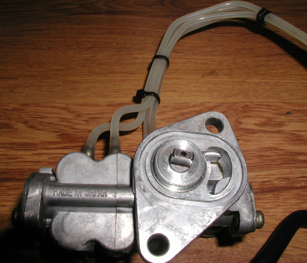

On the down side, UPS delivered my oil injection parts yesterday.  Too bad they delivered them to someone else.  Ever try to lodge a claim with UPS.  A trip to the dentist is a better experience.  Never did achieve success.  They send you on a circle like a dog chasing his tail.

It is interesting that all electronic fuel injection (EFI) systems do that recirculating. I think it may be related to having sufficient fuel available during highest demand (I.e., lead foot, pedal to the metal Laughing ). Stand fuel systems, carburetor(s) have a built in reservoir, it's float valve keeps it topped off. You don't have this with EFI.

GallopingGhostler wrote:It is interesting that all electronic fuel injection (EFI) systems do that recirculating. I think it may be related to having sufficient fuel available during highest demand (I.e., lead foot, pedal to the metal Laughing ). Stand fuel systems, carburetor(s) have a built in reservoir, it's float valve keeps it topped off. You don't have this with EFI.

On the bright side a good neighbor delivered my mis-sent oil injectors this morning while I was out shopping. Don't these UPS drivers have GPS!!!!

But the main reason for my reply. I have a can of very similar spray paint. The cap indicates a very bright, almost chrome-like finish. It was purchased to repair the reflectors in the TR6 backlights. I was sorely disappointed to spray a dark silver on my freshly prepped assemblies, but I needed to get done "now."
I will say it was an acceptable color for my oldest son's Ninja brake pedal. Yours looks a lot brighter! Great job on the belly plates.
My Mazda RX-7GSL-SE build log with the occasional balsa inclusion - Page 7 Img_2130

Post  rsv1cox Fri Apr 07, 2023 3:22 pm
I have used three different Rust-oleum spray cans on these panels, a primer and two different applications both different in shade that is more pronounced than is shown in these pictures.  The can in the middle is the one I used to finish this panel I may have to top coat it with what remains in the other can to match.  The loft is a great place to stick these things until needed.
My Mazda RX-7GSL-SE build log with the occasional balsa inclusion - Page 7 P1015185
My Mazda RX-7GSL-SE build log with the occasional balsa inclusion - Page 7 P1015186
The fellow in Georgia that sold me the intake manifold/throttle body/dynamic chamber combo has turned out to be a friend and a valuable source of information about these early RX-7's.  He just sent me an oil pressure gauge that connects directly to the engine and a set of proper oil injectors when he noticed that the ones I got from the ebay vendor were not correct for my year.  Got both today thanks to a good neighbor.
My Mazda RX-7GSL-SE build log with the occasional balsa inclusion - Page 7 P1015187
My Mazda RX-7GSL-SE build log with the occasional balsa inclusion - Page 7 P1015188
My Mazda RX-7GSL-SE build log with the occasional balsa inclusion - Page 7 P1015191
The parts vendor did a great job cleaning them up.  Looks like a mechanical pump with a rectangular drive for the impeller.

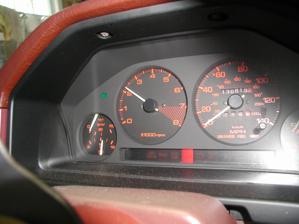

I hitched up the oil pressure gauge that a friend in Georgia sent me.  Not just good oil pressure but great pressure that converts to 60/72 PSI.  On the high side of normal for these.
My Mazda RX-7GSL-SE build log with the occasional balsa inclusion - Page 7 P1015193
My Mazda RX-7GSL-SE build log with the occasional balsa inclusion - Page 7 P1015194
But.........I removed it and installed the new OP sender and the cars interior gauge is still not working.
My Mazda RX-7GSL-SE build log with the occasional balsa inclusion - Page 7 P1015195

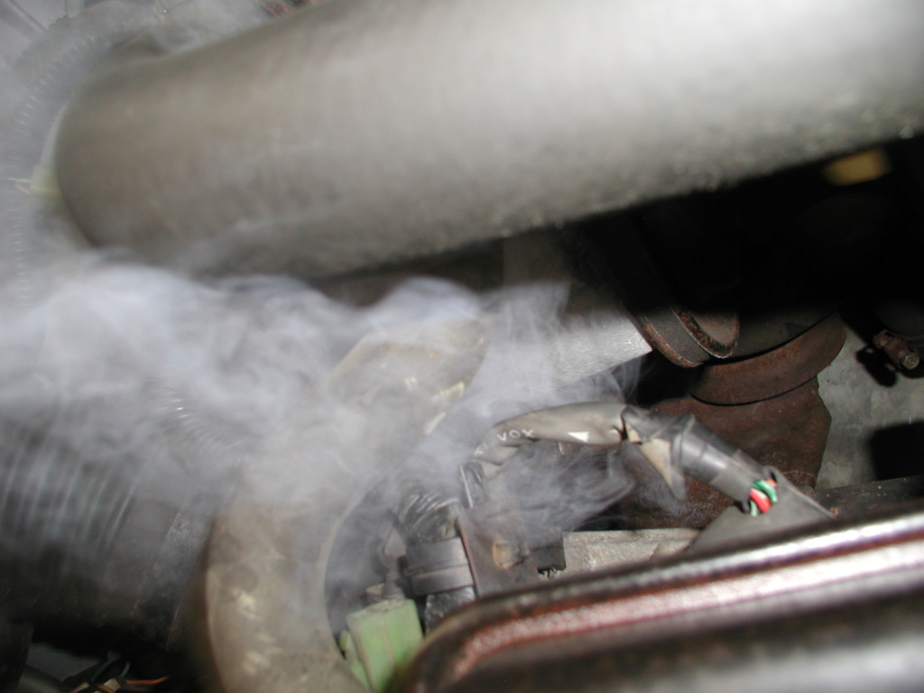

Warming the engine up I'm getting gobs of smoke.  I think a mouse had built a nest somewhere in or around the exhaust manifold either that or leaves.  Leaves were everywhere in this car.
My Mazda RX-7GSL-SE build log with the occasional balsa inclusion - Page 7 P1015198
My Mazda RX-7GSL-SE build log with the occasional balsa inclusion - Page 7 P1015196
Also got my second RX-7 injury.  Boo Hoo
My Mazda RX-7GSL-SE build log with the occasional balsa inclusion - Page 7 P1015197

That’s great news on the oil pressure Bob, Looks like the motor is going to be pretty solid Very Happy …..Hopefully to get the dash gauge to work is just a wiring issue that can be easily found…..Maybe you could try an ohm meter at the wiring for the sending unit and see if you get anything and trace from there….. Check the sending unit it too, I’m guessing should have variable resistance as pressure rises and falls…. Quit burnin yourself compadre!!! Very Happy …. But have fun with your project…. Making good progress… Very Happy

We checked the gauge by shorting it out and it deflects. Perhaps not the best check. Still looking into it. Hard to believe that we have two bad senders.
Light of day. Learned that the power steering works something I have been wondering about. Starts right off, no choke or foot throttle. Less smoke today. Mickey is being cremated in stages.

Cleaned up and painted more panels. Loft is getting crowded.
My Mazda RX-7GSL-SE build log with the occasional balsa inclusion - Page 7 P1015203
My Mazda RX-7GSL-SE build log with the occasional balsa inclusion - Page 7 P1015202
My Mazda RX-7GSL-SE build log with the occasional balsa inclusion - Page 7 P1015204

If the gauge deflects from a straight voltage application, That’s a good thing…. I think you mentioned you were on a Mazda forum and have a buddy or two that knows some things, Those probably will get you going the right direction….. My knee jerk reaction without knowing much would be to try and put some regulated air pressure on the sensor and see if you can get a change in resistance (hi and lo pressure) on the contacts… Just be careful on too much hi pressure….
Posts : 768
My Mazda RX-7GSL-SE build log with the occasional balsa inclusion - Page 7 Empty Re: My Mazda RX-7GSL-SE build log with the occasional balsa inclusion
Post  GallopingGhostler Sun Apr 09, 2023 5:21 pm
You should be able to test the sending unit with a simple multimeter set to resistance setting. Wire off and engine off, it will have a set resistance. Some have it where when the oil pressure increases, so does the resistance. Others, it is the opposite, which is more likely. Depending on how wired, if oil gauge is like an Ammeter (or Milliammeter), then zero oil pressure, sensor is in a highest resistance state (almost no current through oil meter). With oil pressurizing the sensor, it will drop in resistance (increased current indicating higher oil pressure).
Example test, http://www.marshallinstruments.com/faqs/detail.cfm?id=34 Marshall Auto Gauges: How can I troubleshoot my electric oil pressure gauge?
Your Mazda Owner's Club or group should have someone who knows what he is doing, and can advise accordingly, if your manual does not outline a testing procedure.
