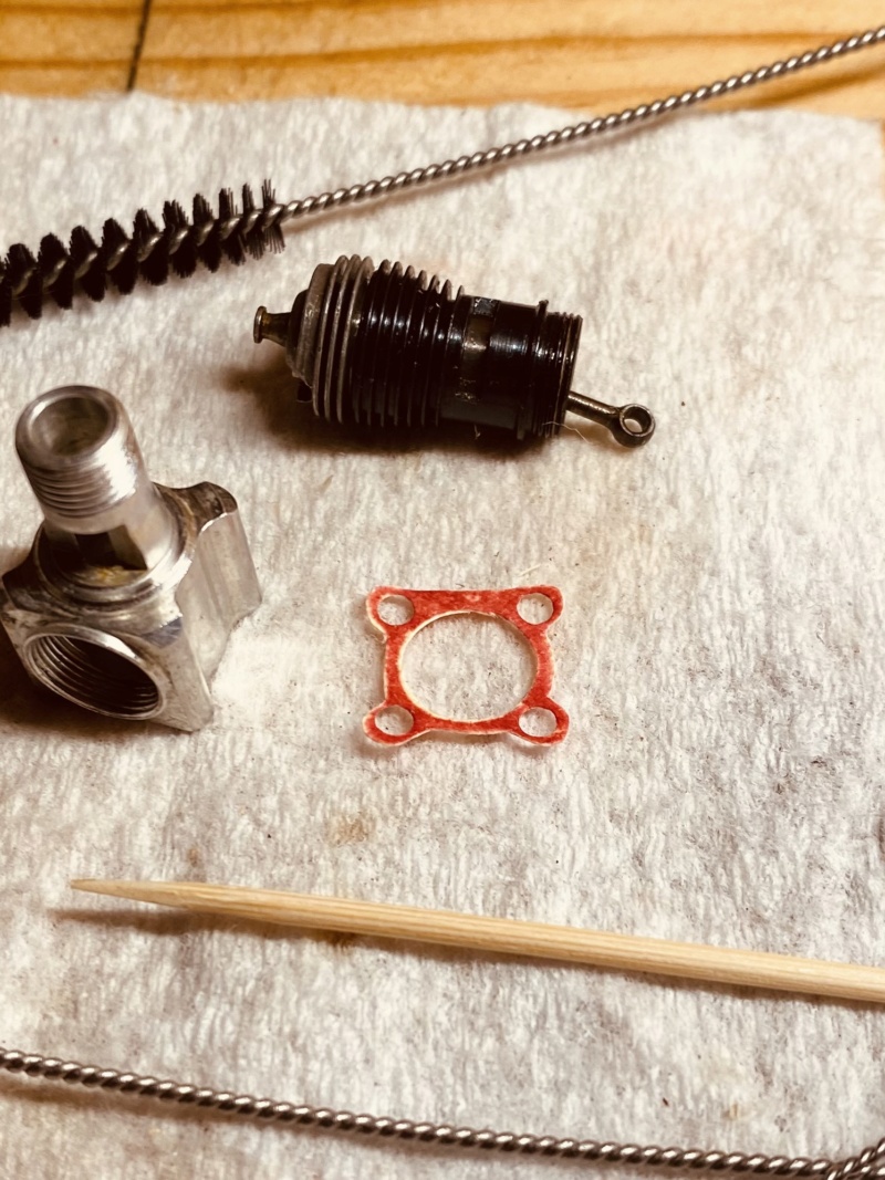

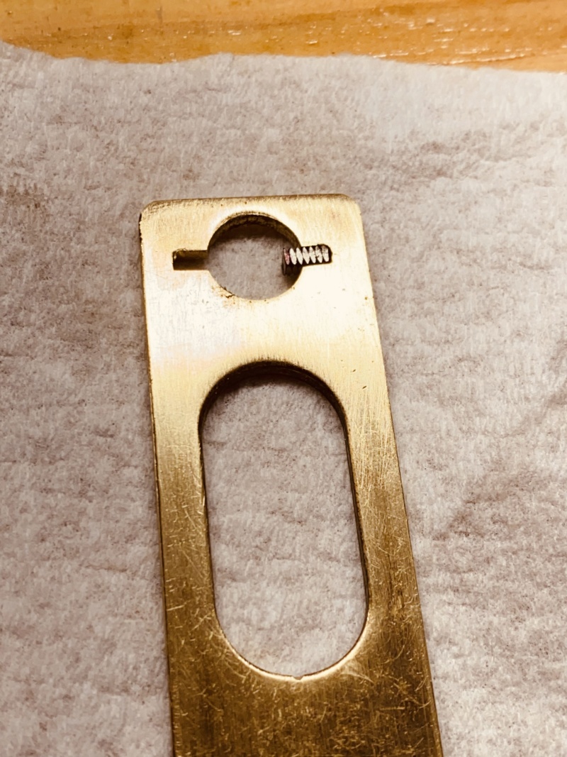

I wanted to take it apart but didn’t have any .010 tools so made some in Wood Bee machine shop….

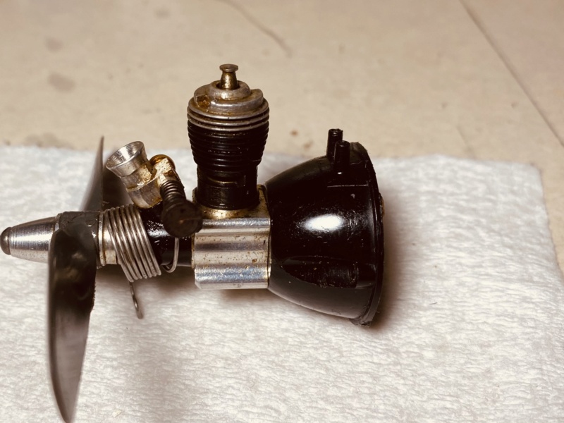

Was gooed pretty good inside and the needle locked in good…. Heat and gentle teasing finally got it apart…. Glow head lit so try for a run??
No crankcase gasket!!…. Sticky note paper to the rescue!!! Boiled all the plastic and the prop…Carb body didn’t want to go back on until softened a little….
She fired off!!….Took it kind of easy…. Piston needs a reset…. I’ll order the right tools and a few spare parts….What a neat little engine

Congrats Robert, this lil gem got finally in caring hands! Its internal was terrible with that goo caked on the piston.
Tee dee 010- s came from the factory with no gasket between the crankcase and tank. The plastic tank was considered smooth and even enough to seal well. Of course adding a home made gasket will only make it safer against air leakage.
I saw that devarnisher brush on one of your photos. I have given up using it for fears of unwanted cylinder material loss even if used only by screwing it in with no axial, just tangential motion.
I use cold grease remover spray for kitchen appliances, instead. Put a few drops on a swab or ear bud and loosen up the varnish on the cylinder, then clean it with nail polish remover/acetone I snitch from my wife.
Good luck with this fantastic engine. For the ease and safety of its NV setting I repurposed a medical needle cap; only for setting it then of course I pull it off before launching the plane

congratulations on the first .010 and the run !! They really are amazing ! First time i ran one i thought ,it sounds like a toy LOL and then after spinning it up relised the precision craftmanship !
Enjoy !

Thanks Mauricio!! The tools were fun to make too….The “teeth” for the glow head wrench were 4-40 hardened machine screws that I ground flat sections on then soldered into the old brass door hardware…It gets a very positive grip on the head…. The Venturi wrench was brass from an old office name plate….. The wood block with the bamboo dowels helped get the front retaining nut off…

Friend! That idea of the threaded and filed screw there is great!!!, great, great!
You have just helped me to give an idea of a tool that I have to make myself!... you are what inspired me in this case... you will have news!
