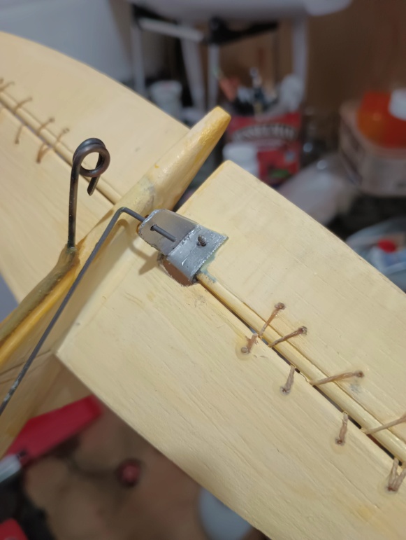

Post  getback Fri Jan 13, 2023 6:46 am
Your Baby looks really good , but i would suggest a pushrod guide to keep the wire from flexing . I had a bad issue with a plane that would not fly right only because of this . Just saying . This can bee done easily with a paper clip cut to make a horseshoe and pushed into the balsa with CA dab.

Post  944_Jim Mon Jan 16, 2023 7:57 pm
Free answer for what it is worth:
License plates in Mississippi are made of light gauge aluminum. Last year's license plates become control horns for the next five years. Note the offset in the hand drawn images. One shows the pushrod hole right under where folds would put the pushrod just under the hinge line. The others would move the pushrod hole away from the hinge line. Make the templates in cardboard first, and test fit on control surfaces. Then use a tongue depressor to wrap/fold the aluminum as required. That prevents using/crushing the elevator.
The very frugal, penny-killing Jim

Help needed with beginner baby ringmaster - Page 2 Empty Re: Help needed with beginner baby ringmaster
Post  GallopingGhostler Mon Jan 16, 2023 8:34 pm
That is using the noggin', Jim, very creative and resourceful. Bob @rsv1cox is reusing an aluminum freeze plug for an OS Graupner .30 Wankel engine mount.
I did similarly, using universal plumbing pipe hanger strap stripped down to a third its width for an Enya .15-III TV muffler strap.
Used a section of leftover synthetic decking as a standoff for a motorcycle trailer license plate bracket light. On wife's Dodge Journey, they used a really cheap stamped sheet metal +12V battery clamp.
