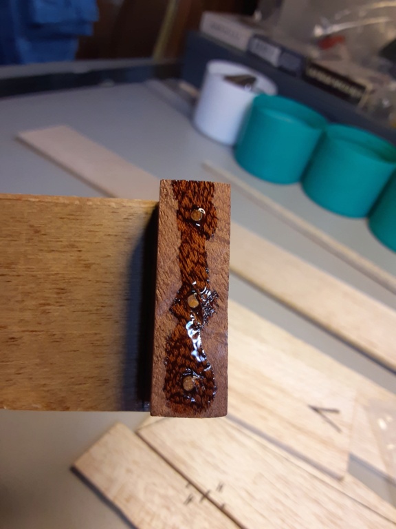

Yea.. so I mentioned that I'm pretty sure that CEF member New222 "Chancey" gave me this idea for "pinning" my engine-mount blocks through the fuse, for added strength. I had some round birch toothpicks for just such a purpose. Their diameter is .078" (approx. 2mm).. so I cut the point-tapers off three of them and drilled-through my hardwood blocks with a #47 (.078") drill... using my drill-press.
A tight fit...
Got the modeling bug this past weekend - Page 3 Tbd1-e12
A few light taps with my little nylon-faced hammer.. and the hardwood "pins" sank nicely down through and bottomed-out on my work table.
Got the modeling bug this past weekend - Page 3 Tbd1-e13
I placed a few drops of thin CA glue around each pin on both sides..
Got the modeling bug this past weekend - Page 3 Tbd1-e14
... then I "puffed" some bicarbonate of soda.. using my "puffer" made from a recycled "denture adhesive powder" container...  Laughing over the area as an accelerant to cure the CA glue.
Got the modeling bug this past weekend - Page 3 Tbd1-e15
I'll be sanding the nose smooth tonight.. after letting it all settle for the last few days. I'm not "under the gun" to get this finished.. but I'm enjoying working on it in my spare time.. (I'll have a lot more of that in just a few days.. Wink

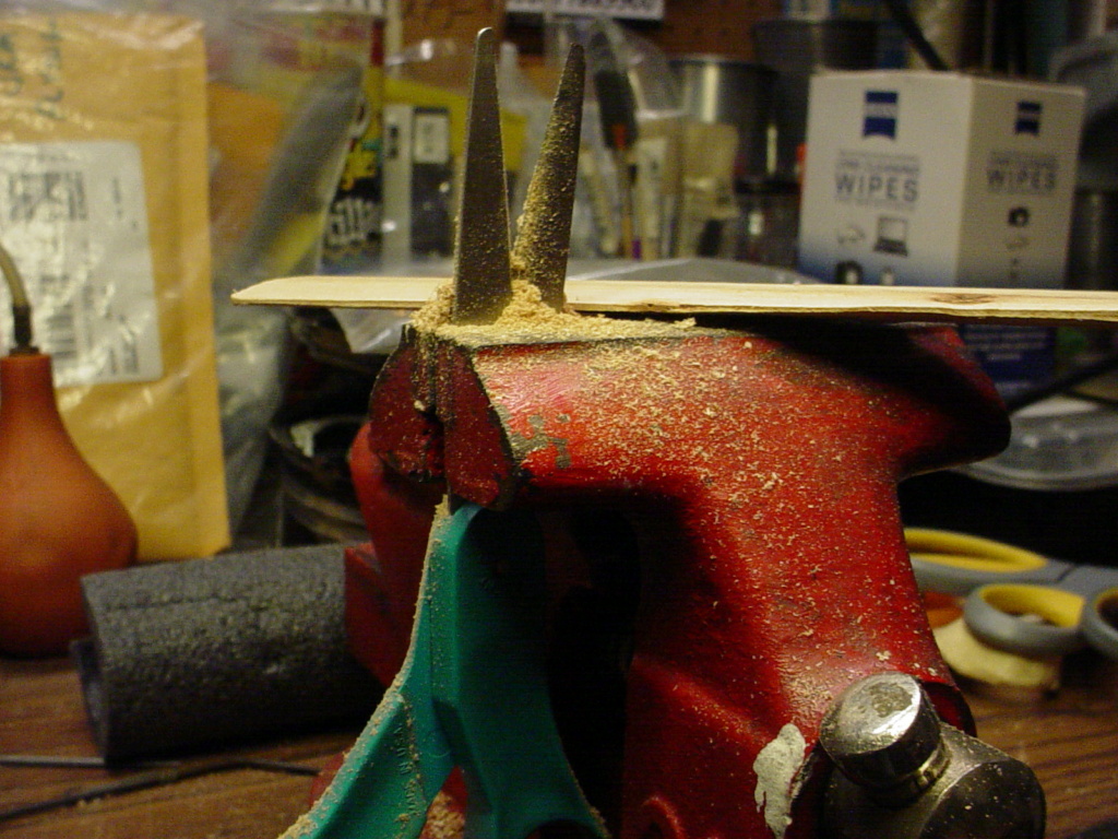

I just did some sanding to the nose.. to even-out the doubler over-lap top/bottom.. then the engine-mount blocks. I used a 1/4-sheet electric palm-sander with 180 grit abrasive paper.
Got the modeling bug this past weekend - Page 3 Tbd1-e16
The 180 grit paper smoothed-out the epoxy leakage in short-order.
Got the modeling bug this past weekend - Page 3 Tbd1-e17
Excess CA glue is a bit tougher.. but the sanding overall, went quite quickly.
Got the modeling bug this past weekend - Page 3 Tbd1-e18
The tail-moment is going to be cut-back WAY shorter.. and the wing-slot will be moved forward; so that the existing-length 1/64" ply nose-doublers will extend all the way back to the wing's trailing-edge. I'll need to revise my drawing.

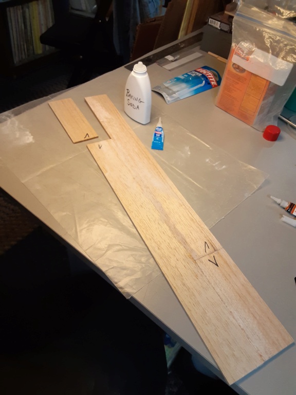

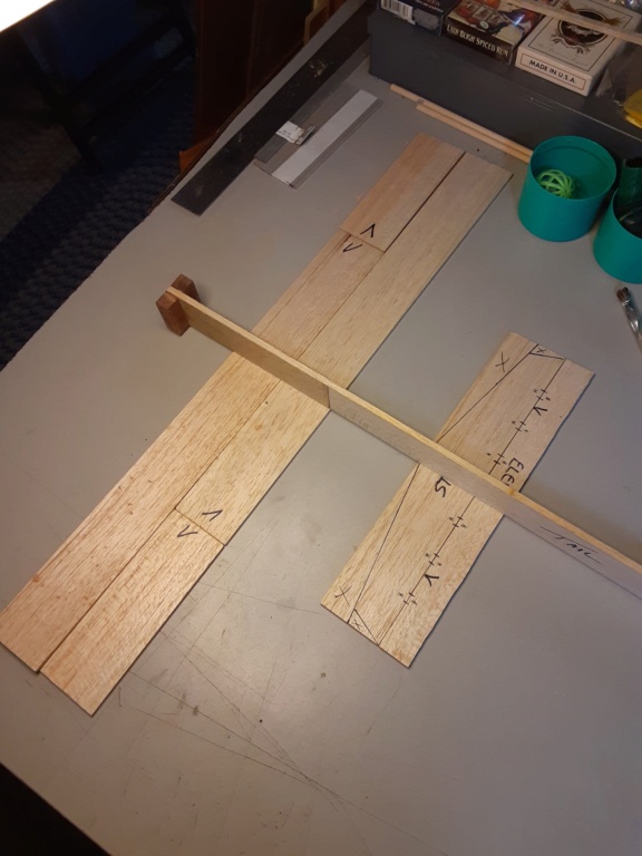

Tonight I decided to put my slab-wing together... and met with some resistance while attempting to butt-together the panels with gel-type CA glue. It should be noted.. that I buy the cheapest CA that I can find; in true control-line modeler fashion... Laughing
more about that later............ I made sure that I had air-circulation via a box-fan "on" during CA application.
The "gel" CA wasn't kickin'.. (joints failing) influencing me to spread "thin" CA over the joints.
... so now I'm spreading thin CA.. over the butt-joints. Pulling the wax-paper "over" the wet-joint.. and "smoothing-out" the thin CA seems to be working. I have my puffer though.. (where's the puffer emoji?) and I "puff" baking soda over the glued area. It's already smooth from the wax-paper. A light dusting/sanding takes care of it in short-order.
It works.. and it sets hard.. once it sets. Segmented slab-wings are less-prone to warping.

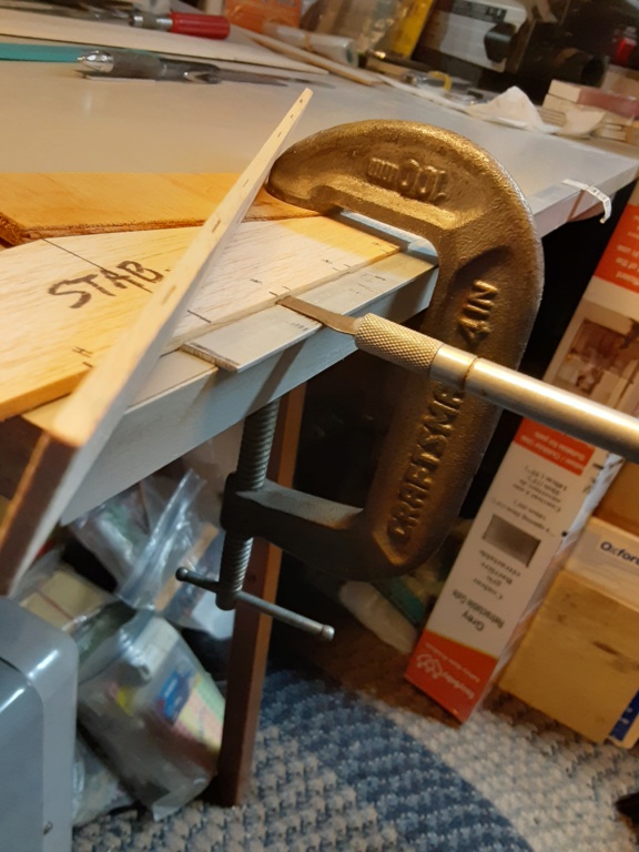

OK.. now I've got my slab-wing "blank"................... and now I need to cut the wing-tip profiles.

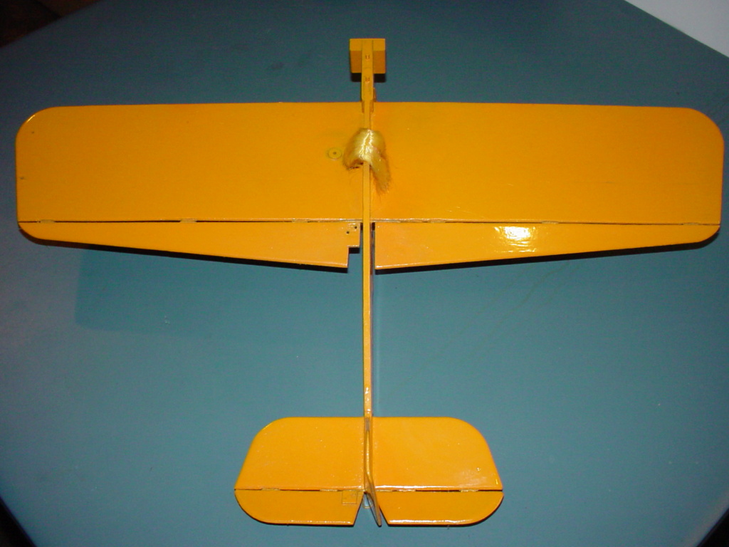

Hi Gary, Regarding segmented slab-wing construction; many of my designs feature root wing-chords of at least 4 inches/100mm. I generally purchased my sheet balsa in maximum widths of 3"/75mm.. requiring the addition of wood to arrive at the design-chord of my wings. I could have sourced wider sheet-wood.. but I didn't very often.
I've also made several "flat-framed" (open frame) sheet-wings that I've covered using iron-on film. See this thread; Flat-Framed construction
My theory is; that contrasting wood-grains in opposing butt-joints can help to prevent warping. The contrasting grain-directions in my flat-framed wings take this theory to a higher level.. but those wings take much more time to build.
I have also used harder-wood "strip-spars" in my balsa sheet-wings. My F8F-2 has a strip of 1/8" X 3/4" X 8" dark-wood (might be walnut) which I positioned on-center, near the leading-edge.. for the purpose of supporting the main gear-strut blocks (X2) at 6" apart. Not something I would do, if just using balsa only. I wasn't concerned with the added weight of that spar.. because the model was built purely for roundy-round operation. (The 1st CEF Reed-Speed contest) My F8F-2 wing is actually made-up of X8 segments.

Too cold to go out..   Cold  Cold  so I'm working on my airplane.. Very Happy ... and my sinuses are clear from that CA allergy episode last Thursday night..  Rolling Eyes
So I start cutting the contours for my stab's. leading-edge and my wingtips.

Here's a hinge-slotting method that I've posted about on previous builds, which will use Sig-brand "CA" type hinges.
After laying-out the locations, I use a #17 X-Acto "chisel" blade and a piece of flat-stock "half the thickness" of my balsa, which "centers" the blade. I then push the blade into the wood with a firm rocking/side-to-side motion.. whilst keeping downward-pressure on the flat-stock. A large "C-clamp" and block of hardwood for a fence to keep my work-piece from sliding back.

I then use a type of knife-sharpener to form a taper on the hinge-lines of both pieces.. and all the way around the wing also.
Photos below are from a previous (P-38) build.. but will show the process.
Got the modeling bug this past weekend - Page 3 Taper_10
Got the modeling bug this past weekend - Page 3 Dsc05113
Got the modeling bug this past weekend - Page 3 Dsc05221
Got the modeling bug this past weekend - Page 3 Dsc05222
This can also be done by locking scissor-blades in a vise to form the desired taper.. and then drawing (pulling) the work-piece "toward you" whilst keeping it vertical.
Got the modeling bug this past weekend - Page 3 Scisso10
Give it a try with a piece of scrap balsa.. and you'll see how easy it can be (with a little care and patience..) to form tapered leading/trailing-edges on your thin sheet-balsa.
