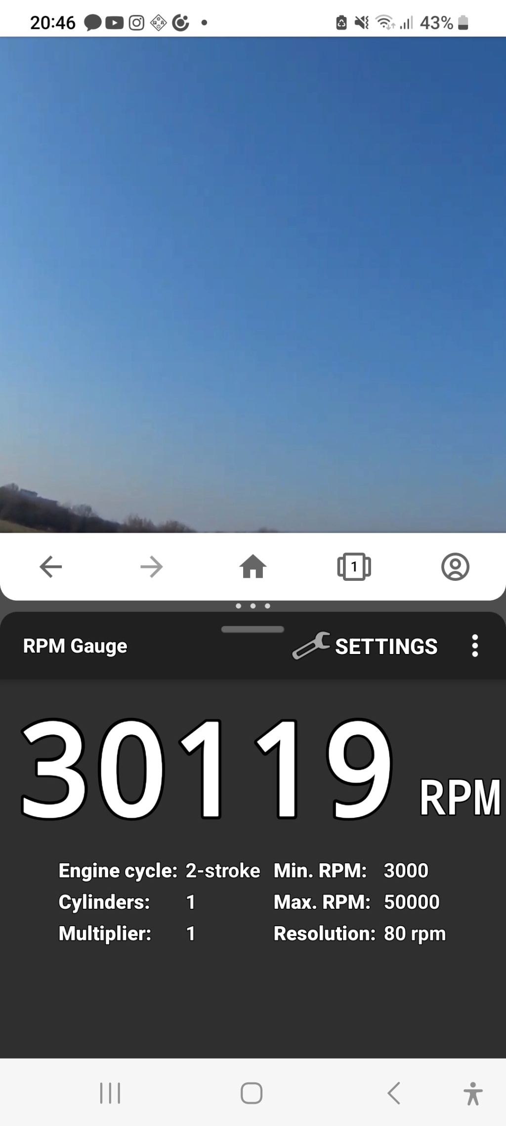

Thank you Robert! If kept clean and fed with carefully filtered fuel, the 010 TeeDee is one of the most dependable COX engines, that will scream at top rpm as long as the fuel lasts. Minutes or hours, just does not matter..This is my experience with these adorable critters.
Contrary to the usual concern that an engine so small is finnicky to start and tune, with 1 drop of prime in the ventury, another into the closed exhaust port, the starter spring kisses it alive at the first yank..
I filled about 10 ccm fuel into the balloon tank that was enough for a flight of about 5 minutes - so an unthrottled 010 consumes roughly 2ccm fuel per minute. I pulled my syringe on the filler tube after the plane landed, and found no residue fuel in the tank..
Do not expect anything less from your newer 010 with black nylon parts.. again, in my opinion the taper bore may enhance longevity, but 010-s with red and black carb body will invariably run near 27k for loooong loooong hours.
I have audiotached the engine, that unloaded near 30k:
I have several small RC planes built around 010 and 020 TeeDees and my concerns with a windy site are the least when I play with these smallest toys..I am more concerned with 09 powered planes if winds really blow...so the tiny Lil Spee Dee is really handy, as your Page Boy will be!

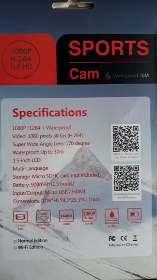

András, my camera is relatively cheap, it's Chinese-made, generic, but it still records acceptably, here I leave the specifications so you can see if it can be useful for you.
