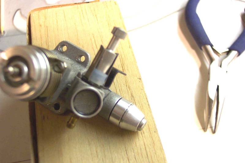

TD ABUSER wrote:
I would break the engine in with the 5 x 3 and then switch to the 6 x 3.
The needle tended to drift during the run. Some people used a short piece of fuel line to help clamp it in place..but I ended up using a few wraps of tie wire around the spring steel clips to secure the needle.
Norvel Big Mig C\L break in procedure? Needle10
I generally used a 6x3 for breakin just because I felt the added flywheel effect would keep the engine running long enough to loosen the top end of the cylinder.  Usually, I switched to a 5x3 or 5.5x3 after some run time.  I liked the 5x3 and 5.7x3 APC, but they were sometimes hard to find, so I usually cut a MA 6x3 down to 5.5" or 5" just the let the engine wind up.

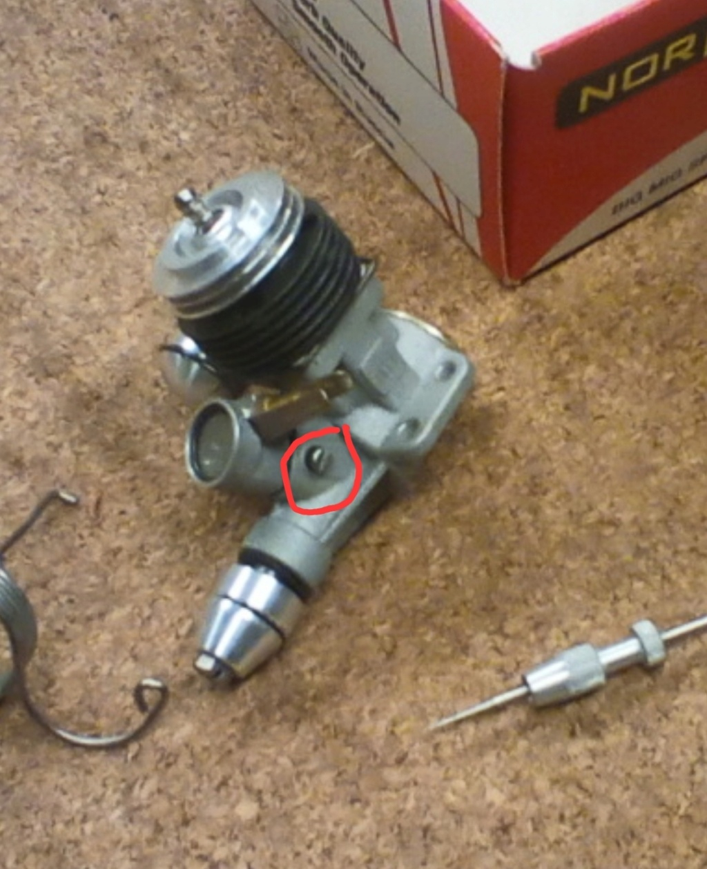

Michpatriot wrote:.............I noticed a funny thing, when running needled for top attainable rpm, resting a finger on the needle would gain a few hundred rpm, take your finger off and loose them rpm..but try to needle the rpm and it wouldn't maintain..so I alternated resting my finger on the needle and coaxed the rpm..then after a oz or so of fuel run this way the needle would then be allowed to get the rpm attained by holding a finger on the needle.............
Joel
If you're having to steady the needle, you may be getting some bleed air causing your mixture to vary slightly.  If you haven't already tried it, add fuel tubing over the end -- this will keep the needle from vibrating on the threads and block any bleed air.  Make sure it is long enough to press tightly against or slip over the barrel nut and slide over the needle body .  Some of the early NORVELs had tiny orings just inside of the knurled portion - these could be lost or cracked from age.
One thing I forgot (not unusual) was when you reassembled the carb, did you screw the barrel all the way in? You want to screw it in until it stops, then back it out just enough for the barrel hole to match up with the venturi and give full rotation.

Awesome work! Sounds like it's going to be a great power plant for you. I like how you run it in. Thumbs Up Nice. It's always awesome to see these engines start to come alive. They just get better and better.
One thing I noticed on my norvels was that there was an airleak at the venturi to crankcase bolt. I only discovered it by accident spilled some fuel and noticed bubles from that area when flipping the prop. You can check by putting a few drops of rubbing alcohol on the bolt and nut, flip look for bubbles and hissing. I covered that area with permitex grey and gained 2mins on a 1oz tank!!!!!! Went from about 3:45 to almost 6min flights. On my brodak 1/2a zero. Blew me away. Eyebrows
You can also make replacement orings, via a dowel and a scalpel. Slice the generic oring in half or so until it fits snug and you don't have to press down excessively to line the bolt holes up.
Norvel Big Mig C\L break in procedure? Screen17

Post  Michpatriot Sat Mar 04, 2023 5:07 pm
Awesome little tip! Thanks I'm gonna check it out! I did seal the needle with fuel line but that carb bolt is gonna get a dab of sealant so it won't leak later on..

Post  Ken Cook Sat Mar 04, 2023 6:49 pm
Usually, it's the o-ring under the carb that usually fails.  They squash out. This method can repair both issues. The earlier carbs were epoxied in. I still do this. I use JB weld and apply just enough on the top of the case and a little on the sides. If I need to remove it, I hit it with a heat gun. Any residual JB weld easily cleans off with rubbing alcohol. This is where installing the Cox 128 TPI spraybar into that carb works well. You can insert a piece of 5/32" tubing over the spraybar and solder it onto the spraybar, the entire assembly can be JB welded into that carb which works superior over the Norvel assembly.

Post  Ken Cook Sat Mar 04, 2023 8:02 pm
If your choice is to run this engine on bladder, I would remove the carb entirely. The 128 goes through the case at the bolt hole. I was able to press mine in using the knurls of the spraybar. There's so many variations of Norvel cases, it all depends on what you have. Some need tubing to size it down, some need to be drilled out a few thou. With your two hole spraybar, I would orientate it so that you can't see the holes looking down the throat. A single hole, I would point it right down the venturi the same angle as it's on the case. Mine is a single hole and it's right down the throat. My pic is a Cox 128, I cut them down to avoid vibrations wearing them out and damage. I then drill it for a piece of music wire which I solder in for the T handle.
Norvel Big Mig C\L break in procedure? Dscn3135
Norvel Big Mig C\L break in procedure? Dscn3136
