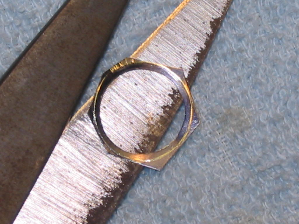

I have a punch set (inch and metric).
What I do is punch the hole size I need for the crankcase and with the outer diameter I punch it much larger.
Then, assemble the engine together.
After the engine is assembled together, using a "new" exacto blade, I carefully cut the extending "gasket" material even with the outside diameter of the crankcase.
I have tried to punch the gaskets exactly to the correct i.d. and o.d. but the gasket only being about at the most 1/8" wide from one diameter to the other never works out in my manual punch.
I do almost the same thing when I make up my cylinder shims for the SPI on the engines.

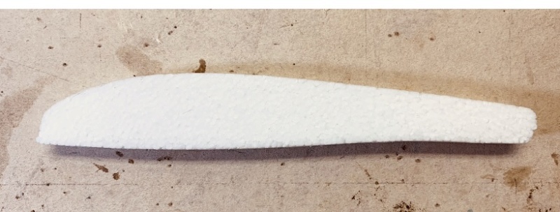

To do this experiment I bought a Guillow's Flying Eagle sailplane.  It cost me $19 dollars!?!?!  I just looked on amazon and they're selling for $38 dollars!!!!!!!
Thrust angle for a power pod? - Page 2 Guillows-gui2000fe6-flying-eagle-48-foam-glider
I took it to the park a couple of days ago to test fly it as a glider so I could see its glide and mark the c.g. on the bottom of the wing.  I cannot stress strongly enough how much I do NOT recommend this piece of garbage.  I was afraid that the wings would snap when a wind gust caught the plane as I was carrying it to the center of the field.  This has probably the worst injection molding that I've ever seen.
DO. NOT. BUY. ONE. OF. THESE!!!

Mark, I have seen a few use those, but they also did a few mods to strengthen things for the rigors of R/C flight, fiberglass tape or carbon fiber to strengthen the wing, etc. But with dollar store 3/16" (5 mm) paper reinforced foamboard and various construction insulation foamboard available, one is better off rolling their own, IMO.

I gave mine a couple of thin coats of spar varnish and it stiffened the foam wing considerably…. Kind of a stressed skin effect…. OK for a .020 size glider but a .049 would need spars and/or tape as well…

Quality of Ace R/C foam for wings was excellent for its time. By following their directions, one had a wing that was reasonably sturdy. This involved putting a layer of fiberglass strand tape along the bottom thickest part of the wing (near CG). Some also had a 1/4" strip of the trailing edge removed and a balsa trailing edge glued in place.
The glider Mark was referring to is a farily inexpensive foam chuck glider. It's foam isn't as dense as the Ace and as such is a little weaker. Yes, a very creative individual would be able to do a few things to make it work. But, there are other such gliders out there, which may be more suitable candidates.
I think it may have to do with the quality down to make them cheaper for sales, compared with the same gliders two decades ago. This is why I made the comment to roll one's own (maybe even an Ace Guppy with a K-flex wing) versus attempts to modify a "toy" glider. Razz
