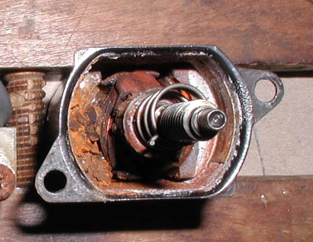

Then we tried the rusty electric window motor. Darned if it didn't work perfectly. Never thought that it would.

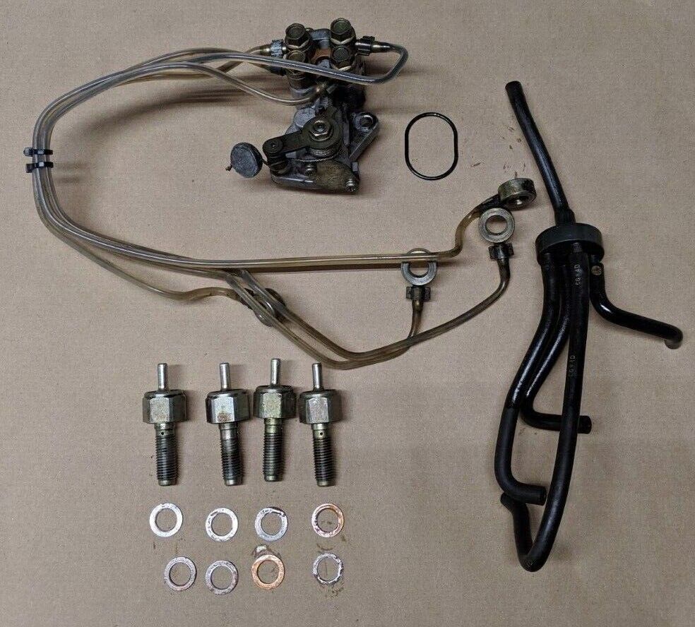

Four injectors two for each housing. Oil injected directly into each housing "cylinder" if you will. Pan oil pump lubes the moving parts separately. Injectors just to lube the apex seals.

Thanks Bob on the clarification. Separate injection would make sense. The droplets are larger and directed properly would better lubricate the seals. Whereas, in the fuel it would less likely land directly on the "cylinder" surfaces, be diluted and combust wih the gas, IMO.

Add...Story about that window motor. First we tried it with a remote battery, didn't work. I was about to remove the gear box cover when Mark plugged it into the cars socket and grounded the frame while I operated the switch. When it came to life, Mark who was holding the motor jumped an inch. Hit the other side of the rocker switch and it reversed. Smooth as silk. We were both surprised.

Oil injection, not new but unique and necessary to Wankels. I'm just learning about it. Under the intake manifold are four clear hard plastic tubes that I thought were emissions.
