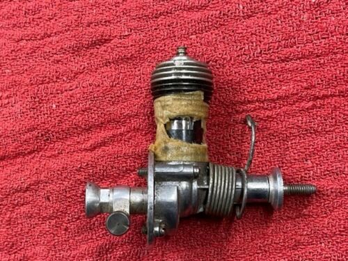

Ayer en E-Bay, vi un motor pobre y desnudo que necesitó apoyo y amor. Sad Lo fue un Cox .049 Thermal Hopper. ¿Qué iba a hacer? Huh... La oferta inicial fue $24.95 US. Entonces ofrecí esa, después lo aumenté más. Hoy, lo he ganado por eso con $6.45 envió y $2.53 impuestos ($33.93 total). Very Happy
Just yesterday in E-Bay I saw a poor and nekkid engine that needed help and love. Sad It was a Cox .049 Thermal Hopper. What was I to do? Huh... Starting bid was $24.95 US. Then I offered that, after increased it. Today, I won it with that with $6.45 shipping and $2.53 taxes ($33.93 total). Very Happy
Cox .049 Thermal Hopper - a never ending story 2023-084
Cox .049 Thermal Hopper - a never ending story 2023-023
Cox .049 Thermal Hopper - a never ending story 2023-024
Cox .049 Thermal Hopper - a never ending story 2023-085
lol!  This Site Rocks!  I Love This Forum!
Después miré a las fotos, descubrí el motor es un modelo antes año 1956. After examining the photos, I discovered the motor is a pre-1956 model.

Only speculating, but perhaps the masking tape was placed there with intentions of painting around some cowling. When it arrives, hopefully with a week, I'll be able to look at it more closely, plus clean it up. I thought it interesting how it has a 3 bolt mounting system for bulkhead use. Plus, it looks like that the slight extending of the 3-48? backplate screws have enough overhang for its special aluminum mount.

Nice haul George, congratulations, the lowest winning price I have ever seen for such a historical relic.
I think the masking tape was added by a careful owner to prevent any foreign material from entering and scratching the delicately fitted cylinder piston combo during an extended storage?
I guess the cylinder is the pre-57 design with the old style glow head sealing on its lowest fin shoulder unlike newer heads sealing on the combustion chamber rim?

Thanks, András, yes, I think your explanation may be closer to the truth as to the purpose of the masking tape, to keep the cylinder exhaust port sealed from dirt entering during storage. Thumbs Up
According to @Mark Boesen's illustration, the glow head has a raised ring around the head extension for the glow element pin. That is why I posted his photo on the 4th post above, from an earlier thread. According to Mark, this is a tipoff that it is the earlier pre-1956 (1955 and ealier) Thermal Hopper.
I don't know if someone makes a head adapter to use short standard glow plugs for this earlier version.

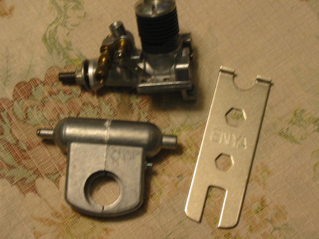

Yes, Allan has been sending me his Cox engines as I'm able to get replacement parts cheaper than he can.
So, I've been sending to Allan some of my rebuilt Enya .049/.06/.08 and .10 engines as a trade.
The Enya .049-II Series #4
Cox .049 Thermal Hopper - a never ending story Enya_211
The Enya .06-II Series #4
Cox .049 Thermal Hopper - a never ending story Enya_212
The Enya .08 Series #4
Cox .049 Thermal Hopper - a never ending story Enya_213
The Enya .10 Series #4
Cox .049 Thermal Hopper - a never ending story Enya_214

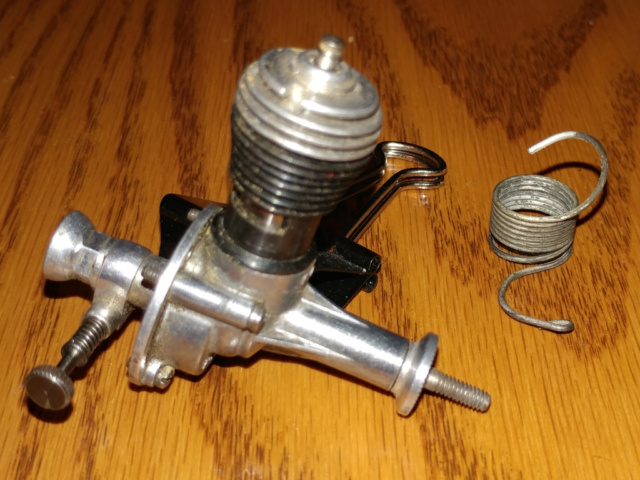

Now I have this little jewel of an engine in my possession. The mummified paper masking tape covering the cylinder exhaust ports came off with very little prying. The adhesive glue had long since dried out. I removed the snap spring starter to remove the remaining masking tape. Now King Tut is exposed in all its glory. The four 2-56 screws holding the backplate in place show no signs of wrenching. The 3 bulkhead mount plate screw holes in the aluminum backplate show no sign of ever being mounted.
Cox .049 Thermal Hopper - a never ending story 2023-088
Just twisting the prop thrust plate, it feels it has the same compression as my .051 Tee Dee. Moving it quickly through compression in a snap like manner makes a chirping sound from the reed valve. Interesting, the piston does not have SPI. The glow head still had on each notch for the wrench tangs, a small chunk of swarf that had not been knocked loose yet from the broaching to cut the notches.
Cox .049 Thermal Hopper - a never ending story 2023-089
The rear venturi screen is intact and clean. This engine apparently has very little use if any. The 5-40 prop shaft is missing the prop nut, but I can use a Cox spinner nut to secure a prop in place, then cover it with a spinner.
I basically have not a worn out battle hardened relic, but an NOS 1955 or earlier Thermal Hopper. It looks like I really scored big! Very Happy
