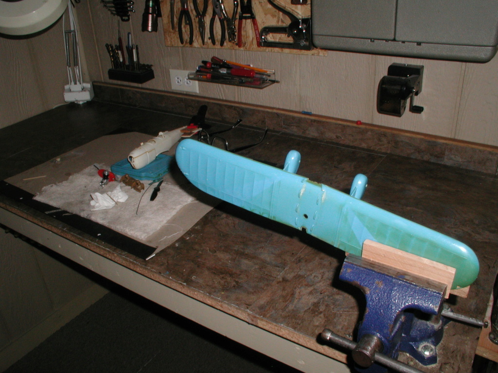

I have tried to find one of those circular wire springs and throttle sleeve for the Ryan but no luck, still looking.  It would be nice to take advantage of the speed control handle that Kim sent me.  Got most of the wrinkles in the tail section worked out but still a work in progress.  Ryan will be in traction for awhile.

Went to Walmart this morning looking for paint.  Can't find an exact match.  Thinking the gloss light blue.  Nothing is removing the stains, so paint it is.

Post  akjgardner Tue Apr 25, 2023 9:24 am
I was wondering how you were going to fix the wavy parts . Did you heat them and then clamp them ?

Post  rsv1cox Tue Apr 25, 2023 9:35 am
akjgardner wrote:I was wondering how you were going to fix the wavy parts . Did you heat them and then clamp them ?
I heat the wood with a heat gun and clamp on both sides while hot.  Heating the plastic can be disastrous.  Might take several times but patience pays.  Heat cool, heat cool.  Never, ever going to be like new though.

Post  akjgardner Tue Apr 25, 2023 9:38 am
. That’s a good trick , I’ll have to remember that one

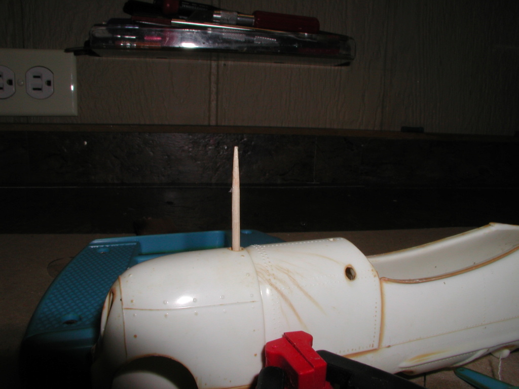

A little more progress.
It's nice to have stuff........ P1015311
SOP for me now, pass a pin through the NVA removing all the castor/corrosion goo followed by aerosol Remoil spray and a compressed air blowout.  Aerosol straw and plastic cement replaces the broken nipple.  Flushed out the tank with 91% and blew dry with compressed air.  Straw a very tight friction fit backed up with the cement.
It's nice to have stuff........ P1015312
It's nice to have stuff........ P1015310
It's nice to have stuff........ P1015313
It's nice to have stuff........ P1015315
It's nice to have stuff........ P1015314
It's nice to have stuff........ P1015317
Little guys took a Berryman's swim.  Did a great job cleaning off all the dirt/castor but also removed most of the paint.  Might farm them out to one of the kids for a repaint.  Might not.

Post  rdw777 Wed Apr 26, 2023 3:27 pm
Looking really good Bob!..,I wouldn’t know where to start on plastics rehab…. The tank nipple repair looks good Thumbs Up …. Berryman’s did a good job cleaning as well…Did you ever notice if the prop was left hand?…. It looked like it from the photos…. Just curious because of the recent discussion on LH props on PT-19’s
Posts : 768
It's nice to have stuff........ Empty Re: It's nice to have stuff........
Post  rsv1cox Wed Apr 26, 2023 6:37 pm
rdw777 wrote:Looking really good Bob!..,I wouldn’t know where to start on plastics rehab…. The tank nipple repair looks good Thumbs Up …. Berryman’s did a good job cleaning as well…Did you ever notice if the prop was left hand?…. It looked like it from the photos…. Just curious because of the recent discussion on LH props on PT-19’s
Yes, LH prop with a backwards curve easily cured.  Heat, weight and wait.   I might be able to save it afterall.
