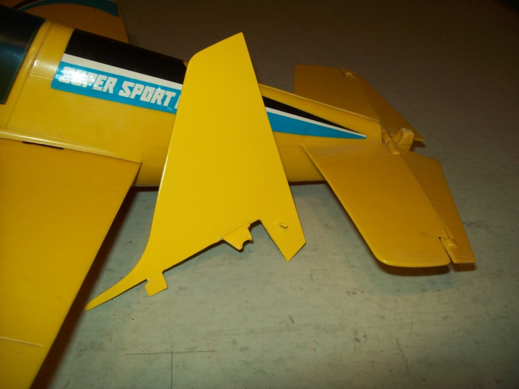

The Super Sport II was the last re-issue of the Super Sport trainer, molded in yellow. I picked this one up last week. The canopy is cracked, and it was missing the vertical tail. This served to lower the price to a point I was willing to take a chance on it.
Cox Super Sport II 100_4410
It didn't take long to encounter the first issue as I sat down, screwdriver in hand, to take it apart for cleaning. What the heck - no screws anywhere?? Fortunately, the manual is available here. I discovered the landing gear is the key that holds the whole thing together. Once that popped loose, it fell apart in my lap. Everything was in good shape inside. The engine was free, and the cleanest I've seen. Not even any gunk around the reed. I don't think it has ever been run.
I tried to remove the canopy, to see what could be done about the crack, only to discover it had been glued in place. I decided to let sleeping dogs lie, and moved on to the fin. I found photos online, and drew one up as close as I could. Traced it on 1/16 ply and cut it out.
Cox Super Sport II 100_4312
The hardest part was capturing the elevator hinge, and making the fin removable, but I got it. Taking every possible shortcut, I skipped covering altogether, just sanded and sprayed with rustoleum.
Cox Super Sport II 100_4411
It came out pretty well.
Cox Super Sport II 100_4313
Cox Super Sport II 100_4314
Whether or not it will fly is another question entirely. This is the porkiest Cox plane I have seen, at a staggering 15 ounces. I plan to take it to the SIRS club Vintage Model Aviation day, where we will find out.

Andras, can I trouble you to post pictures showing the rudder size and amount of offset? It would be easy enough to score and crack the fin to replicate the offset.
As for engine offset, I noticed that this is already done by the factory. If you look closely from the top, you can see it.

Sure, here is the stock rudder angle...the rudder width is about 17mm, the angle is
about 16°
Cox Super Sport II 16829610

Duane! Nice work on the vertical stab./fin. Thumbs Up My Two Cents .... leave the vert. stab./fin where it is.. (without any offset) and test-fly on a "short-tank".

Andras, thanks for the information. With that, I can replicate the stock configuration.
Kim, I would like to go to SMALL, but Plumerville is a solid 8 hours from Bloomington.
Roddie, I know the current thinking in CL is to not use rudder offset, Ken Cook has told us this many times. Still, it was used by Cox, so they must have had a reason.
I see Ken posted while I was writing this. Thanks for weighing in, Ken. Fortunately, the wings on this one are straight. The left stab tip was drooped, but with a little heat and pressure, it straightened up. I want to fly it, if only to satisfy my own curiosity. If it gets damaged, that's OK with me.
