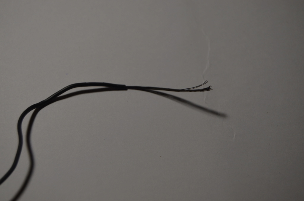

Any of you all that were flying R/C back in the 1980's/90's might remember a problem that swept through a lot of equipment from that era.
"Black Wire Disease" caused wire leads---that should have had a bright "new penny" color--to turn black and brittle. It usually happened with the negative lead, so along with the color it turned gave it the name.
I never did hear what actually caused it...the whole thing just sort of went away.
So, tonight, I took a trip back in time while working on one of my old transmitters. I decided to splice in an alkaline battery box in an old Airtronics transmitter... only to discover the negative lead was black and brittle...making me have to go upstream and change it at the card.
All is well now, and I didn't even burn myself with the soldering iron.

I think certain insulation types were involved. I guess it's different than electrolyte leakage or using acid flux to solder, but similar results.

Common and inexpensive insulation for wire is poly vinyl chloride, PVC. Depending on the quality of the PVC used it is possible that it degrades over time to release chlorine gas or a chlorine compound. That would attack the copper wire as well as any tin plating on the wire.

aeroland is correct.
It was that really cheap PVC type of insulation that caused the "black wire" syndrome.
It never happened on silicon insulated wire or any other wire that was not using the PVC (stiff) insulation.
Wonder what would have happened if they used the aluminum wire with the PVC insulation?
Probably the cheapest wire you could buy then?

Not sure if its a insulation material issue
Its a verry common issue with older electronics.
Many of my older (but still working) reciever battery packs are on there second or even third cable.
Even the wire on the side of the switch is affected if kept connected.
Since the polarety of the battery has influence even without a current (or so small we can't measure) its more likely some form of galvanic corrosion.
If the chemistry of the insulation was the defining factor then the polarety should not make a diference and it should then also happen with wires not connected to a voltage source.
I also has this issue with nicad flight packs that use thicker silecone insulated high strand count copper wire.
So far it has not happed with lipo packs but thats likely becouse of the relative short lifspan of those packs.
Simplest way of dealing with this issue is to assume battery leads are a limited lifetime item.

I've had the same issue with older NiCad packs. I usually changed out the leads at the end of the flying season by stripping the wiring back until it was again bright. However, I was never comfortable with the replacement since I did not know if it migrated down both ends of the wire.
Since it seemed to be associated primarily with the negative wire, I suspect it was due to electrolysis induced corrosion.
