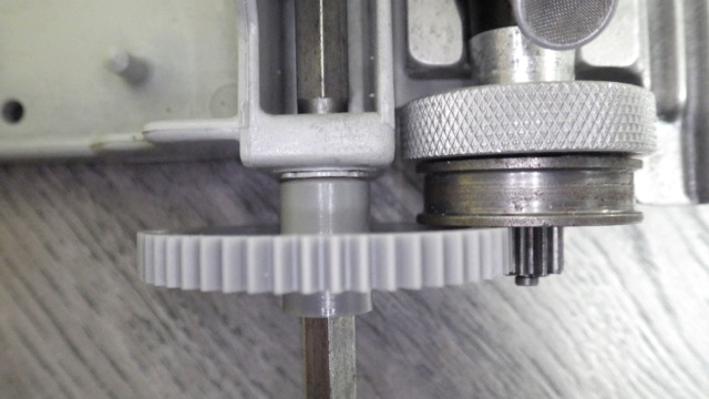

The last few days, I studied the above picture to find out how many teeth there are on the pinion.
I found an engine for my Jerobee  Screen18
I can see 5 teeth but how many are there hidden? 3 or 5? I suppose 3. That makes it the standard engine #501(if unmodified) with the 8T pinion. This would match with the tank.
The engine with the heat sink tank - the one with the holes - has a 10 teeth pinion. This matches the 56T driven gear that is on the car.

I would say 8 also , that's weird how they matched the tank configuration and gearing . Pumpkin Do you have the gear needed ? Babe Bee .049

Eric, if it's a 8T pinion, I need a 58T driven gear, which means I will have to go out shopping

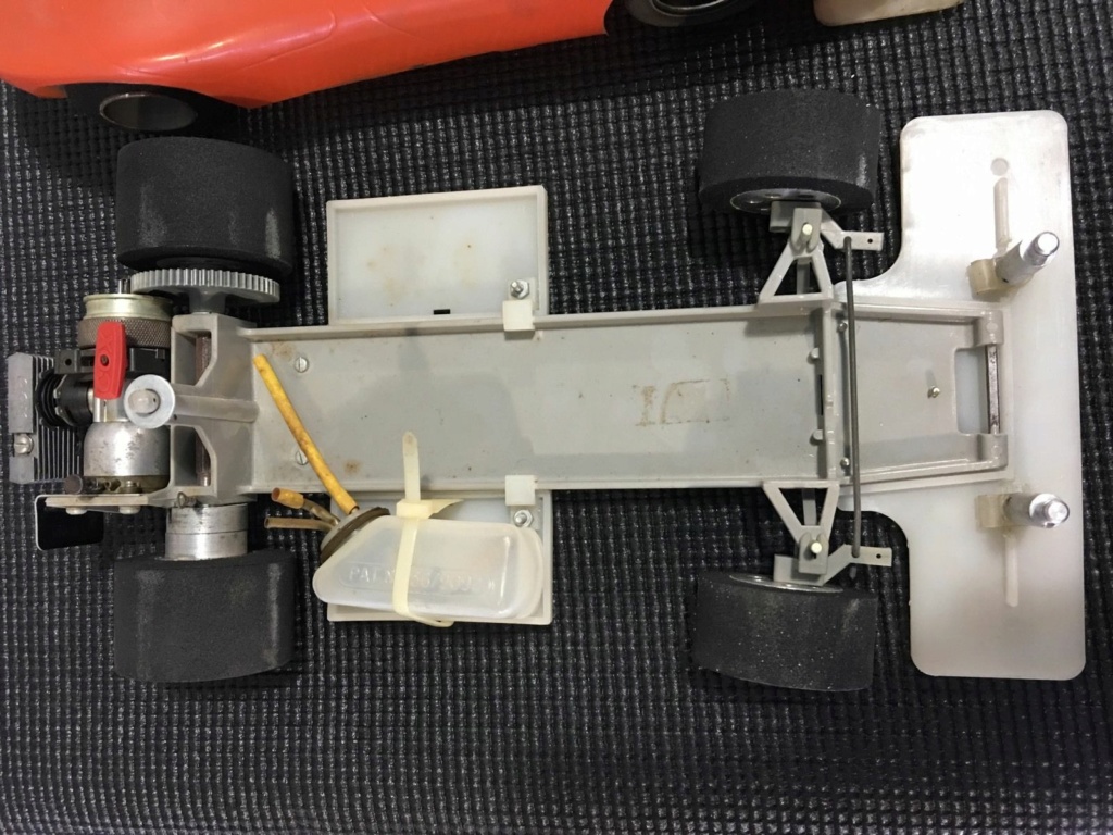

Hi Lieven! I've missed you!! I need to read your other thread detailing the chassis, to get caught-up with this build. These cars have always fascinated me!
Regarding e-clips that fly away; try working inside of a large clear plastic bag. If a clip "pops" before intended.. the bag will catch it... in most cases.
The photo below shows a similar engine.. and I thought it might help you to identify the gear ratio.
I found an engine for my Jerobee  S-l16015
I'm guessing that the "Tee Dee" version (as in your Porsche) has the same gear ratio as the #508 AJ engine??
This is a photo of your Porsche's driven-gear.. but it looks like it's marked "52" and it appears to be a smaller diameter gear.
I found an engine for my Jerobee  Imgp4410
I found an engine for my Jerobee  Imgp4510
Does the number of teeth on the driven-gear matter.. as long as they're all the same pitch as the pinion?

Roddie, that's a good tip for the e clips. The gears for the TeeDee and the souped up BabeBee are the same : 10/56. The entry models as there are the Bandero and Comando a gear ratio of 8/58. These 56 and 58 gears are the only ones used for Cox driven cars.
The 52T gear is for an electromotor drive and this was on the Porsche when I bought it. There is also a 55T gear and 54T gear. For electric cars, the gear is mounted on the opposite - right-- side of the car.
You can check this out in the brochure you can find in the manual section of the forum.
The gears differ in size so you need a pinion that matches for each gear.
