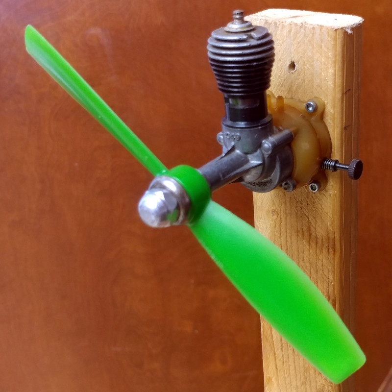

From my Facebook Page today:
"Ebay Strikes Again!!!"
"I threw a half-hearted bid at this beautiful Cox RR-1 .049, and was surprised to win it.
RR-1's are the prettiest of the Cox Engines (So Says Kim!), and were an early attempt by Cox Mfg. to create a hot-rod version of their sensational "Bee" line of engines...only to be upstaged by the REALLY Hot-Rod Tee Dee series.
Though they appear very similar to Baby Bees, their guts are different.  Cox replaced the familiar reed valve with a rotary valve, which complicated their manufacture (translation: More $$) and maintenance.  The rotary valve didn't provide a big enough increase in performance against this added expense.
RR-1's were STILL produced for a good while---from 1957 to 1965---so they're fairly rare, but not as much as some other shorter production runs.
This one's cylinder and needle valve are not period-correct, but I can always scrounge through the junk drawer, and put them right if I decide to keep the Engine Nerds from jumping on me.  A lot of them are already aggravated enough with me even running these little jewels.😁
Speaking of running...I put this on on a stand and cranked it up this morning.  Prop was a gray 5x3, fuel was 25% Sig.
It started easy enough, but would only take fuel for about a 30 second run.  It ran great, but only for half-a-minute.  I REALLY didn't want to take this dog apart, but a run that short wouldn't take a plane far enough to outrun a thrown rock.
So, a careful break-down revealed that its vent pipe (which ALSO serves as a stand / overflow pipe) had been cut short for some reason...probably some past Free Flight dude wanting to limit the run to prevent losing his plane.
A piece of tubing fixed it quick, a new tank gasket was added, and the RR-1 was back in the game...though I'm PROBABLY gonna have to take it apart AGAIN 🤪.  Its mixture adjustment goes a little wonky at about the half-tank mark...indicating that the gasket on the venturi tube is leaking, letting air in as the fuel level descends below it.
Oh man...a job for a different morning while riding a Folgers surge.😃"

Kim, glad to see that you diagnosed and fixed the cut short vent in the tank, and the need for a new venturi O-ring. You've got a prized engine there. Too bad they didn't make the R/C Bee with the rear rotary valve like they alluded to in the future engine announcements.
I remember the saying by the late Ken Willard, "If your successes exceeds the trials by one, then that's all that matters." Very Happy
Posts : 4938
More RR-1 Stuff...The OTHER Cylinder/Piston is Installed Empty Re: More RR-1 Stuff...The OTHER Cylinder/Piston is Installed
Post  getback Thu Nov 16, 2023 6:22 am
Good looking engine , that is crazy the PO cut the tube off short in stead of just measuring enough fuel to get the job done Turkey Got plans for it ? Leaves Very Happy

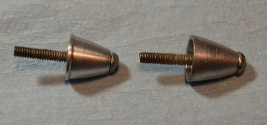

Post  Kim Thu Nov 16, 2023 8:38 am
So, it HAD to be done, and with the Folgers working its magic this morning, my newly acquired RR-1 .049 got pulled apart to receive a needed new gasket on its venturi tube.
While at it, I made up a small album showing the drive pin for the rotary valve in detail, and its relationship with the venturi tube.
I also brought in my "original stock" RR-1 for comparison, and it and its parts are on the right in the photos.  And, to answer a question, its cylinder is a dual port thin wall of the period...I THINK...so don't nerd-assault me if it's NOT how the original came equipped  Very Happy  Very Happy  Very Happy

Post  balogh Thu Nov 16, 2023 9:31 am
Hello Kim,
the genuine RR-1s came with the No1 thin wall cylinders that had tapered bore in them.
I have a Frankenstein RR-1 that sports a No1 cylinder with a P40 lettering stamped on it...a 2-bypass ported cylinder, most likely assigned to COX P40 planes (hence the stamping on the cylinder), and donated by the previous owner to the RR-1.
More RR-1 Stuff...The OTHER Cylinder/Piston is Installed Rr1_p410
I would compare its performance to the old stock Black Widow that had a somewhat wider venturi diameter, but still reed valve, whose efficiency is probably less than the rotary valve in the RR-1, so these 2 differences offset each other..
