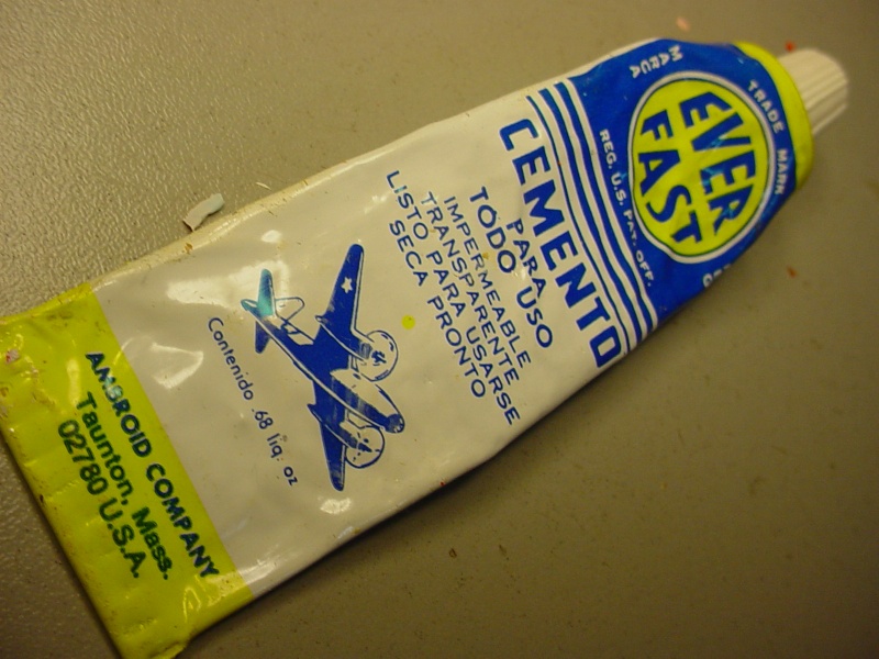

Ambroid has an interesting history.. and it wasn't originally formulated to be a model cement at all. It was used to repair the old canvas-type canoes!
Ambroid history
It used to be made in Taunton, Massachusetts.. about 25 mi. away from where I live. Apparently the company relocated North to the New Hampshire/Vermont area.. and sold-out to a Canadian Company.
Check out the tube of "Ever-Fast".. I remember buying half a dozen tubes for 25 cents/ea. at a railroad salvage outlet back in the 90's. I wonder if Jose' ever used it?
