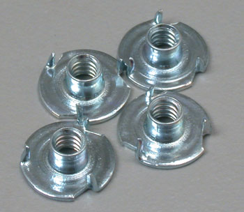

Disaster has struck, even before it's maiden!
I was running the engine up, to check the throttle settings, when it started to viabrate like mad, I stopped it VERY quickly and discovered that the engine mounting screws were pulling out of the firewall!
What is REALLY annoying is that I had my doubts about screwing the engine just to a 1/8" ply firewall when I was building it, and I intended to double-up on the thickness, then promptly forgot to do it!
So, quite extensive surgery is taking place on the nose, I've had to cut the top decking back to get at the back of the firewall, I could have stuck a piece on the outside, but that would have affected my carefully adjusted throttle linkage, so, out came the balsa knife!

Post  Ivanhoe Thu Jun 14, 2012 10:33 am
"Honker" build thread - Page 2 Surger10
Oh well, could be worse I suppose!
"Honker" build thread - Page 2 Surger11
You can see here where the top left screw pulled out, I'm just glad it didn't happen in flight!
"Honker" build thread - Page 2 Clampi10
Reinforcement going in, if I'd done that during the build I could have saved all this!

Post  andrew Thu Jun 14, 2012 12:33 pm
Wilf ---
That's a real shame. Were you using birch plywood or bass plywood or liteply? Birch is usually sufficiently strong, but I still always use sockethead screws and blind nuts.
Although you've already done surgery on your plane, here's a technique I use to retrofit or replace a blind nut that may have popped loose.
1) Drill the firewall so the shank of the blind nut fits snugly in the hole. If the shank is too long and would protrude, file it so it will be flush with the firewall when seated. If the firewall is thicker so the shank does not come all the way thru, I cut a donut from a piece of silicon fuel tubing and push into the hole -- when the engine is mounted, the tubing serves as a seal and keeps oil from penetrating the firewall.
2) Remove any obstructions between the firewall and first accessible bay in the fuselage.
3) Depending on your mounting screw size, insert a piece of all-thread rod from the front far enough in until you can thread on a blind nut. I usually epoxy my blind nuts in place, so adding a little petroleum jelly to the rod will keep the nut from sticking to the all-thread. Lather up the flange on the nut with your adhesive of choice and pull it up against the firewall using the rod. To ensure the nut is fully seated, I slide on a washer and nut from the front and tighten down until the shank is either flush with the firewall or the ears on the nut are seated. Generally I leave the rod in place until the epoxy has set. Unscrew the rod and you have a blind nut in a location that cannot be easily reached.
I also use this approach to fish fuel line from inside the tank compartment thru holes in the firewall if the tank or line needs to be replaced. Adding a tad bit of castor to the end of the line helps get it started thru the hole.

Post  Ivanhoe Thu Jun 14, 2012 1:00 pm
Thanks, Andrew, I prefer to use blind nuts but unfortunately I have difficulty buying them and suitable bolts in sizes small enough for Cox engines, all the suppliers over here seem to think no-one uses engines smaller than a .40 these days!
Hence my use of screws, I don't really trust them, but needs must!

Post  Ivanhoe Sat Jun 16, 2012 7:42 am
Repairs and alterations completed, the engine is now secured with blind nuts, (now that I have some!), I pushed the battery right forward, and the CG is now spot-on to the plan position, as seen here with the model in my incredibly high-tech CG setting jig!
