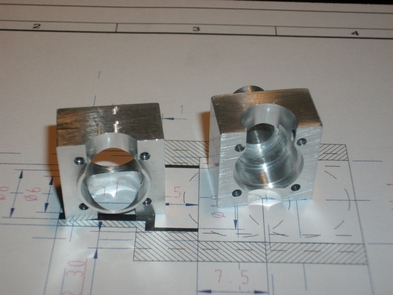

Post  chris74100 Tue Sep 04, 2012 2:55 pm
Today, i'm machining the crankcase.
my "twin bee" 00112
my "twin bee" 00312
my "twin bee" 00212

my "twin bee" Empty Re: my "twin bee"
Post  RknRusty Tue Sep 04, 2012 4:42 pm
Those are wonderful skills you posses, Chris. Thanks for sharing it with us.
